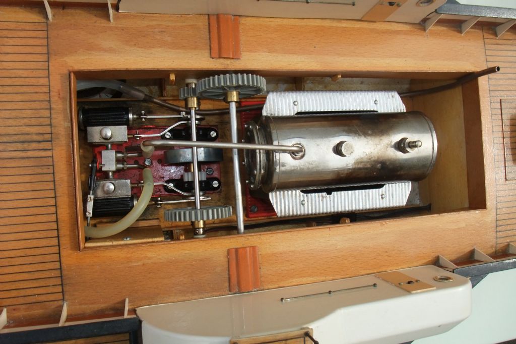

          Found this photograph of the Wilesco D48 steam plant when installed.
          Tony

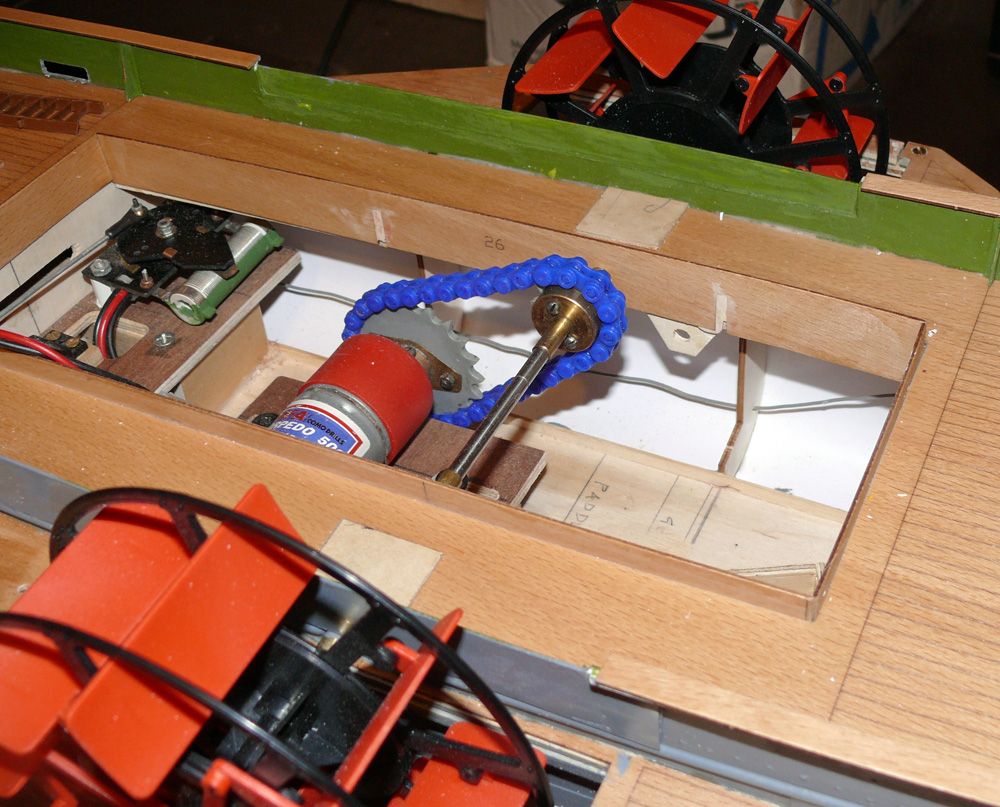

                            I`m using 50:1 reduction gearbox and a 3:1 plastic chain drive speed up to the paddleshaft
                            Not sailed for a few months………Too busy!
                            #44616
                              This is my layout…..The chain drive is 2 to 1 speed up……..For 6v

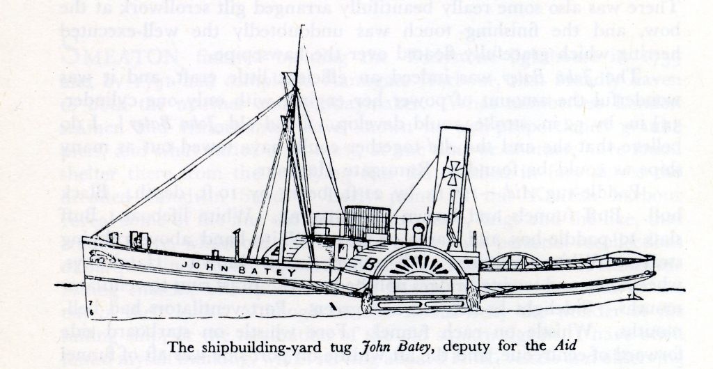

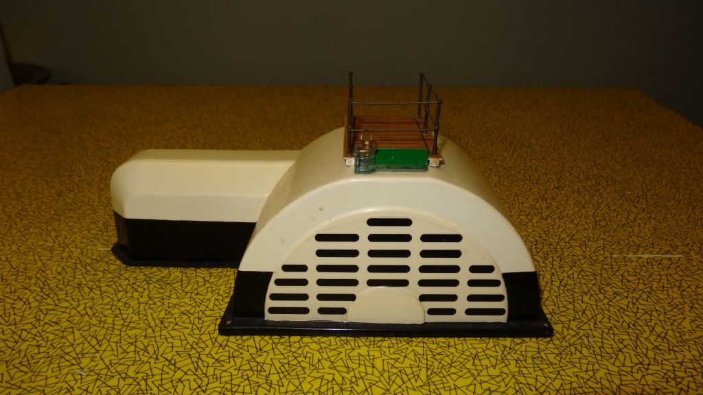

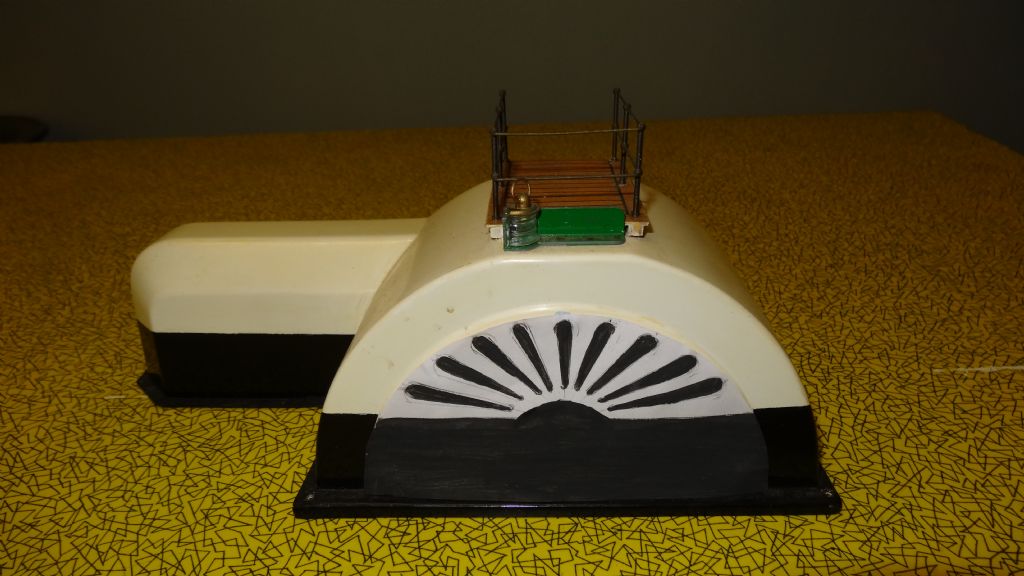

                                    Here is the next task for the build –
                                    The paddleboxes currently have the kit supplied transfers as paddlebox vents. I plan to drill and cut out actual vents. Whilst looking at this, I thought of modifying the design to a similar design to the ones on the Ramsgate paddle tug John Batey.
                                    What do you think of this design or should I stay with the original Graupner design? The photograph has a paper template of the proposed new design, before the mini-drill is set to work.
                                    Original Graupner design.
                                    Proposed design, similar to John Batey.
                                    Tony

                                      I think your proposed paddle box vents will look much more elegant than the existing design and your plans for independant drive sounds interesting too.
                                      Ian

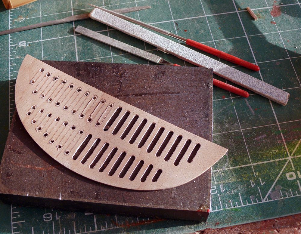

                                        Managed to modify the first paddle box to a design similar to the John Batey paddle tug. The paddle boxes are quite flimsy and cutting the vents is time consuming.
                                        Tony

                                          I did the same style of vents on my Glasgow…..I like your version, very much
                                          If you thought that was fiddly…..Try cutting out the rear decking!

                                              If starting from a new kit, I would probably cut the rear decking as your model, however as the rear deck is with printed slots is already glued in place, I would probably only make things worse by removing this section of deck.
                                              Must say, I liked both yours and Phil Button's design for the vents, (Phil Button's were in the magazine) and this is where I got the inspiration to cut them out, instead of leaving as transfers. Although Phil made brand new wooden paddle boxes which would be far sturdier (and better) than the Graupner kit supplied items.
                                              Tony

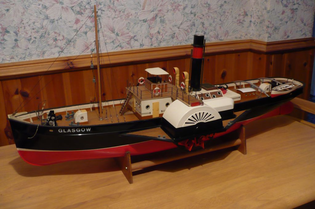

                                                I missed this Tony and have just compared both photos- before and after. It's surprising how much difference it makes- and a great improvement.
                                                Ian

                                                  Thank-you Ian, it is always re-assuring to have another pair of eyes look over a change from the original (kit manufacturers) design. Hopeful to finish the second paddle box either tonight or tomorrow night. Next steps are to make a motor stand and repair the rigging.
                                                  Tony

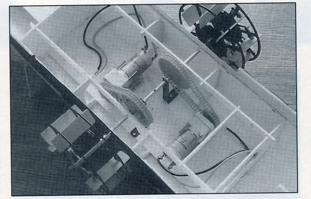

                                                    Since the last post, I came across this November/December 1991 RCBM magazine, on ebay, which has an excellent item on the Glasgow by Ray Brigden. The model in the magazine puts many Glasgows in the shade (mine included) and the magazine is well worth obtaining for anyone who is building, owns or wishes to own the paddler. Whether Graupner's new owners will re-release the kit in the future is anyones guess.
                                                    This photograph from the magazine item, is of the individual paddle wheel drive system which I will be looking to achieve in the future ( hopefully next winter). Ray uses meccano brackets to support the central shaft bearings. He does comment in the text that engineers will frown on the use of these brackets, but they do the job. For mine I will look for something better, but the idea looks right. The plan is to use a second MFA motor and make a similar conversion to plastic chain drive. Colin Bishop has commented in another thread about using gears within a 'sound box' (hull) and my thoughts are only to keep the existing Graupner 3:1 gear drive for the coming season. Bob has posted a similar, but single chain drive set-up earlier in the thread.

                                                      This looks just the job Tony and I suppose with any sort of mechanical drive you will get some noise. One of our club members uses this type of plastic chain drive in all sorts of amazing boats with great success. The last I saw was a rather splendid paddle shark!
                                                      All the best,
