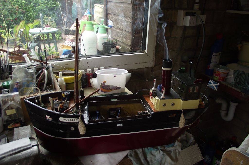

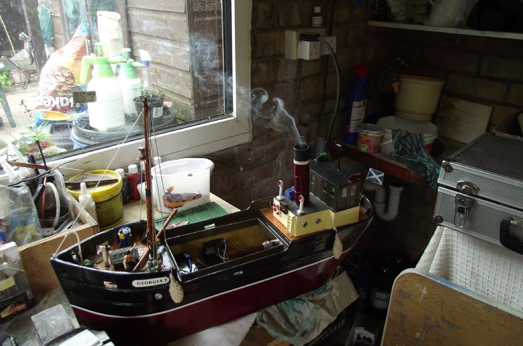

            dscf0018.jpgdscf0017.jpgthis is my puffer I built . I use incense cones they last about 20 min. i made a copper holder fitted to funnel which is waste pipe. as for smell people just laugh when I tell them.laugh
            david
            Edited By david taylor on 04/04/2019 12:37:58
            Edited By david taylor on 04/04/2019 12:40:28

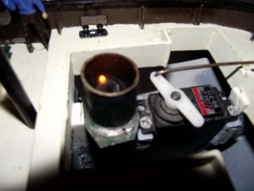

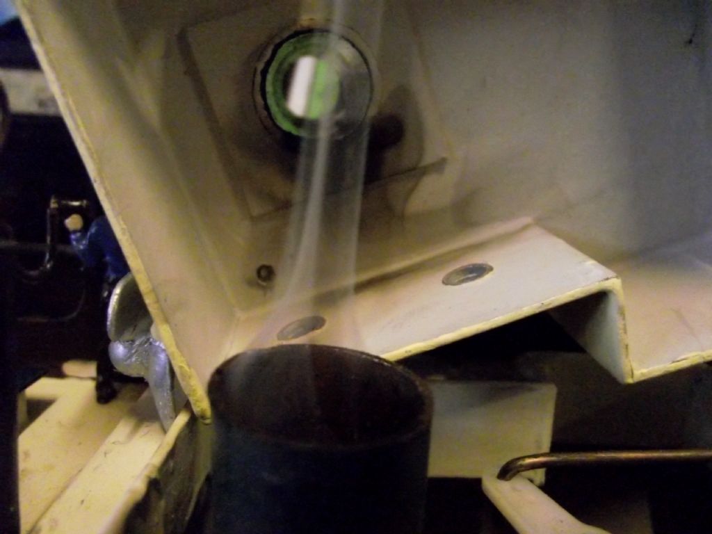

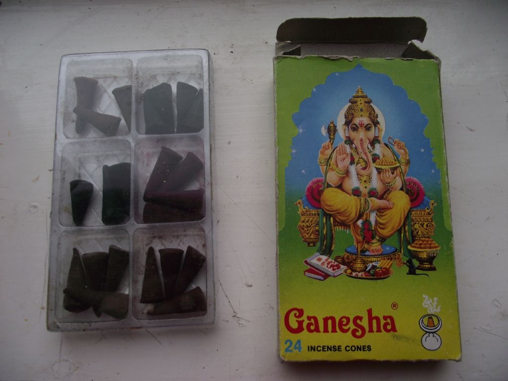

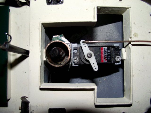

              I have found some more photos of how I made it.
              these are what I use.
              this is what I made from 15 mm cooper pipe soldered a flat piece on bottom holes in side
              this is how it lights, then just glows after flame dies down
              flame just goes up funnel and out stays cool on funnel
              hope this helps
              david
