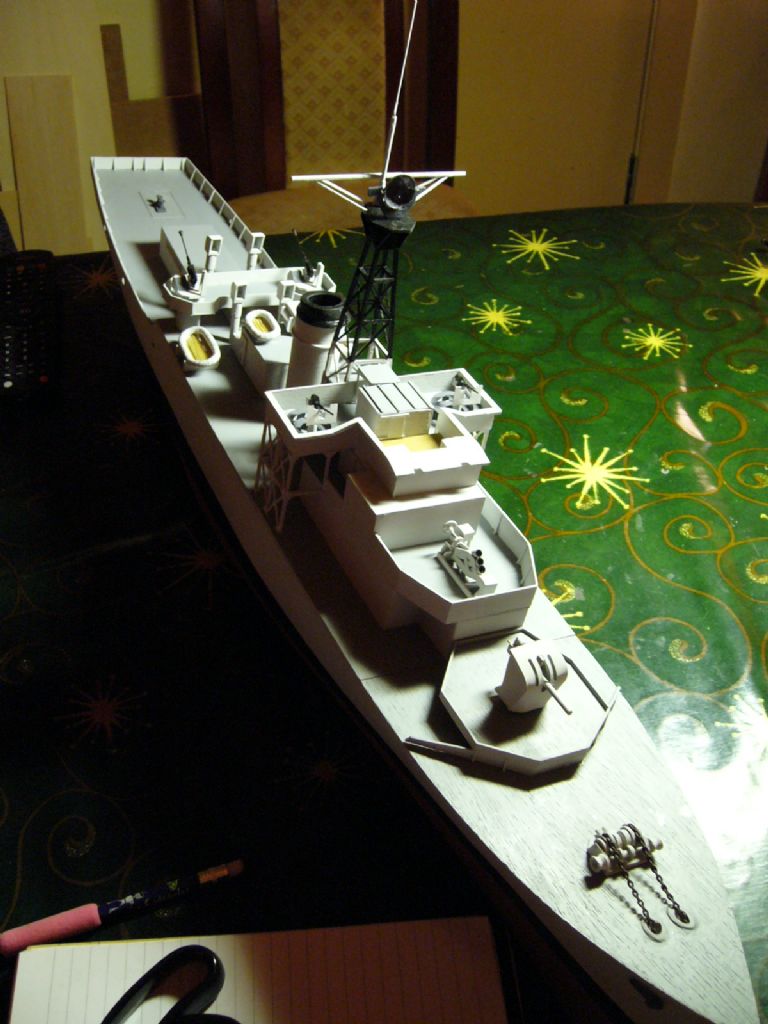

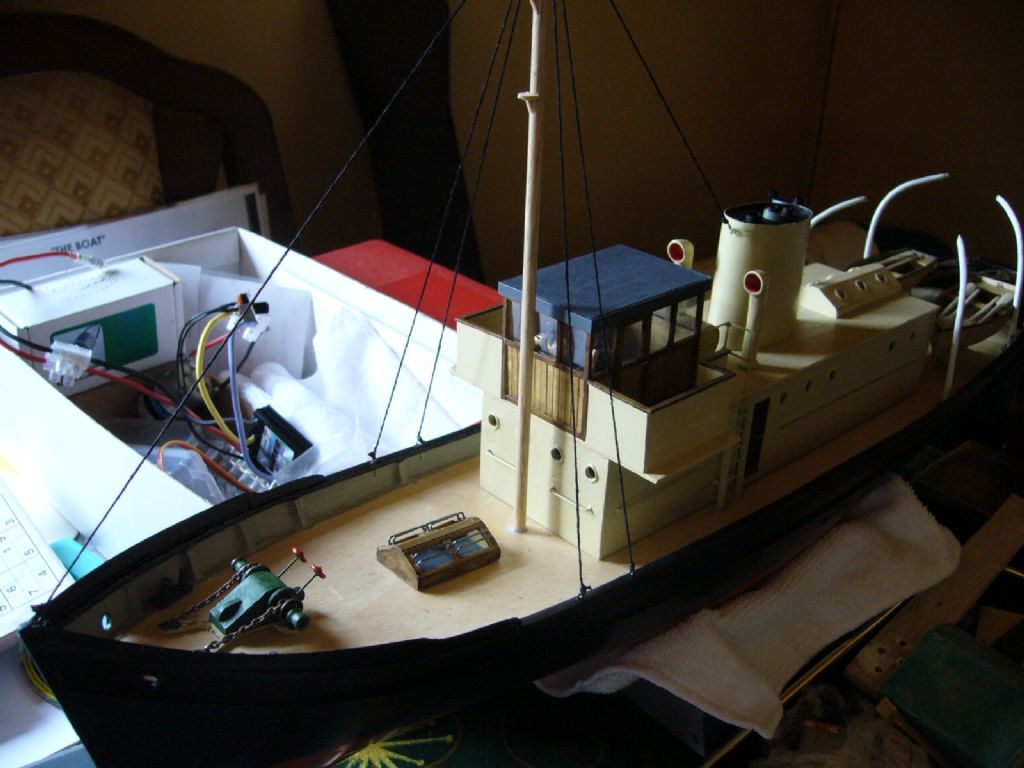

Boat number 2 was already forming itself in my head as I was building number 1. I wanted to build a warship this time but felt daunted by making the fittings involved. I liked the lines of the Castle class corvette and it was relatively lightly armed. Again, I found some plans on the internet, did as much research as I could, and ended up with a plank on frame hull of 31inches (just under 1/96 scale), powered by an Mtroniks Power 400 motor. Provision was made for it to carry 2x 6volt SLA batteries or an 8.4volt NiMH pack, driving a 40mm screw. At 6volts, the performance is probably close to the scale speed of 16.5 knots; 8.4 makes it look like a fleet destroyer; at 12 volts it would just about catch an Eboat!
Again, apart from the electrics and drive train, all is scratch-built. If it’s short on detail, that it is because it is very much a test bed for things that I have learned. I don’t see myself producing museum quality stuff (that’s a laugh!) just to have bits knocked off at the pond side or in transit.
This model has been on the water throughout 2017.

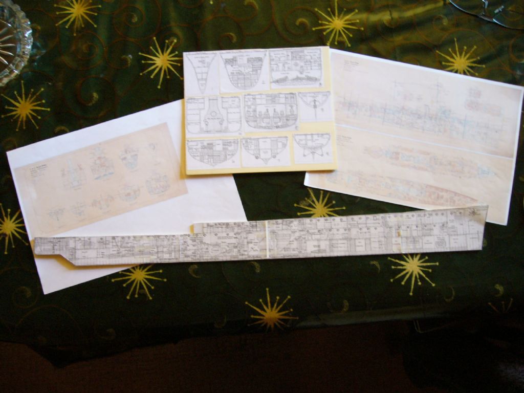

Having decided on a Black Swan, the obvious first steps were to amass as much pictorial and other material as possible and to procure plans. What a godsend is the internet for research (used with discernment). My stash of reference tools got off to a running start and continues to pile up as I rove through the ether.
Plans, however, are quite another subject. I am a Scot. It’s best to state that right away given our national reputation for thrift. My projects up till now have been based on downloaded freebies. Nothing was forthcoming for the Swan. I was going to have to pay!
It became clear that plans were available at some expense, but entirely disproportionate to the use I was going to make of them. I could pay as much or more for the plans than the model would cost at the end of the day. I was not building for a commission or for museum quality, but for my own satisfaction. I did not need copies of the builders’ original drawings (although I would love to have seen a set!).
Then I discovered that MMI had published drawings. My problem was that I did not strike right away. By the time I decided to put in an order Traplet had closed the doors of its shop.
Searches under “Images” for plans showed some held by the National Maritime Museum. I clicked on the images and copied them in to a Publisher document. I had side elevation and plan views as well as 9 sections, all of fairly poor definition (quite rightly so – they’re not going to let high quality images be pirated, are they?). All I had to do was to draw the missing sections and I could build a model!! It shouldn’t be too hard to fill in the blanks should it?

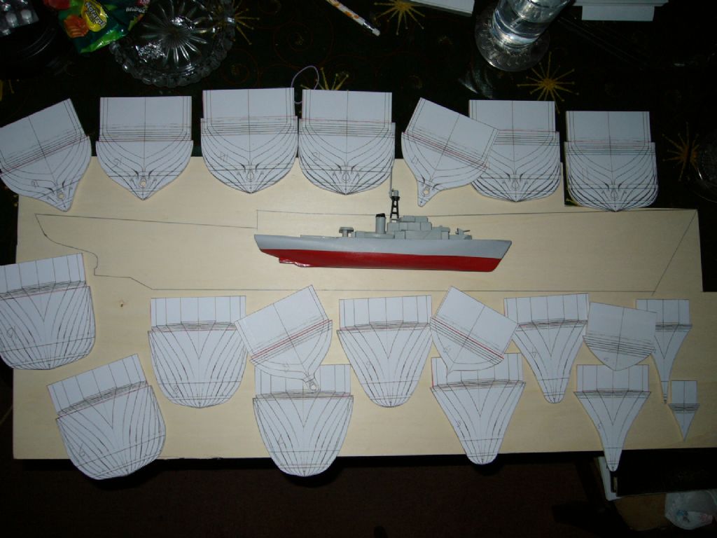

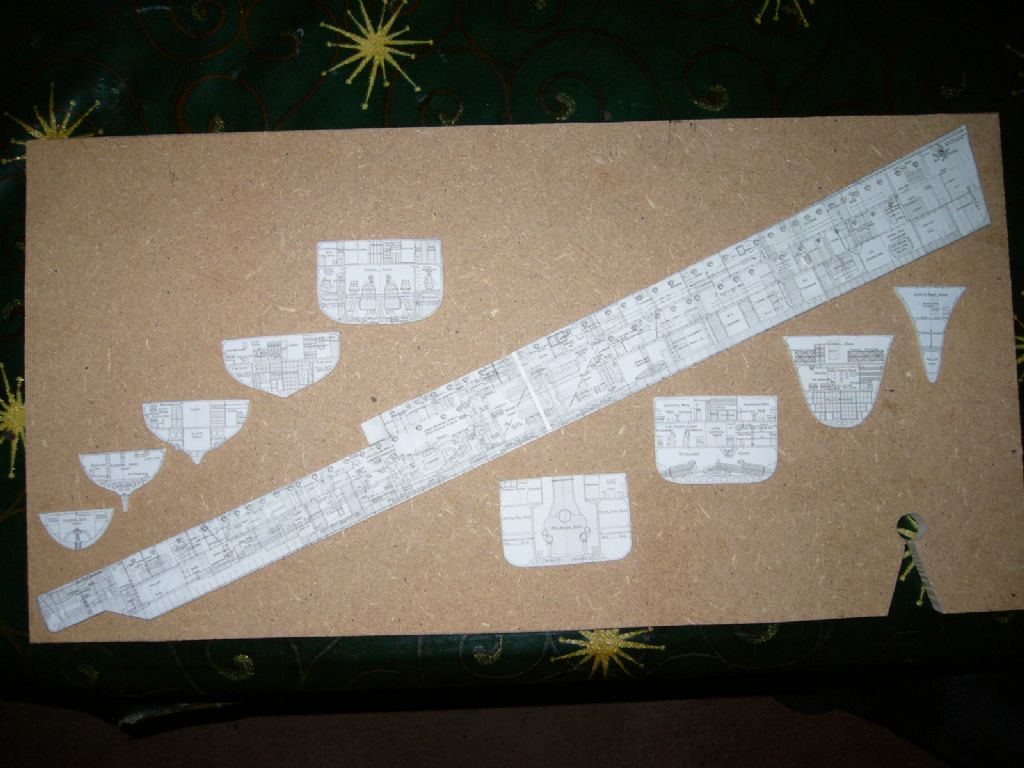

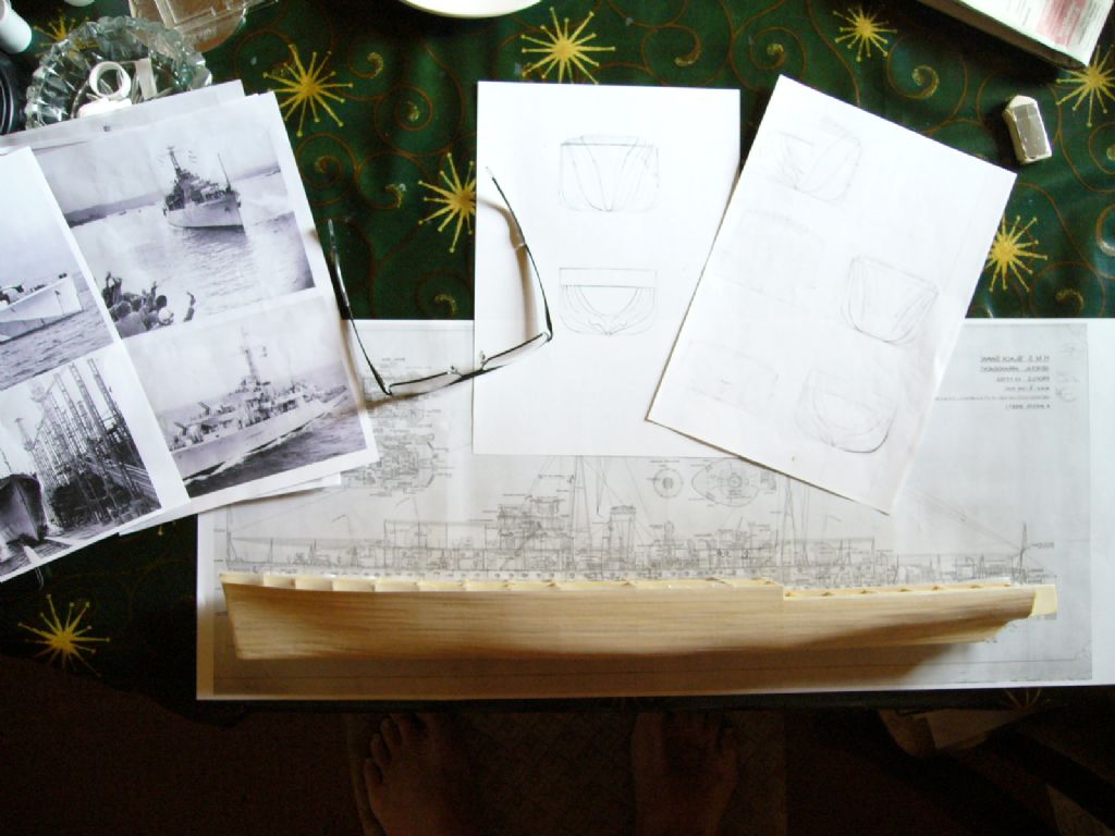

I upsized the elevation and plan views to the size I required (about the size of my current model) by creating a banner in Publisher (I do not have and cannot use CAD). Printed these off and measured the beam at each of the sections and upsized the sections accordingly. I then stuck the hull profile and frames to some poplar ply left over from the Corvette build.
I sharpened my pencil (metaphorically speaking since it is a mechanical one!) and set to with paper to draw the requisite frames, eventually ending up with this:
I hasten to state that this build was never intended to be more than a doodle on a fag packet is to an engineering draughtsman; its purpose was purely to test my abilities as a naval architect. Construction commenced:
(I thought that the ironing board cover would make a change from that dreadful tablecloth)
Edited By Peter Crow on 15/03/2018 21:17:11

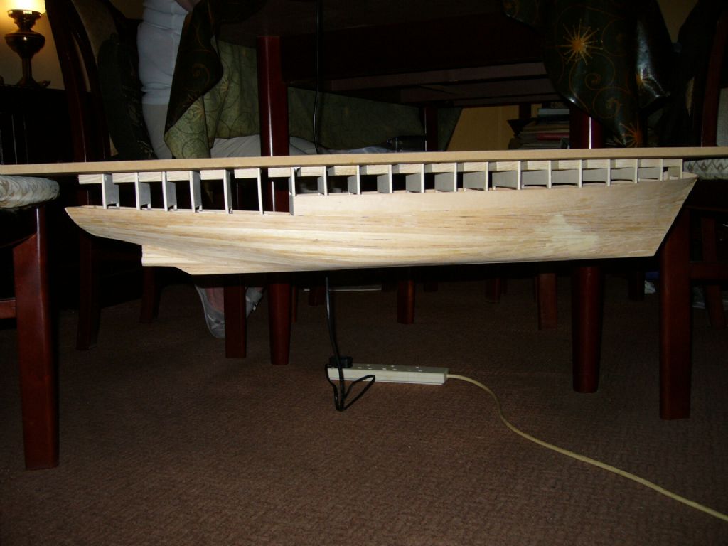

As the build progressed, it was becoming abundantly clear that any aspiration to ability as a naval architect was laughable but I decided to carry on. It would be interesting, having got this far, to complete it for use in flotation tests. The materials being used were only leftovers after all (there goes the Scotsman in me again!). So I clad the planking with fibreglass cloth and Eze-Kote.
No comments required from me; compared with the fruits of Mr Lambert’s labours, as pictured on page 1, you can spot the not so deliberate mistakes! No new Third Age career for me!
For academic interest, I weighed all the hardware that I intended to install and cut pieces of lead flashing to fit into the cells of the hull and spread as nearly as possible to the locations of the installed items. I pencilled on a waterline and plonked it into the bath. It floated dead on its marks, leaving no margin for decks, superstructure or fittings! I no longer have the hull, but I still have a bag containing the lead I used. It weighs in at 497 grams. My proper hull is a bit longer and very much fuller in the bilge so should be capable of a greater displacement. Francis and I aren’t so very far out from each other. There, I’ve got to the point at last! What do you mean that you can’t remember what the point was?

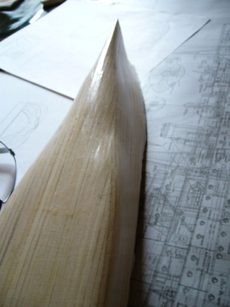

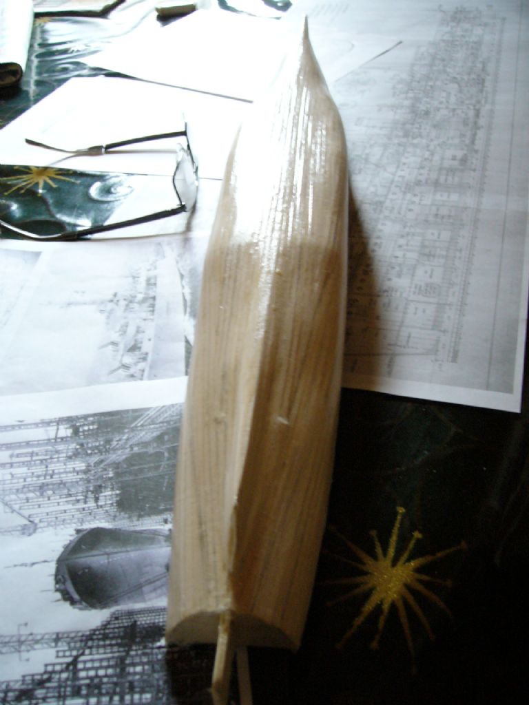

When I was a lad, balsa was the material that I grew up with. I can’t think how many packs of assorted off-cuts of strip, sheet and block. I seem to remember that at 1/6d or a couple of bob they fell within pocket money range (if I saved up my tanner a week!). Even then, however, I can remember being quite exasperated at some of its limitations but I didn’t know of any alternatives.
This time around I have latched on to basswood, or American lime as it is sometimes referred to. My first ever attempt at planking (in 2014) was on a small (A4 size plan) version of the hull that I used for RC boat number 1, (“The Boat”- so called because I never got around to naming it!). I used strips of balsa. Yuck! It fought me every step of the way.
I read about basswood, and discovered that there was a stand of it in Hobbycraft next to the balsa. I have used 1/32inch (0.793mm) basswood strip for planking since, “The Boat” covered with tissue and Eze Dope and the Castle with 1oz per sq yd glassfibre fabric and Eze-Coat acrylic resin. I like the predictability of basswood, its strength and flexibility. I also find that it carves well in block form. I am intending to use the Castle formula on the Black Swan. The Castle hull (at 31 inches) worked out as very light. I did weigh it at the time, but my wife can’t remember the figure!

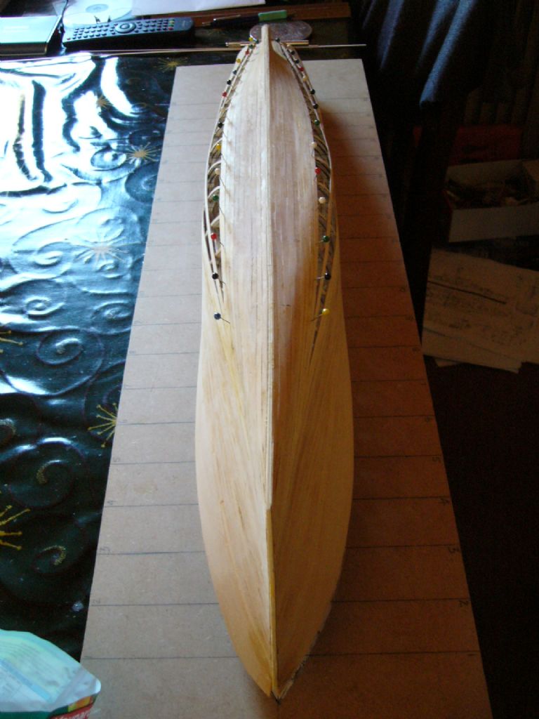

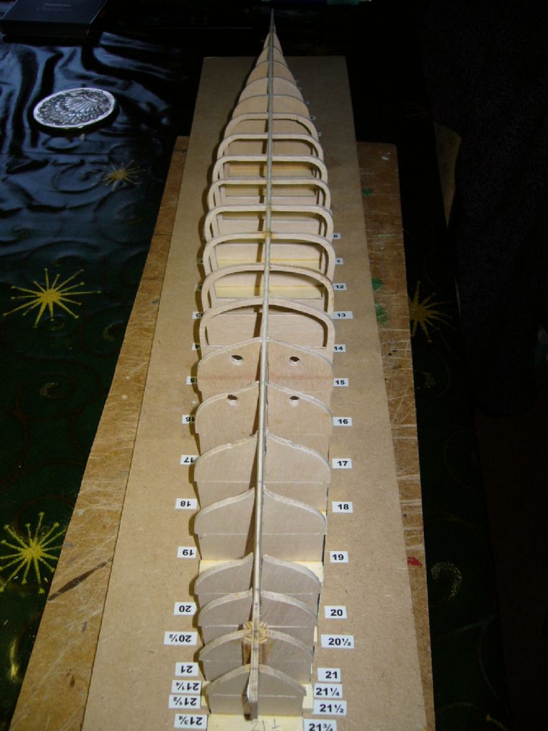

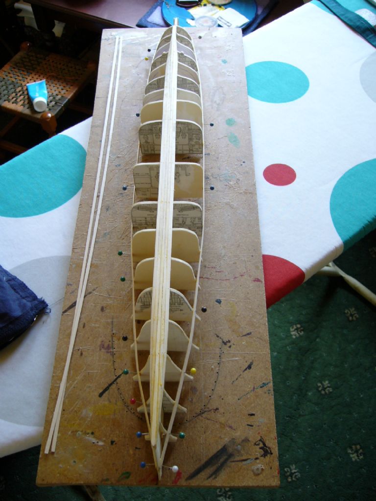

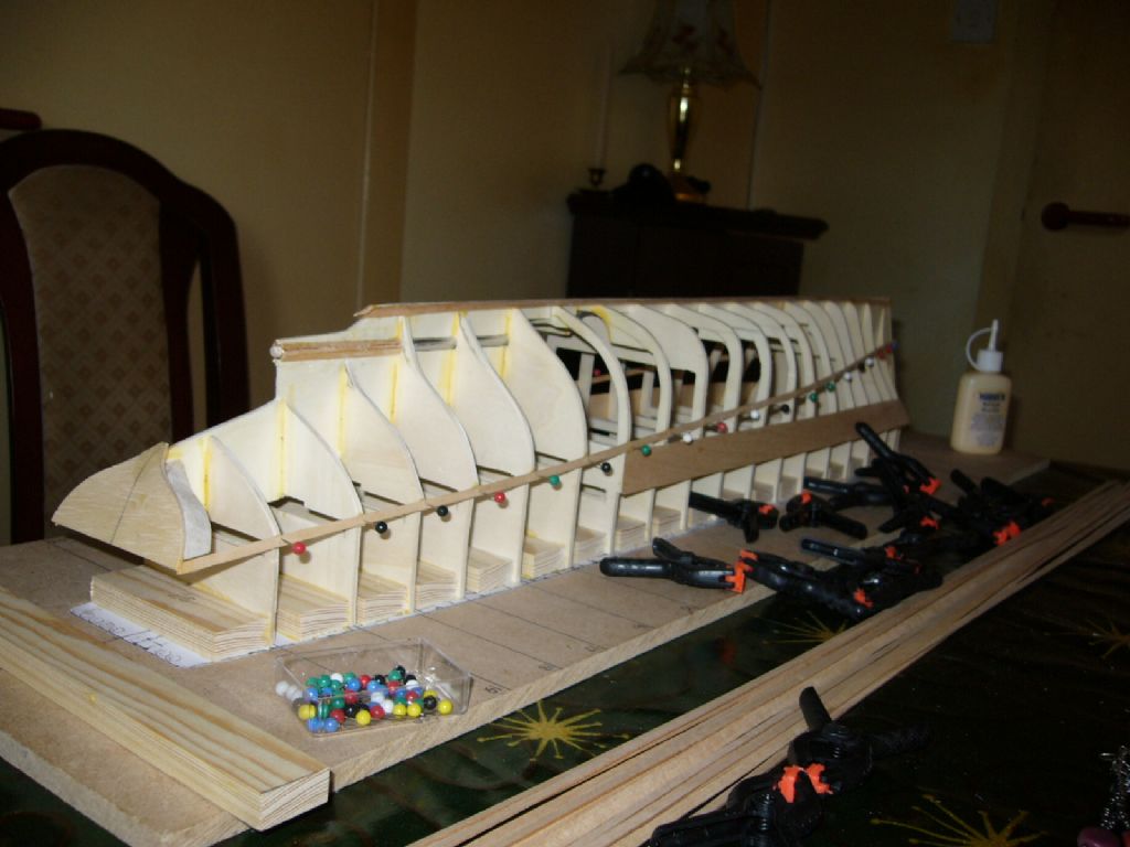

The underlying structures of the 3 boats differ. “The Boat” keel and hull frames are 1/8inch (3.175mm) birch ply; the Castle keel and frames 1/8 poplar ply.
Birch ply is great for strength but I can only work with it when I visit my Dad and have the use of his electric scroll saw. This is very inconvenient to one whose workbench is his dining table!
Poplar and Lite ply are both workable with a Stanley knife at this thickness (albeit with a bit of effort and a plentiful supply of new blades). I did not like the poplar ply as I found it of indifferent quality- looked good on the face of it, but the knife often met fresh air at its core.
I am trying the Lite ply for the Swan frames with Birch for the keel, and am happy with it thus far. I had started with a set of birch ply frames, but when it came to cutting out their internals, I gave up. I love my old man dearly but was fed up with working in his freezing garage every time I visited! An advantage of the change is that the Lite Ply frames are at least 40% lighter than the birch
I have read of the stability and buoyancy difficulties with small models. When I was planning the Castle, I added 7mm beneath the waterline; 4mm above the stern tube and 3mm below. This served (1) to give me ample clearance between stern tube and hull bottom to run a 40mm prop, (2) to allow me to drop the motor in order to align it with the shaft, rather than angle the shaft up into the hull, (3) gain the displacement to carry 2 x 6volt 1.2ah SLAs and a little lead for trimming purposes.
For better or for worse, I’m building the Swan to plan if for no other reason than the discovery learning lesson. If it all goes to rats at the maiden “sea” trials (before any superstructure goes on), I’ll strip it out and finish it as a static model!

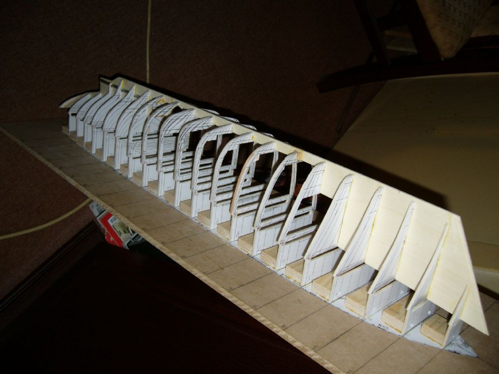

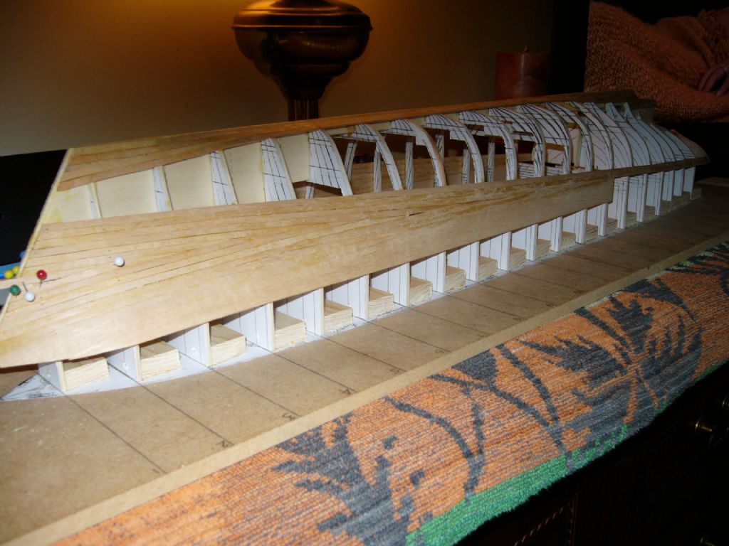

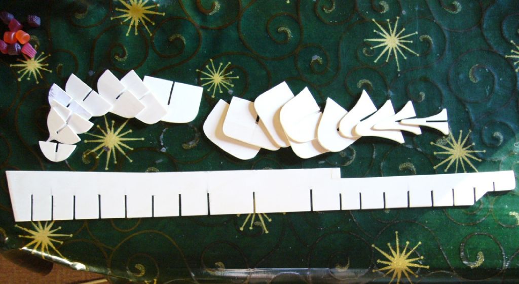

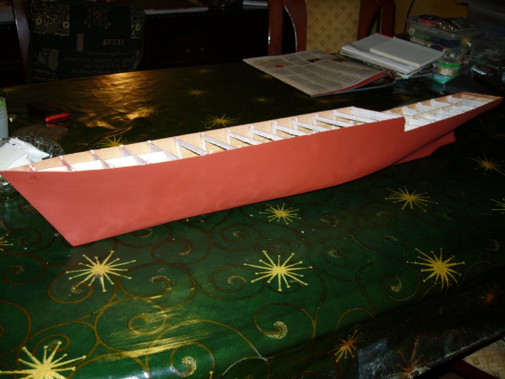

If anyone’s interested, this is how the Castle hull came together:-
(I’d already roughed up an A4 plan sized version of the model to test the un-extended hull sections) You can see my literal cut and paste efforts on the sections to achieve the extra depth represented by the horizontal lines above and below the stern tube.
