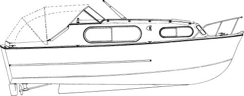

      I have a freeman 23 and would love to make a model of it but havnt a clue where to start.  The picture attached shows the typed of craft.  can anyone start me off?

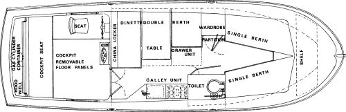

          Hello Jed
          The first thing that you will need is a basic plan of the boat.
          Length:   23′ 3″   Beam:   7′ 6″
          Draft:   2′   Height Above Waterline:   6′ 10″
          Headroom:   5′ 11″   Weight:   30 cwts
          Speed:   8 – 9 Knots   Construction:   Fibreglass
          And from this you can start to develop your idea:
          The next step is to decide how big your model will be and if it will be static or working and what materials you want to build the model out of.
          Come back to us with these answers and we will move on to the next stage.

                To use GRP or plastic will involve a great deal of work making plugs and taking castings.
                Personally I would make a frame out of thin ply and cover it with balsa and then concentrate on getting a nice smooth paint finish.
                Its not to hard to produce a set of templates from the drawing and then to scratch build a simple frame.
