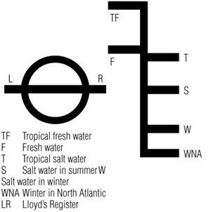

                    Hi Paul
                    Is this difference in water densities shown on the Plysol line?
                    Probably is?
                    #37656

                        #37658
                        Dave_P
                          @dave_p
                          Samuel Plimsoll finally managed to get his bill passed in parliament in 1876 but made many enemies of shipowners who were sending ships well overloaded to sea at great cost to seamans lives. The act allowed shipowners to paint the lines where they thought best resulting in some painting them on the funnel! In 1890 they were forced to paint them as intended.
                          This Plimsoll line is for the starboard side of a vessel; on the port side,the markings are reversed. The centre of the disk is placed at the middle of the loadline. The lines are one inch thick.
                          The letters indicate cargo, season and location:
                          LTF Lumber, Tropical, Fresh
                          LF Lumber, Fresh
                          LT Lumber, Tropical
                          LS Lumber, Summer
                          LW Lumber, Winter
                          LWNA Lumber, Winter,
                          North Atlantic
                          LR Lloyds Register of Shipping TF Tropical Fresh Water Mark
                          F Fresh Water Mark
                          T Tropical Load Line
                          S Summer Load Line
                          W Winter Load Line
                          WNA Winter Load Line, North Atlantic
                          Hope this helps further Bob.
                          Cheers
                          Edited By Dave_P on 18/11/2012 14:57:23
