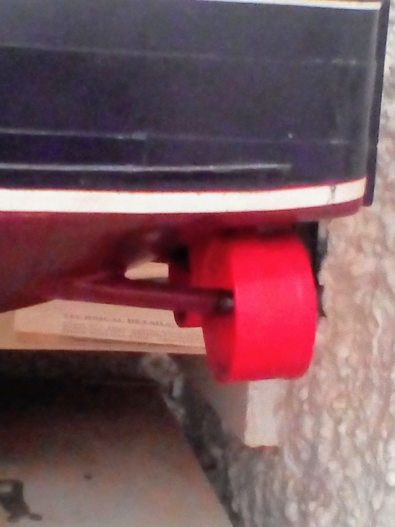

                      #92987
                      Charles Oates
                        @charlesoates31738
                        Perhaps this will help.
