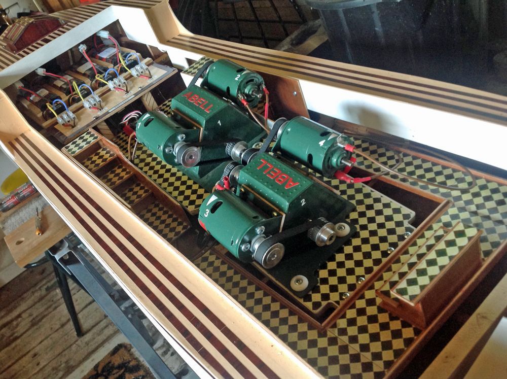

                              Sorry to shock you, Martin……..Yes four motors!
                              Paul and I worked on a Gentleman`s Vintage Cruiser for nearly two years….2014 – 2015
                              Paul designed it and I built it
                              It was such a large bulky 60" model, we went a bit overboard with the motor drive!
                              Here she is………Stand well back
                              Magnificent?
                              We had great fun at last year`s Haydock Show!
                              We changed anybody 10p to see it run!………All for Charity of course
                              #67837

                                Good grief! I suppose in a 60" model 4 motors isn't too far overboard. I take it they're paired as driving twin shafts?
                                I have a promise of something special for twin screws in that my chum in America has a matched, handed pair of Krokers, built bespoke for chum's Dad by the man himself. Now for an old electric motor buff like me that's something to look forward to! I need only to decide on a suitable boat to put 'em in!
