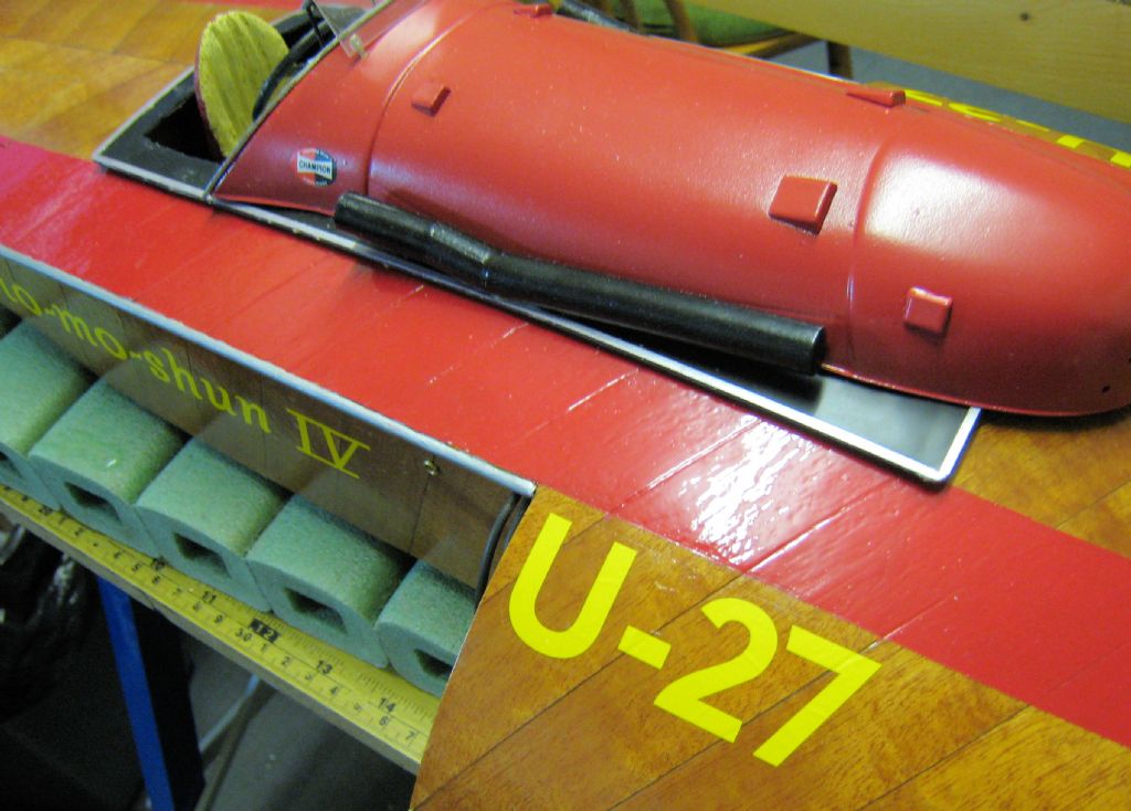

                                        #29437
                                        Jeremy
                                          @jeremy15845
                                          I am terrified of getting the next step wrong!
                                          Hull varnished with Ronseal yacht varnish, Red stripes applied using Humbrol enamel.  Water slide transfers applied and will now be left for 24 hours to dry completely.  I now need to fix the transfers but with a method that will not destroy them.  Unfortunately, with only one set of transfers, I only have one shot at getting it right.
                                          Can I safely varnish over the transfers (and the red stripes) with a final coat of yacht varnish applied with a brush? or
                                          Should I fix the transfers using Humbrol gloss acrylic varnish which I have in a spray can (and then apply a final coat of yacht varnish or not)?
                                          I already used the Humbrol acrylic to fix the transfers on the tail fin but the colour on the fin was applied with a Humbrol acylic spray.
                                          Advice would be appreciated!!  Photo of hull below:
                                           Jeremy
                                          #29440
                                            I would give the transfers more than 24 hours to dry and the red enamel two or three days but then it should be safe enough to use the Ronseal yacht varnish. Don’t use the Humbrol acrylic spray as it is possible that the solvent may react with the existing surface.
                                            All looking very good so far!
