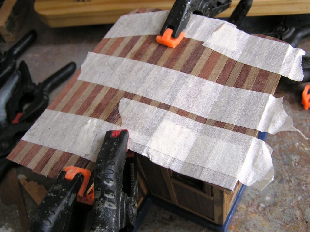

      Whilst planking the deck of my Eileen Fishing boat I tested out a fast planking idea !!!!
      Basically you dry fit a number of veneer planks and hold them together with masking tape.

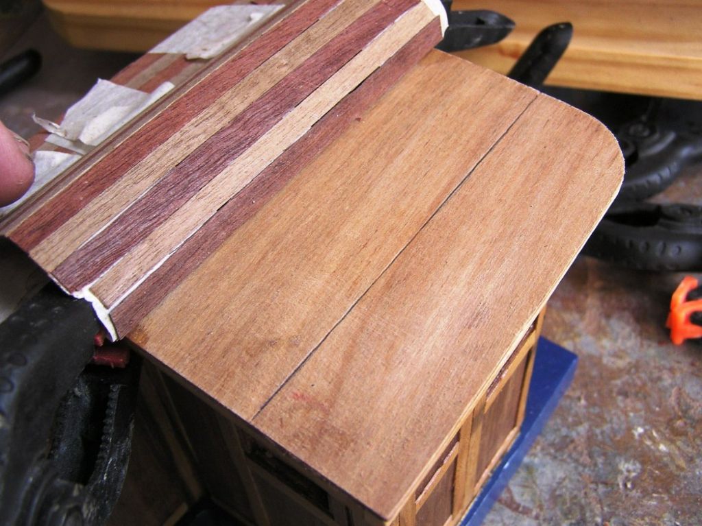

      Next mark the area and fold back the strips, about six strips is a workable number.

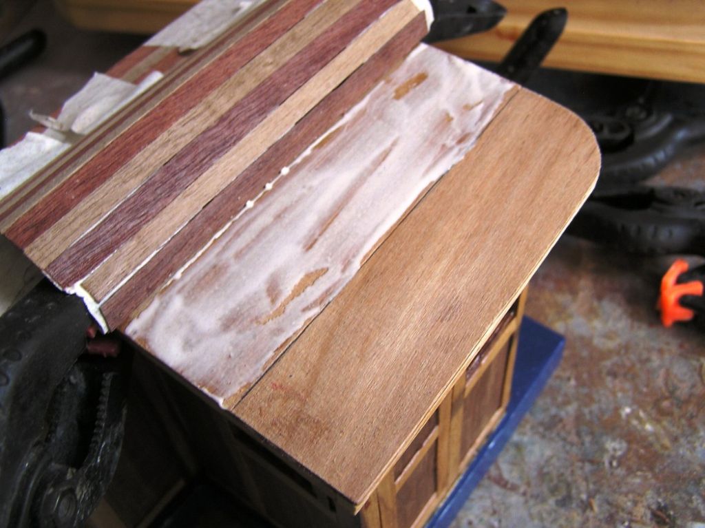

      Spread out the glue then fold back down the strips and pushout all the glue.

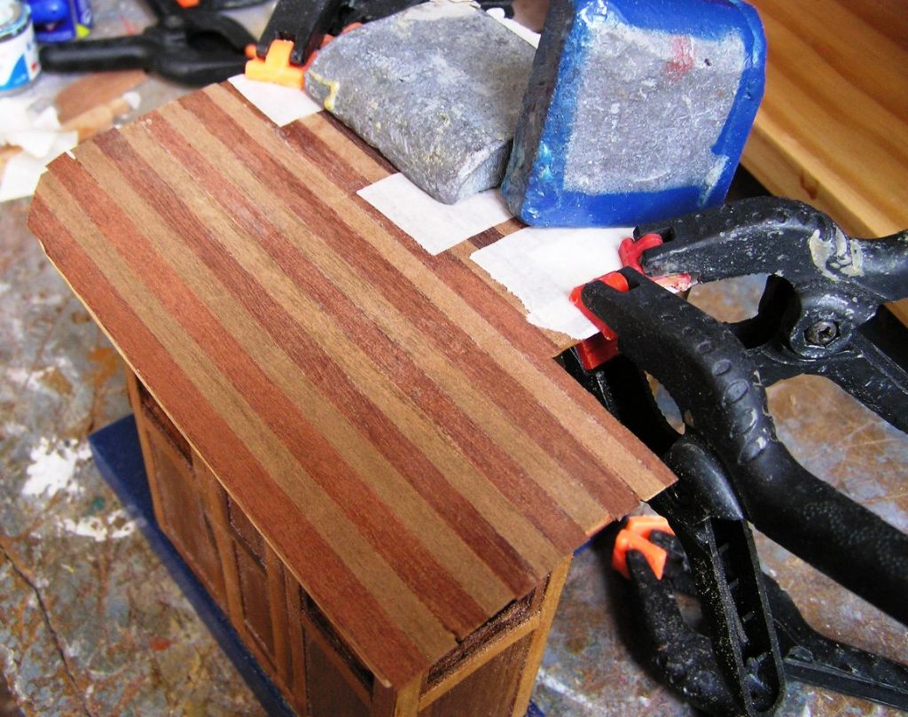

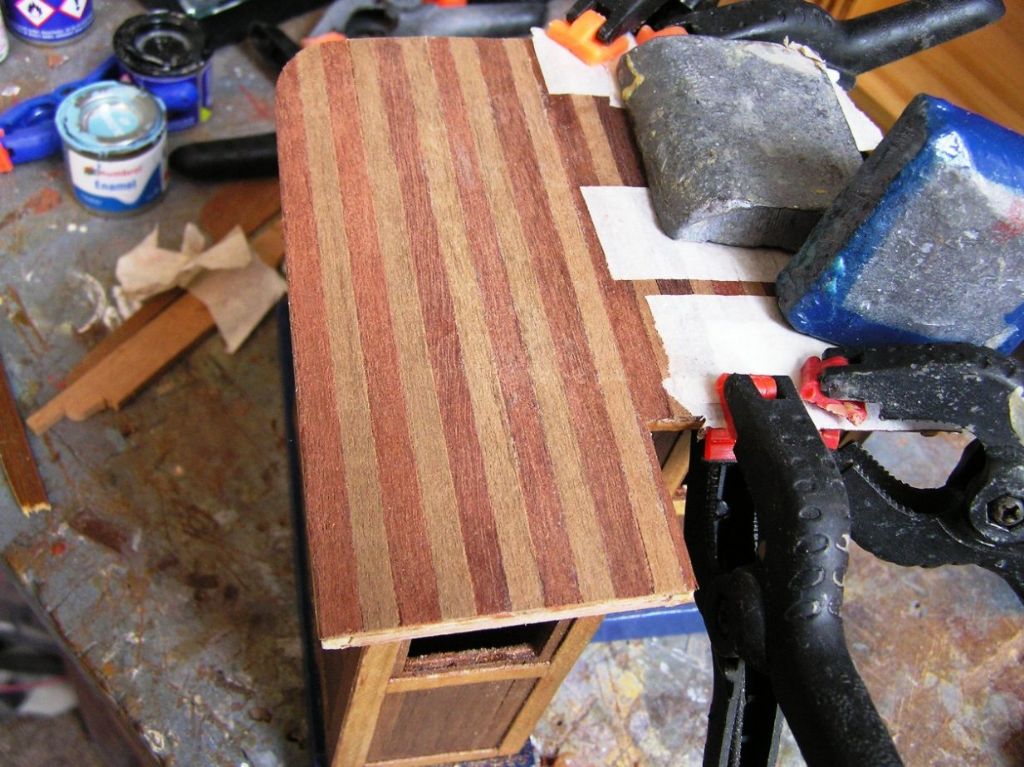

      Wipe up any glue and apply clamp and weights.
      When the glue is dry, remove masking tape and sand down the area.

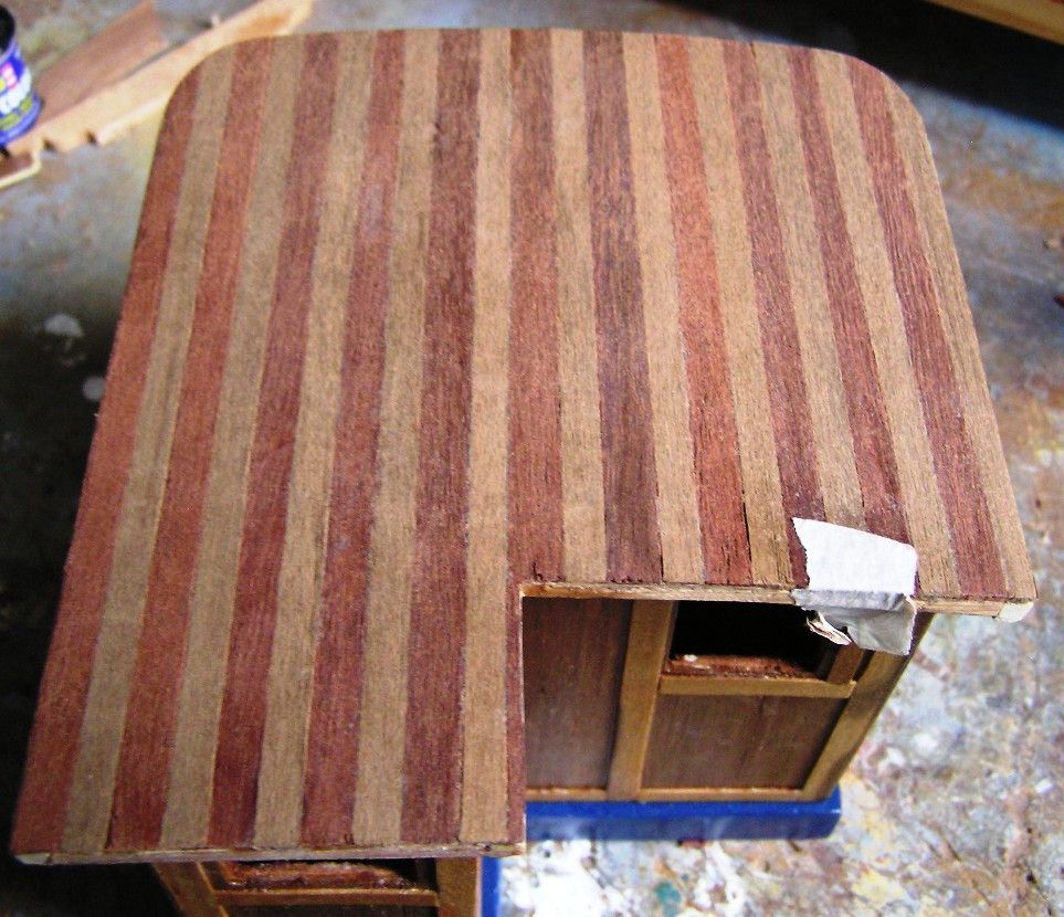

            Finished with only one little hiccup !!!
            Ready for the outer trim and matt vanish.
            Nice afternoon's work.
