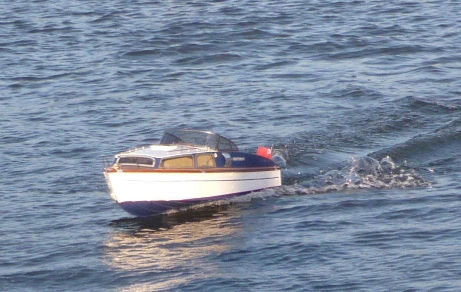

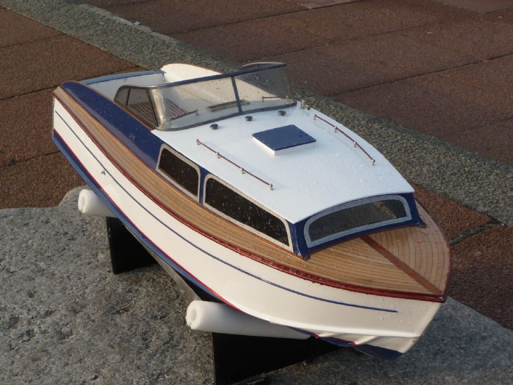

                This is my Huntsman 28 undergoing a rebuild
                Well, its white, on a snowy foggy day, perhaps you can just use you imagination!

                        Hear is a nice picture of a Huntsman built by redrat
                        Peter
