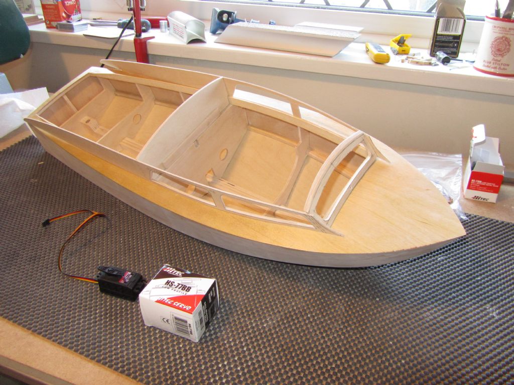

      #81692

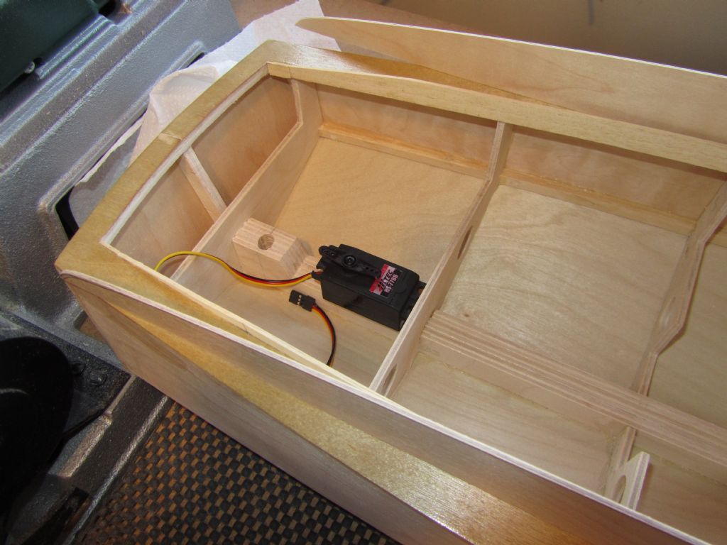

        Before gluing the inner cockpit sides and floor together I wanted to ensure that there was sufficient depth available for the rudder and servo. Measurements for a Hitec low-profile servo suggested there was but wanted to be certain, so ordered a couple (one for the River Cruiser, though height isn't a concern as has a rear cabin) and a conventional, more powerful one for the Swordsman 33.
        The servo will fit in fine.

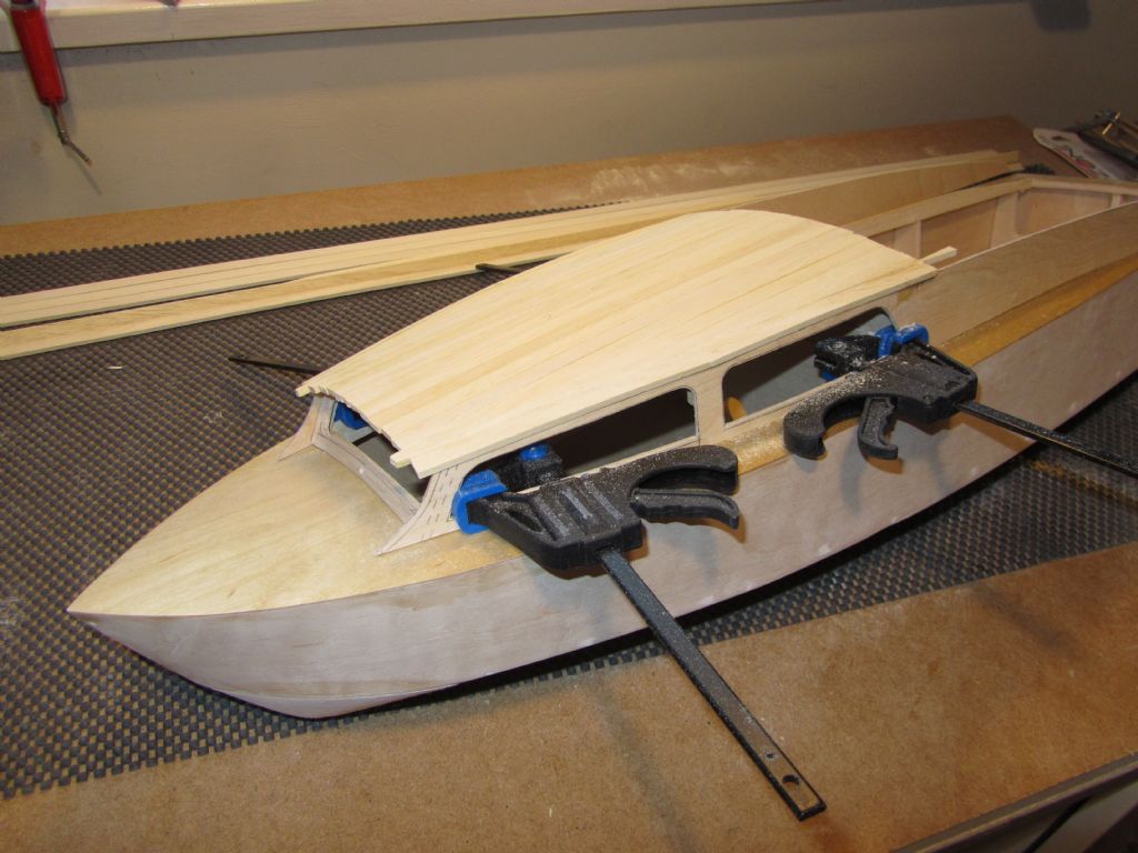

            #81752

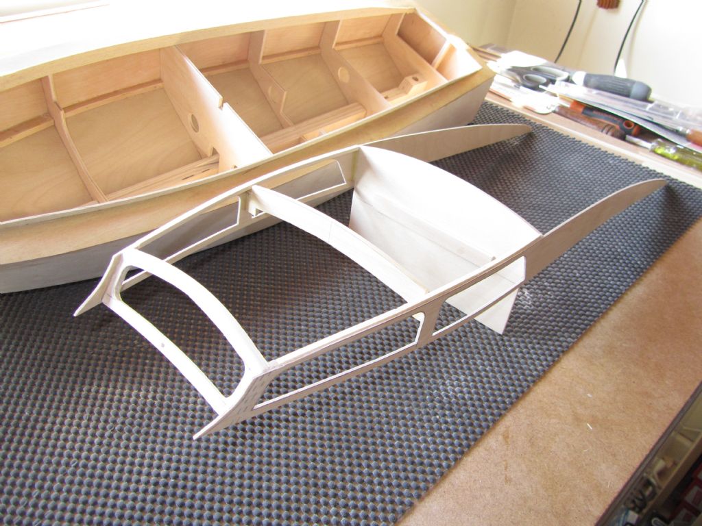

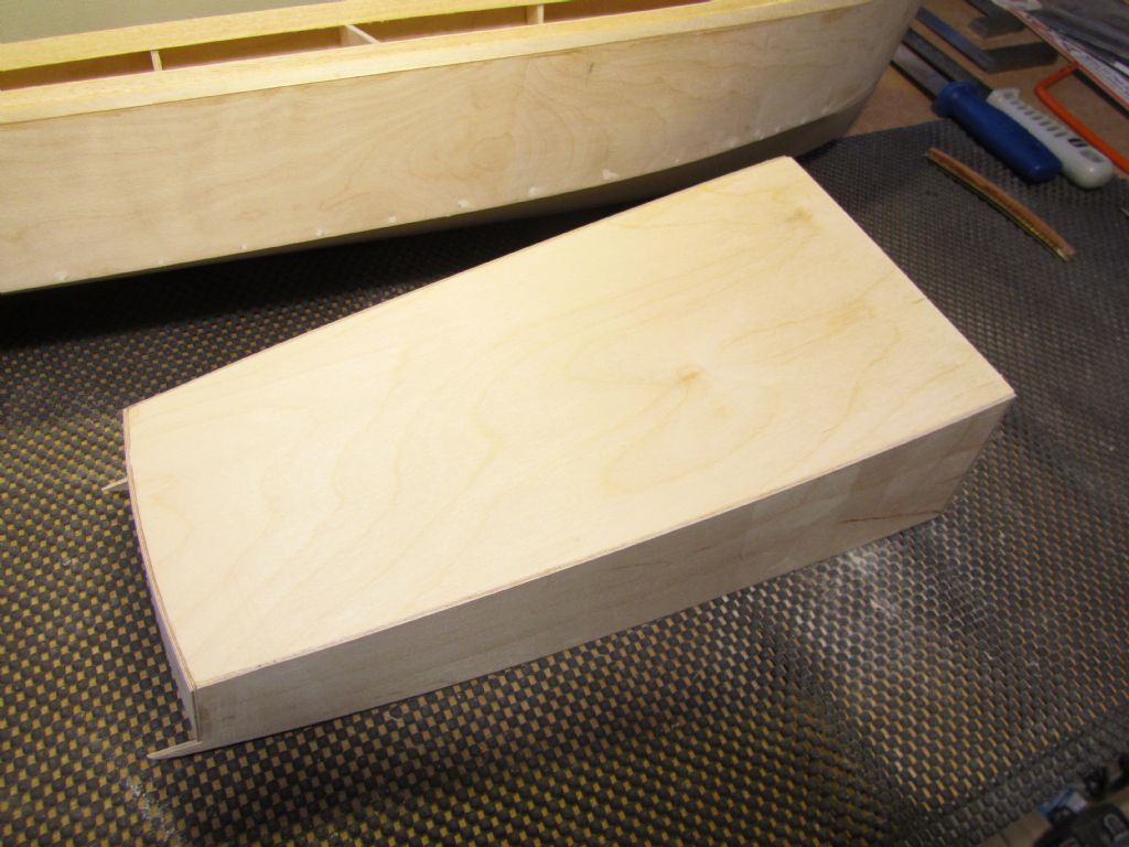

              cabin 2.jpgBit more progress on the cabin/cockpit framework. During the week I've added 3mm x 3mm strengthening timbers at the junction of the front window frame and cabin sides – they ain't coming apart again now! Also added the central support for the roof.
              Today I planked the roof which was satisfying. Fairly simple and relaxing job but progresses the build nicely. Tomorrow I shall trim the planks at the front, rear and sides and give the roof a preliminary sanding.
              Then it's on with the cockpit. Despite me clamping the cabin and cockpit sides to the coamings whilst working on the roof a bit of twist has been introduced which has resulted in the rearmost parts of the cockpit sides sitting a couple of mm above the deck. The cabin area is a nice snug and accurate fit though. I'm not worried though as I can remedy the twist when I fit the inner cockpit sides even if, as I think, I will have to put some saw cuts in the existing outer cockpit sides and then fill later. The situation isn't helped by the Huntsman 28 having such a long cockpit.
              Early on in the build I was concerned that I'd got my drawings/measurements wrong as the hull looked so long and narrow, well it is! But now that the superstructure is taking place it is starting to look as it should and the cockpit won't look as long once the engine cover and seats etc. have been installed.
              I retired yesterday and whilst I will have other calls on my time I should be able to spend more time on these and future builds, especially if the weather is not too clever. Yippee!

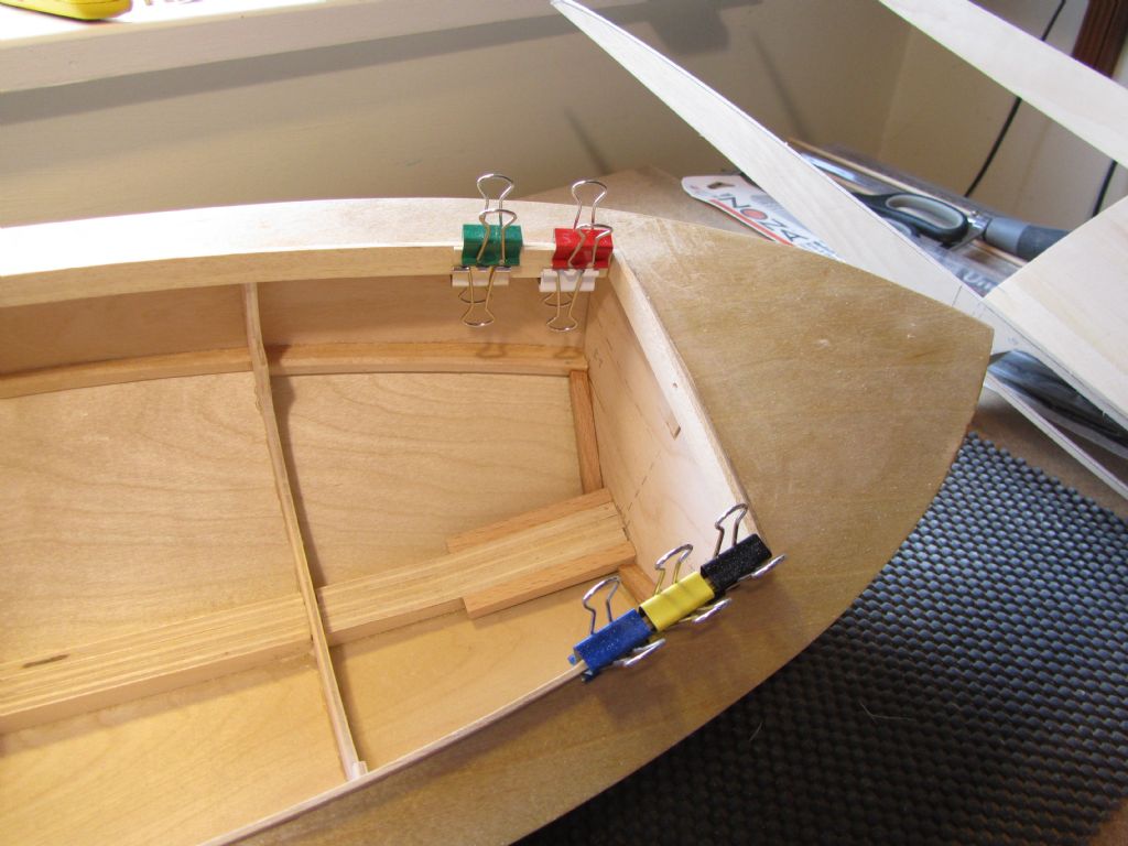

                          Bit annoyed this morning to find that the superstructure has twisted a bit more. Took the clamps off last night to photograph it and thought it would be OK to leave off as the Cyano holding the planks to the structure would have gone off. The A/resin between the planks wouldn't have though and it's that drying that has caused the distortion.Beginners mistake and one for the memory bank. It's not bad though and I can sort it or make it worse, one or the other!
                          Talking of the memory bank I think I may make a start on a Huntsman 31 whilst I can still remember and learnt from building the hulls on my current builds!
                          I don't intend doing much more on the River Cruiser and H28 until the weather is suitable for painting and the Fisherman and Swordsman are longer term projects though hopefully things speed up a bit more now!

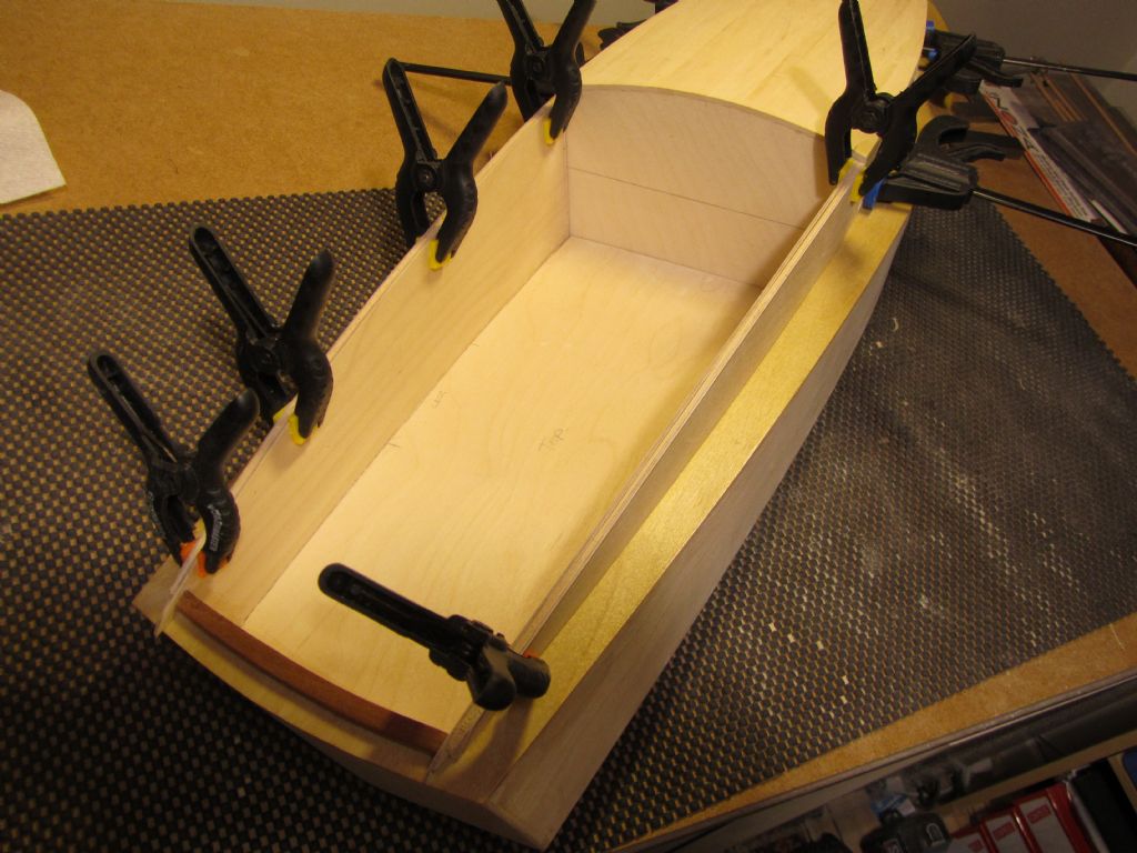

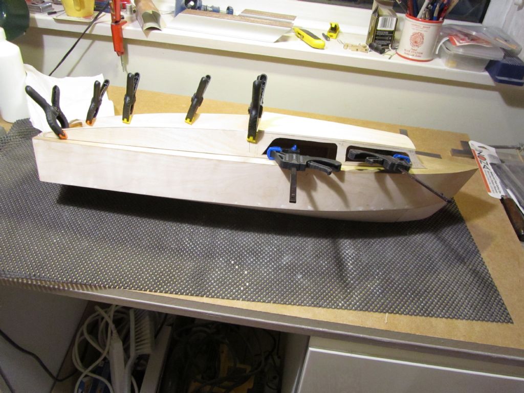

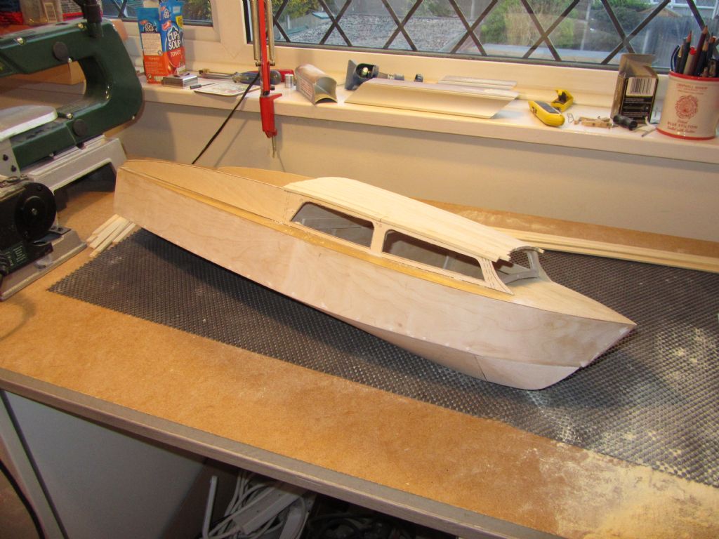

                          #81776

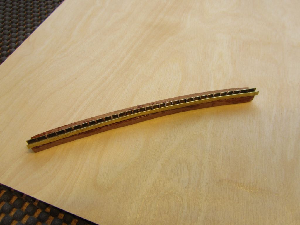

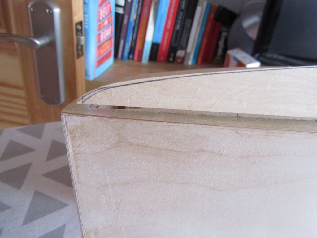

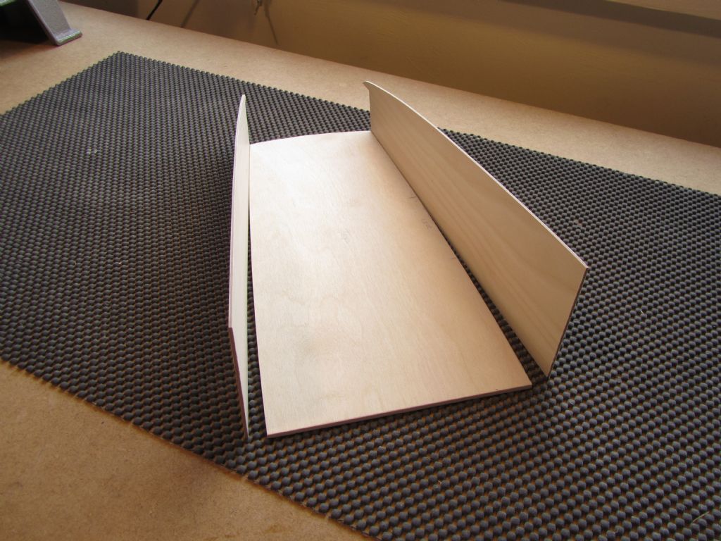

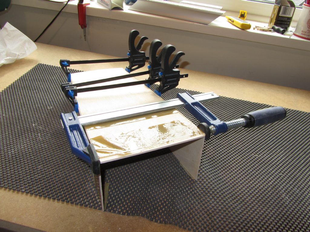

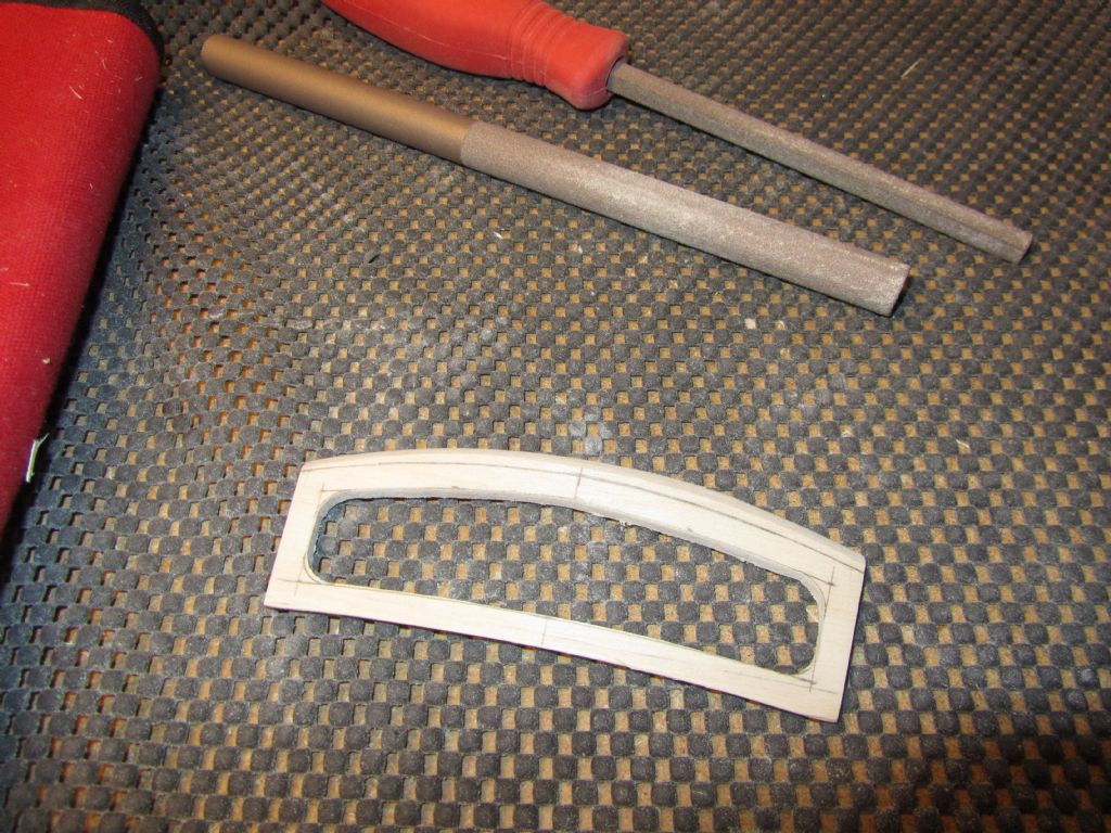

                            channel glued to capping.jpgsaw cut.jpgbow in sides.jpgcockpit commenced 2.jpgcockpit sides & bottom.jpgcockpit commenced.jpgRoof trimmed and sanded to all sides and the top has been given a preliminary sanding with the PermaGrit.

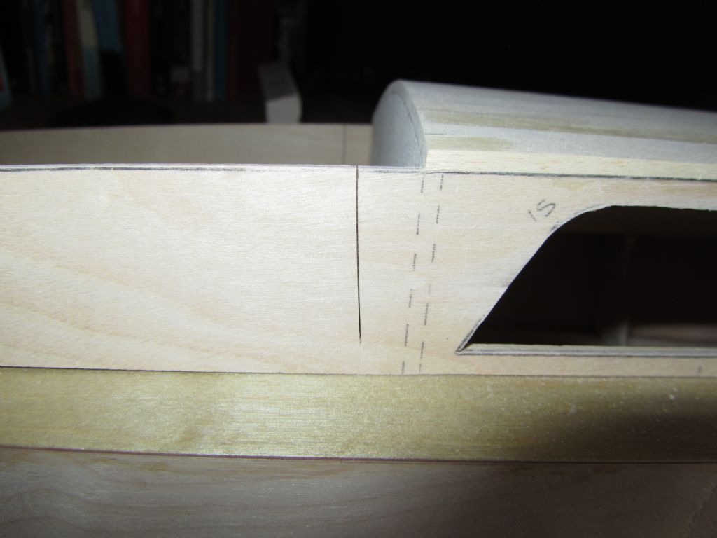

                            Part of the twist was found to be due to a build up of saw dust laugh and most of the problem is due to bowing front and rear along the sides – looks worse than it actually is. As said the cabin is a pretty good fit so I've put a saw cut in each cockpit side, just behind the cabin, so that the cockpit sides can be "bent" down to touch the top of the deck. Fitting the superstructure hasn't been made any easier of course by having a curved deck. When clamping the cabin sides to the coaming there was a cracking sound – the coaming is only 1.6mm thick and had cracked up by the window frame. Soon fixed with some reinforcing pieces of coaming.

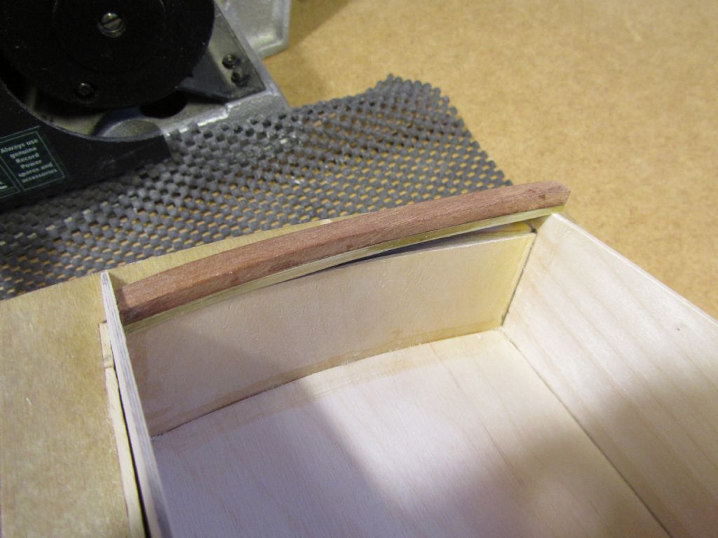

                            A start was then made on the cockpit. I'd previously cut out the cockpit bottom and sides and just needed to sand 2mm from each side of the bottom to allow for the thickness of the sides and cut a bit off the end of the bottom at the cabin end so that it would drop into the hull. I then tacked the pieces together at the transom end with cyano and once set clamped that area. I then glued the rest of the side and bottom joints with a/resin, clamped and set aside overnight.

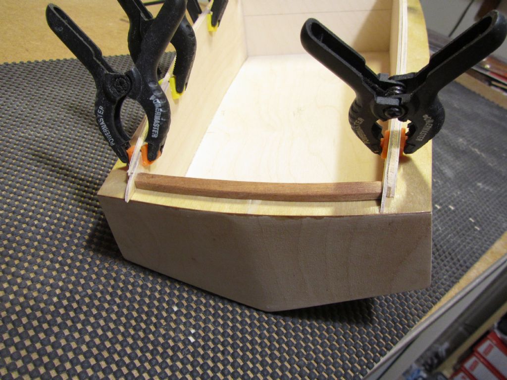

                            I'd decided that it was best to deal with the construction of the cockpit at the transom end first due to the envisioned difficulty of making everything fit as it should. The sides and bottom by the cabin have been left longer so that they can be sanded back to size.

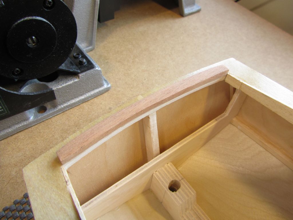

                            So I then moved onto the transom and sanded a piece of mahogany strip to shape having marked it out using the card template for the cockpit bottom. I also reduced the section of the capping by sanding the top to a slight angle and rounding off the rear corner. As the top of the transom is slightly curved I also sanded the underside of the capping to get a good fit.
                            To locate the top of the 2mm ply forming the inside of the transom/rear of the cockpit I've used a brass channel, bought previously for the purpose. To enable it to be bent easily I made numerous saw cuts and then glued it in place with 5 minute epoxy.

                            #81778
                              transom capping 3.jpgroof sanded.jpgFew more photos. I don't even try now to get them into anything like the right order!

                                The old cabin sides and curved deck syndrome, rather late now! But scribing the sides to the deck before marking out the Windows and curves is the only way to achieve a good fit in my experience, maybe ply wedge shaped pieces fitted to fill the gap ?
                                #81783
                                  Yes Ray, with hindsight that is what I should have done. As I keep saying, part of the learning experience! It will come in useful for the Swordsman 33 and then a future Huntsman 31.
                                  With the saw cut I'm pretty confident I can achieve a good fit and the outer skin of the cockpit sides will be glued to the inner skin, sandwiching coaming width timber, so it will be all good and strong.
                                  #81796

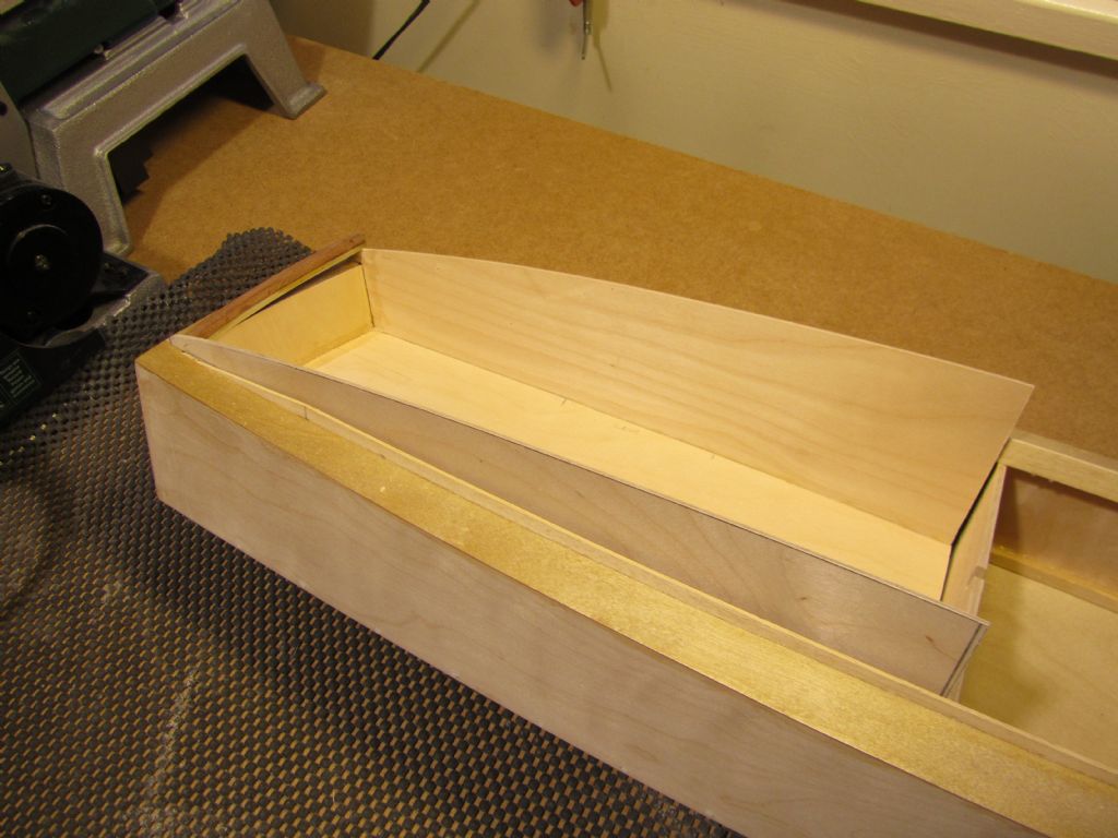

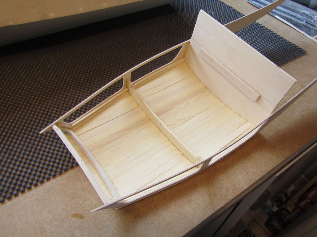

                                    cockpit 5.jpgcockpit 4.jpgWho thought it a good idea to have the superstructure lift off in one piece! This is turning out to be the trickiest part of my builds so far.
                                    Bit more done today, rear of cockpit cut out of 2mm ply an glued in place. More needs cutting/filing off the end of the capping and then that can bb glued to the top of the cockpit rear.
                                    #81797
                                      Yeah – that transom area is the really interesting bit, Chris – and the main reason I'm watching ths thread!
                                      #81799
                                        I've been doing a bit more this morning Dave and it will soon be revealed. Or I will be posting a picture of my dustbin! laugh

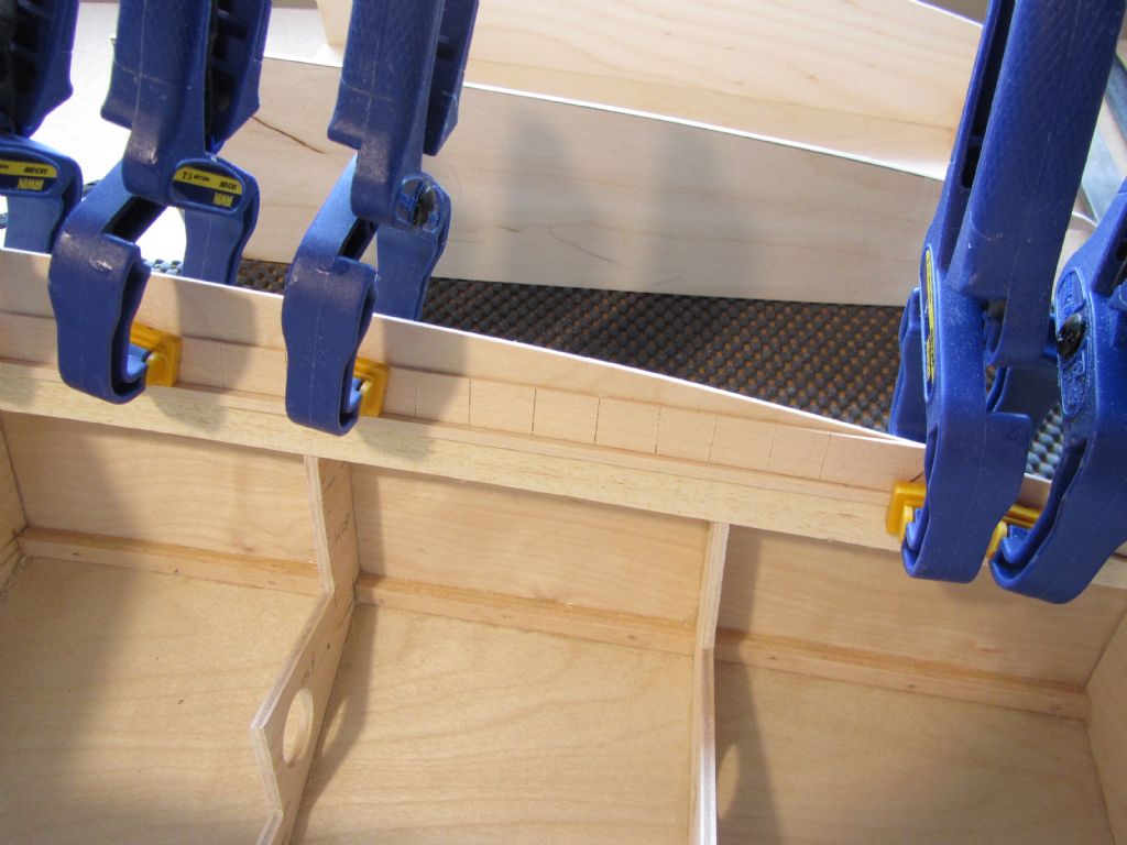

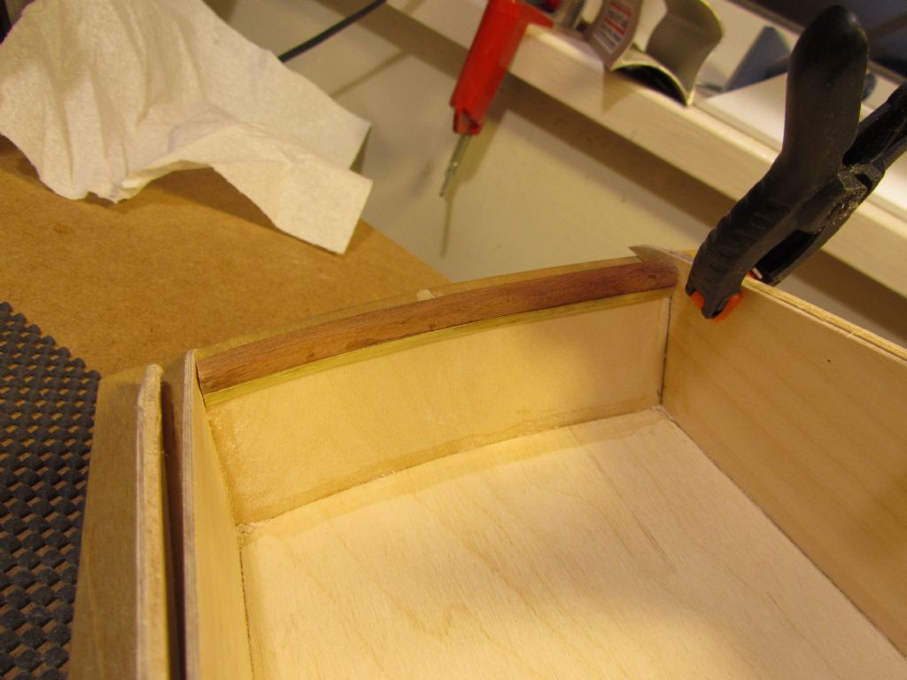

                                                    sandwich timber.jpginside cockpit.jpgside view 2.jpgcapping in place 2.jpgDay started with fitting timber strips inside the cockpit sides that would be the sandwich between the inner and outer sides. These were 1.6mm bass, the same thickness as the obechi coaming but being bass they were softer and bent more easily and therefore less likely to spring back straight but even so before gluing in place I made saw cuts in both sides to reduce the tendency and to maintain a good fit with the curve of the coamings. The photo shows the lower strip set 3mm above the coaming by sitting it temporarily on a 3 x 3mm strip. A second strip was then glued in line with the top of the cockpit side. As well as keeping the inner and outer sides apart these strips provide strength across the saw cut and as you can see the joint between the sides and deck is pretty good now.
                                                    I then returned to the transom capping and filed both ends until it was a snug fit between the inner cockpit sides. Once done it was back onto the cockpit itself and sanding the ends of the bottom and sides until the cockpit dropped into place. Before I glue it to the outer cockpit sides and back of the cabin I will do a last bit of sanding to give it a bit of wiggle room.
                                                    I used 2mm ply for the inner cockpit sides to give me a good gluing area but it's a bit stiff to curve. So before gluing to the outers I will put some partial depth saw cuts in it, from top to bottom.
