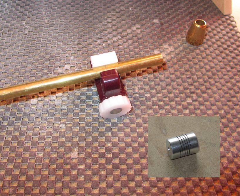

      Hi Chris, Saw you are moving from the UJ coupling to the rubber sandwich type. I'm moving the opposite way, changing out the rubber to UJ. The reason being too much vibration being transferred to the prop shaft. I aligned the two shafts and motors with an solid alignment tool, so know alignment is pretty good, however both shafts are transmitting vibration to the hull. Awaiting delivery to see if this will be resolved.
      Love the prop display!
      Brian
      #87601
        Sometimes the brass bushes on these things are not QUITE centred and can cause vibration, so often worth simply changing the brass bits when encountering the dreaded rattle.
        Chris. The thing to have in the spares box is the two bladed plastic props. X and S (standard). These will drive anything and are ideal for experimenting with. For my money they work much better than brass ones, however don't look as good. So cheap as well.
        #87602
          Brian – No, I'm using both. The UJ type was left on the worktop from the River Cruiser installation. I'm using that type as the model is low power and speed though being Raboesch and well made I'm sure they would cope with higher power. In my faster models I'm using the sandwich type. Reports I've read say that they are smooth and quiet. I've cut the inner shaft to suit now!

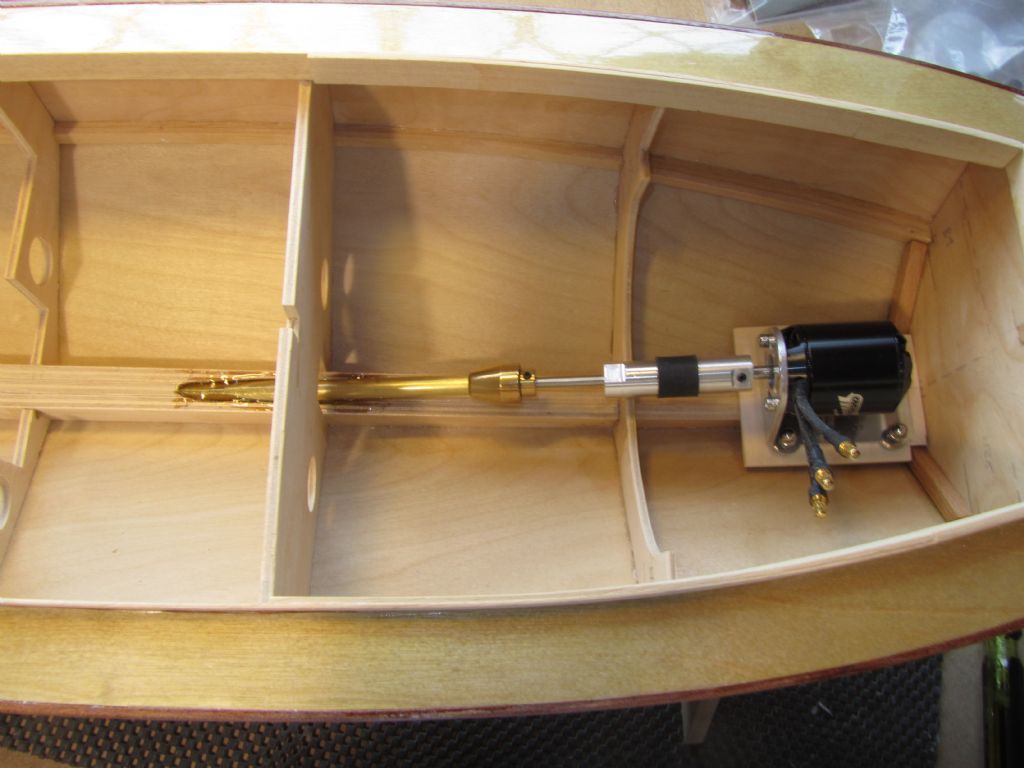

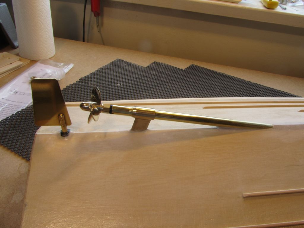

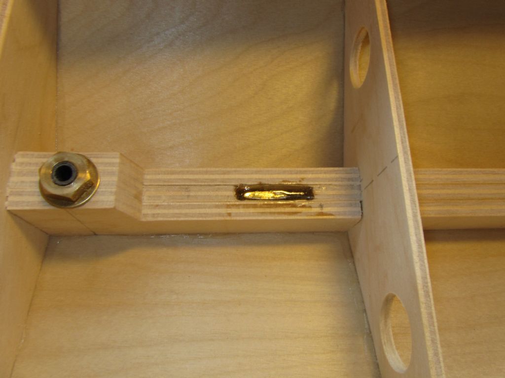

                            As with the River Cruiser the prop shaft and P bracket was secured with epoxy putty, which once it had gone off was filed and sanded to fair it to the hull. Before doing this, as mentioned earlier the prop tube was shortened with a mini tube cutter. This took some effort compared with cutting copper tube and the end had to be tidied up with a file. I could have avoided shortening the tube if I'd used the shorter coupling (inset in photo) as this is what I used in my drawing, but the length of tube inside the hull protruding from the keel would be quite long and unsupported so I decided to use the longer alloy/rubber/alloy type.
                            The hull was then turned right side up and the P bracket and prop tube holes through the keel filled with 20 minute epoxy.
                            Again this was left overnight and I then replaced the solid coupling with the flexible coupling and checked that the prop shaft was turning smoothly.
                            As with the River Cruiser, ready for painting now.

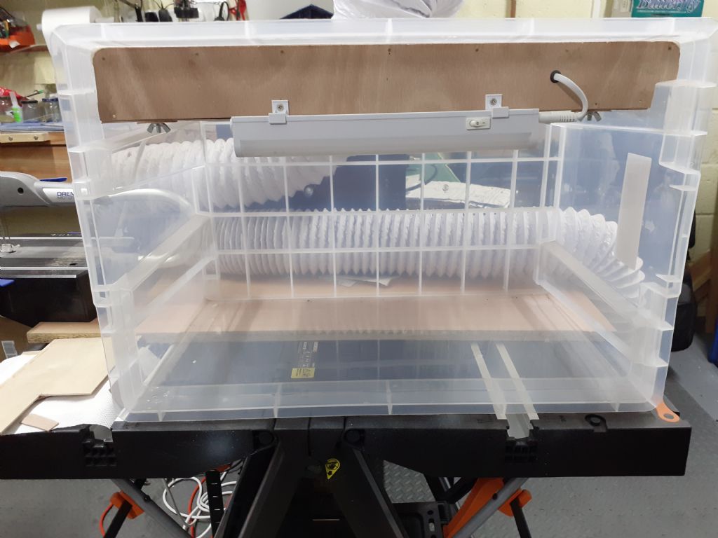

                                          Lots of ideas for spray booths on YouTube.

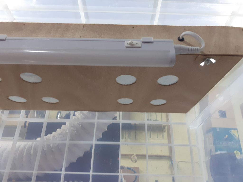

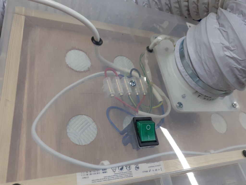

                                          I built mine from a 50L plastic crate from B&Q, extractor, strip light, switch and some thin ply. The removable filter is two layers of kitchen paper. It didn't take long to build and when not in use can be used as storage!
                                          You'd probably need a bigger box, but the principles the same. I find the paint fumes are nicely displaced, so have no issues with getting high! A few pics of my attempt …
                                          I use a bit of cardboard inside just to keep it clean …
                                          Edited By Brian White 3 on 11/05/2020 11:55:41

                                            My post about designing and drawing one was tongue in cheek. Was just going to get one of those "spring up" plastic sheet covered canopy things to contain the overspray.
                                            Your spray booth is impressive though, thanks for the information. Certainly a good option for smaller parts.

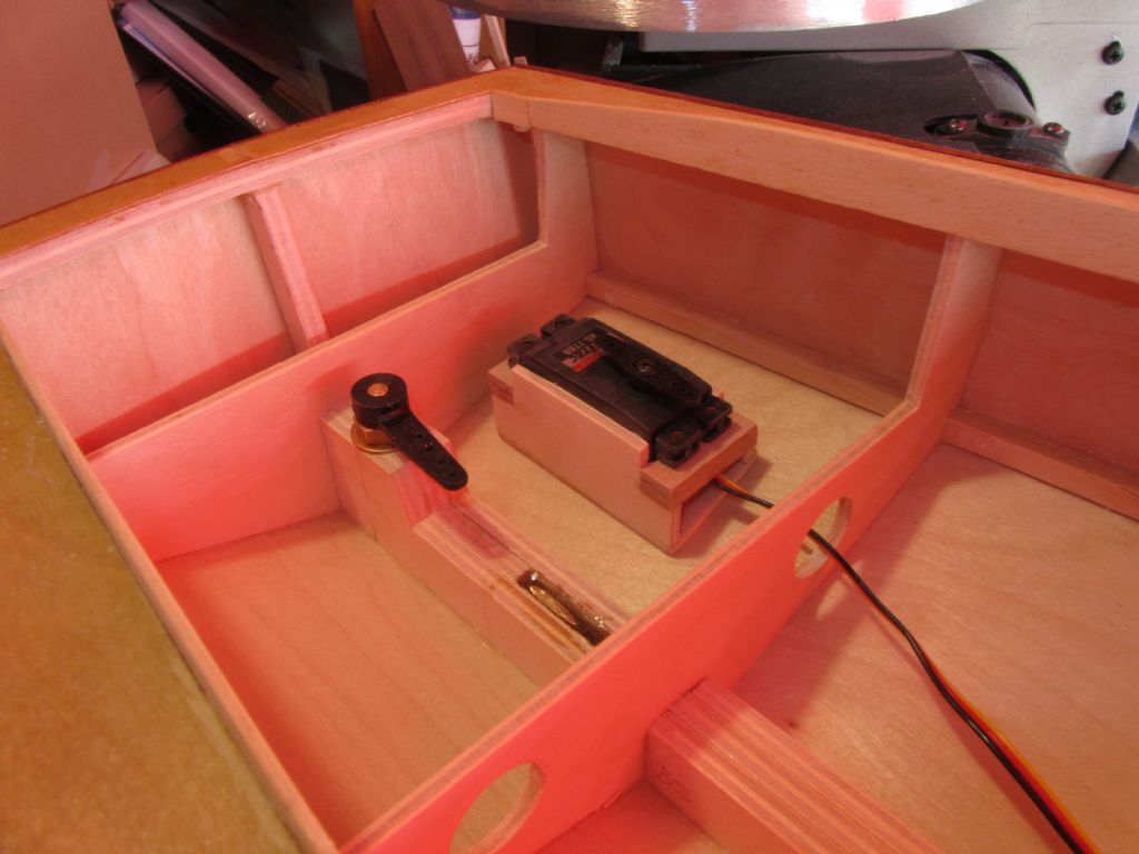

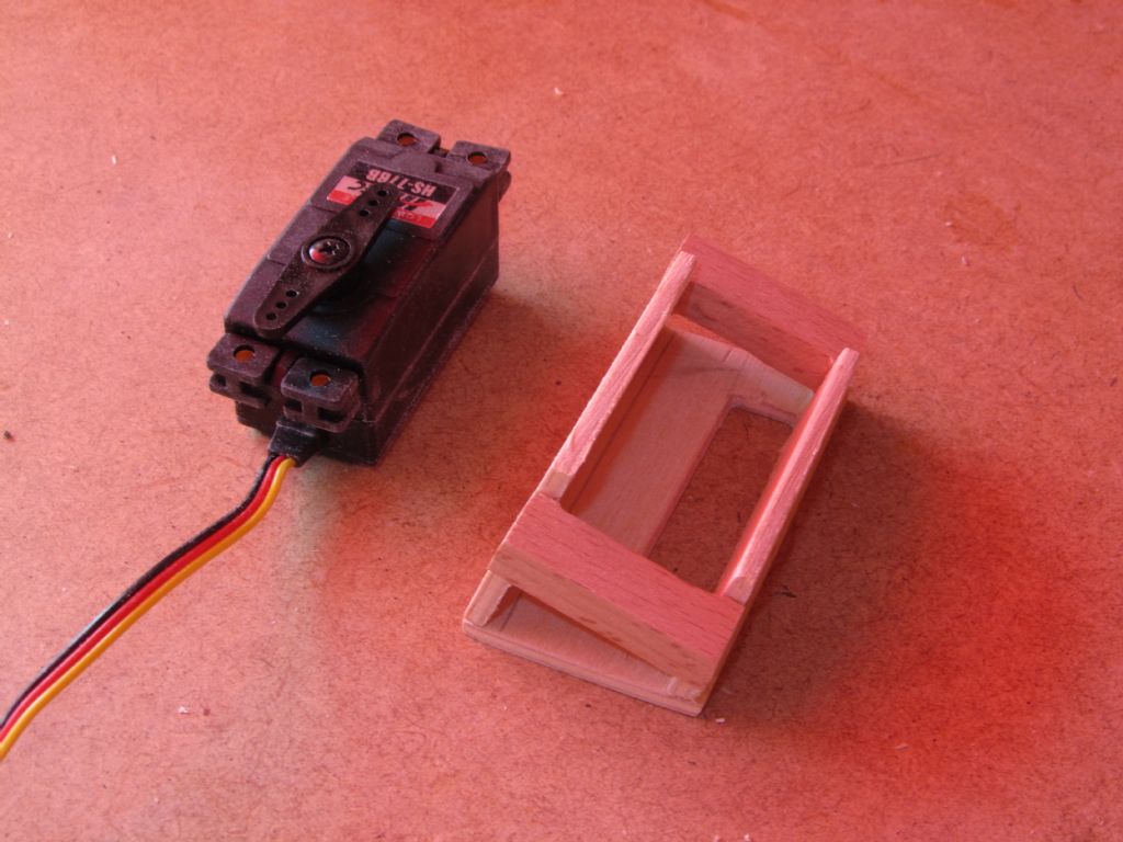

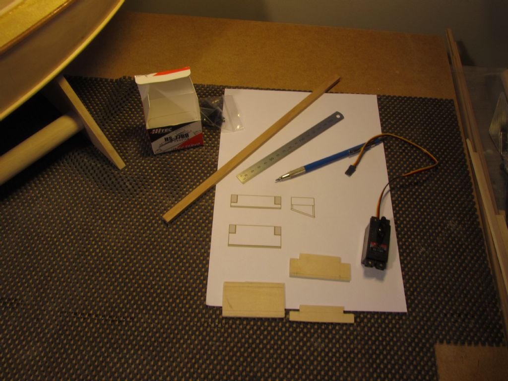

                                                  Initially I was going to mount the rudder servo on the keel and have the rudder arm to the side. But the rudder is close to the transom so have now decided to have the rudder arm fore and aft and the servo to the side.
                                                  Knocked up a drawing for the rudder servo mounting, primarily done to get the angle the same as the hull which the mounting is going to be glued to.
                                                  Then the parts were cut out of 3mm ply with beech bearers for screwing the servo to and glued together with Aliphatic resin and now ready to be glued into the boat using the same. You will see that I turned the bearers round as the deep part wouldn't fit between the rubber mountings and the cable.
