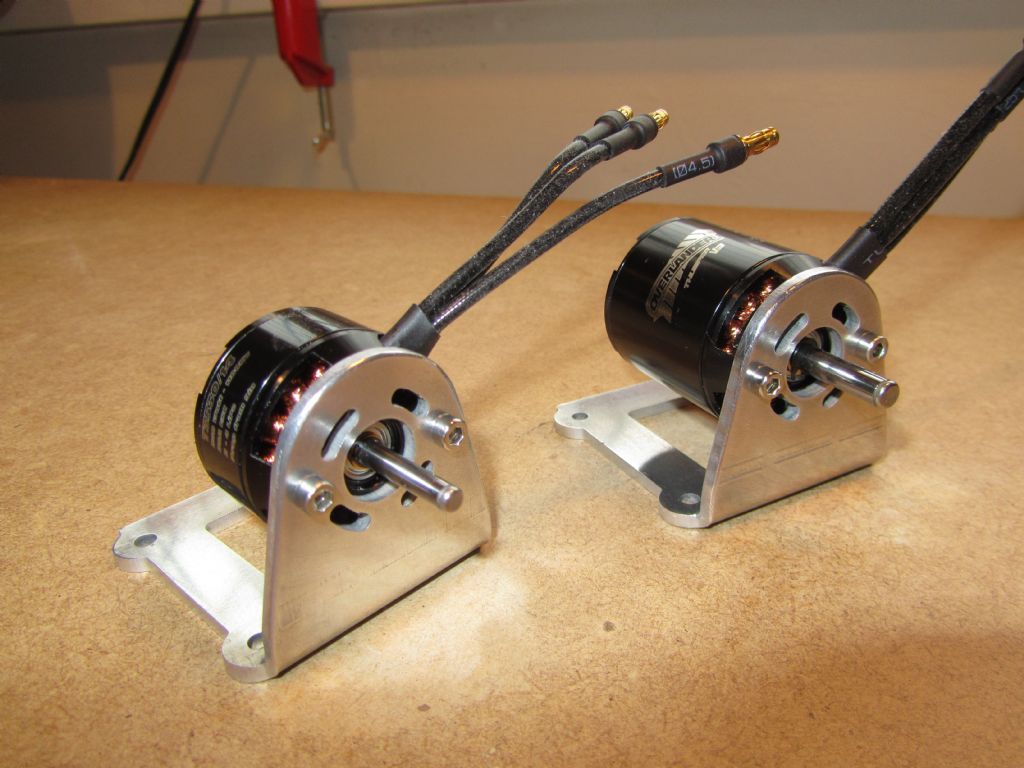

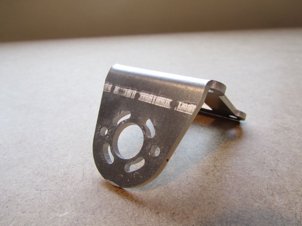

      I mentioned previously that I was going to have to do a bit of fettling of the alloy motor mounts. Of course they would do the job as supplied but no way was I going to mount lovely engineered brushless motors onto them as they were with sharp edges and the jaw imprint from where they were bent.
      So today I spent a restful hour or so with file, emery paper and Brasso to make them more presentable to be fitted into Fairey models. I didn't remove the jaw marks completely as there were pretty deep, but improved nevertheless.

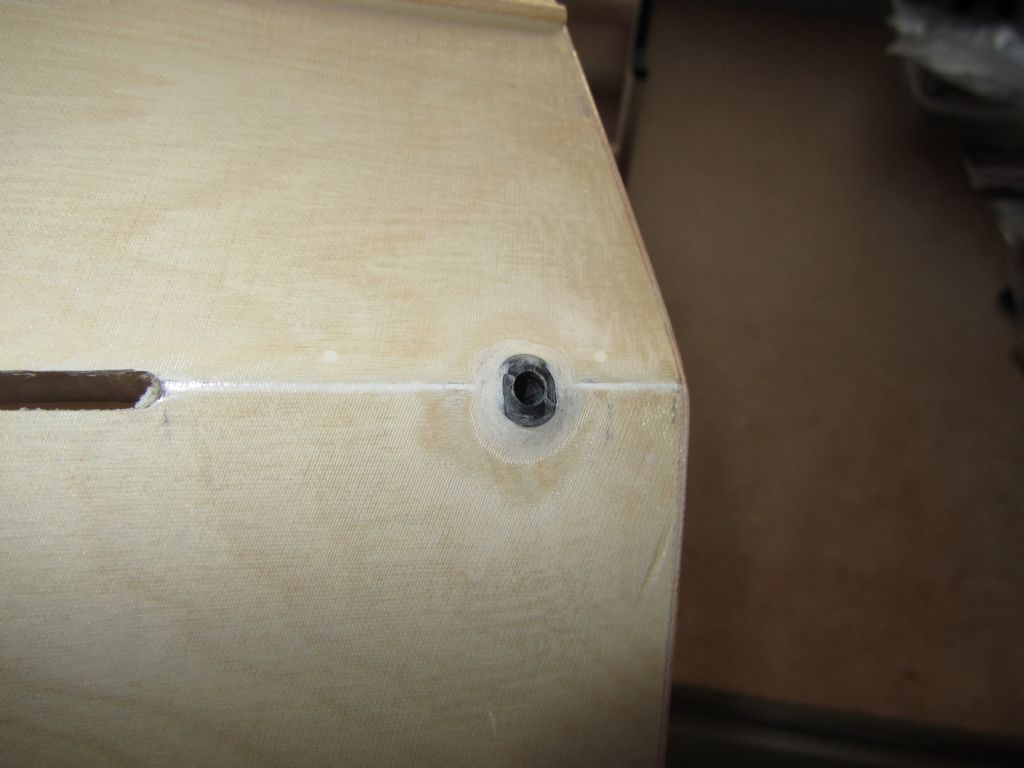

          Ready to install the prop shaft and motor mount now but delayed as had to order a 4/5mm coupling and a solid alignment coupling. I've fitted the rudder tube though. I mentioned before that when drilling the hole for the tube it went off centre and at a slight angle and so I had to set to with a file with the result that the hole was now oversize and the tube a sloppy fit. I ordered some Deluxe Materials Eze Epoxy Putty and it was just the job for holding the tube in the correct position, having wrapped a strip around the tube and pushing into position, and for fairing in between the tube and the hull. I had to do this as I filed a flat across the pronounced vee to provide a good bed for the base of the tube and there is always going to be gaps unless you've got a pretty much flat keel.
          Once the putty had gone off, it says 10 – 15 mins but I left it an hour, I removed the securing nut and pressed some putty down the hole and around the tube inside the hull and refitted the nut whilst the putty sets hard.

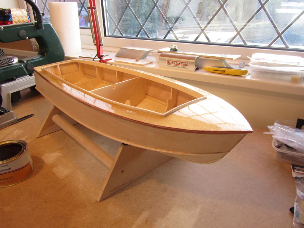

          When I fitted the birch ply deck I gave it a couple of coats of varnish to protect from marks and knocks. Having fitted the mahogany rubbing strips a little while ago and now sanded them to a rounder profile I thought I'd apply some more varnish. The varnish used is International Paints Schooner and on the birch ply gives a lovely honey colour which is similar to the full sized boats. I know the high gloss finish isn't though but like many I love the look of gloss varnish against a painted hull etc. so thought I'd go for that look on this model.
          Rudder tube installed
          More varnish

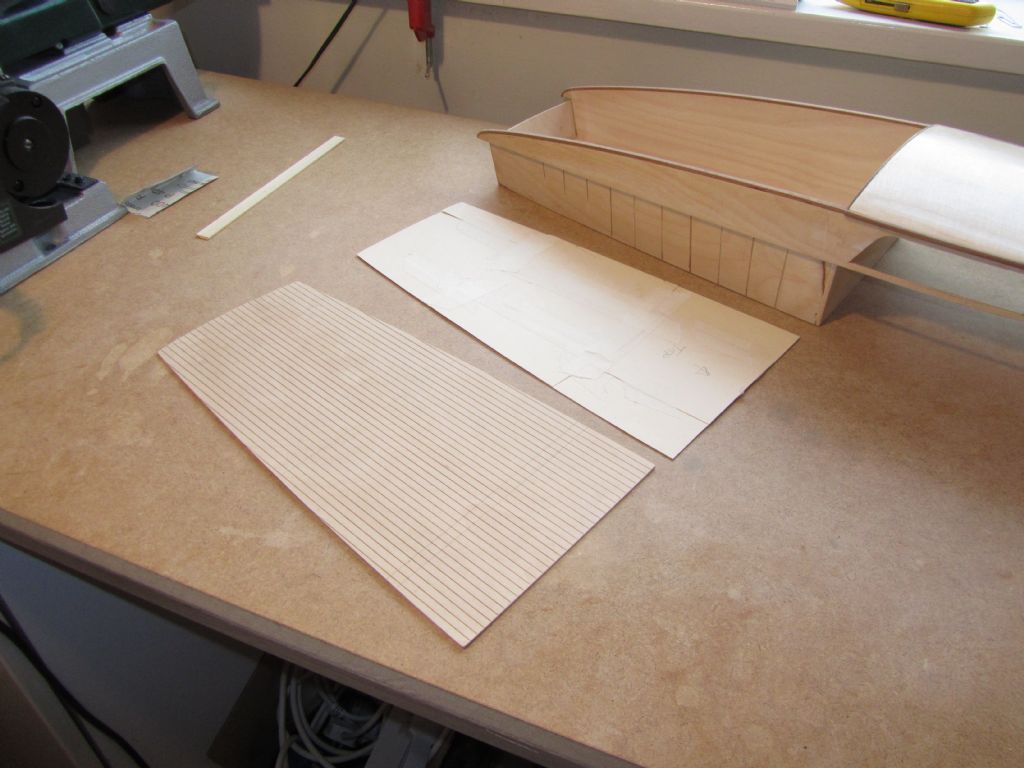

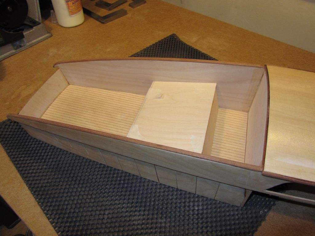

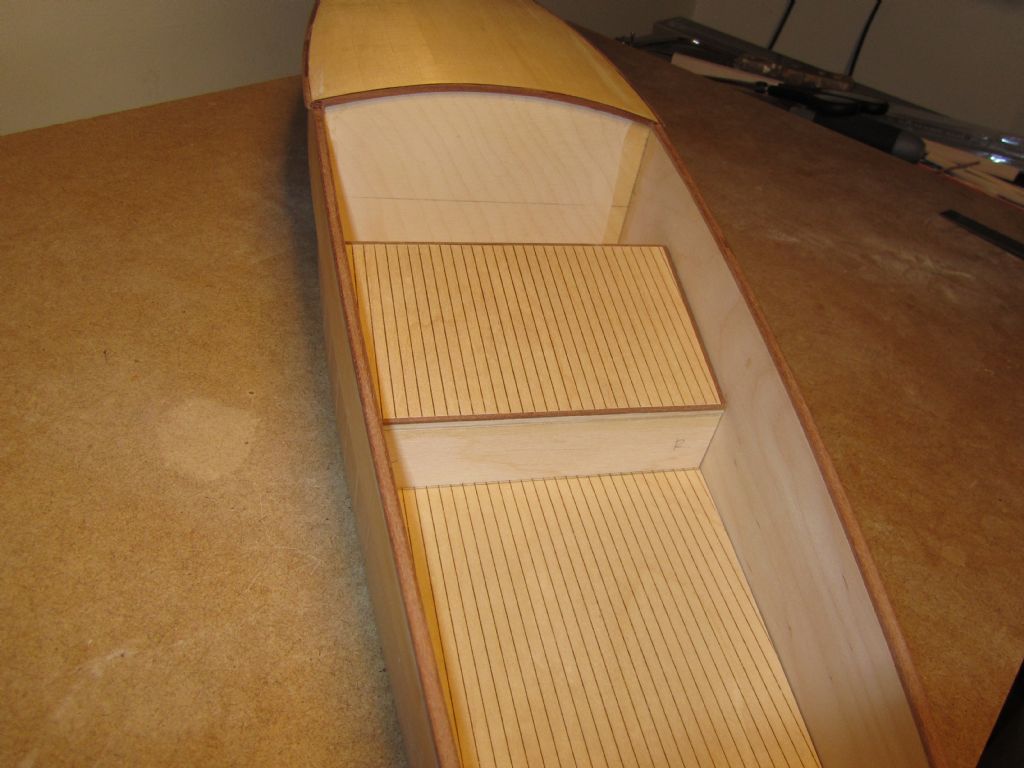

            Parts for the prop shaft have arrived now but thought I'd do some work on the cockpit area. I bought some laser etched planking from SLEC a while ago in readiness for this.
            First I made a card template of the floor and then traced around this onto the planking ply, selecting an area where the grain isn't too prominent, and then cut to size with the scroll saw and sanded with the trusty PermaGrit block. After a little work it was an almost perfect fit – pity that quite a bit of it is going to be covered by the engine cover! Then partly with reference to my drawing and partly to photos of full sized boats I sketched out and dimensioned the engine cover and then drew on ply to give the front, back and top. Again these were cut to size with the scroll saw and PermaGrit. A timber was then glued to the planking followed by the rear of the cover. The rest of the boxing was then dry assembled. The boxing certainly breaks up the long cockpit and gives it better proportion.

              Hi.Chris, both boats looking good, I do like the high gloss finish on the deck, even if it is not typical of the prototype.

                  Good man Eddie. We can never have too many Faireys on here! blush
                  The gloss finish does look very good. With the other builds and future ones I shall be sticking with something more realistic, particularly the River Cruiser, with it being a one off prototype and having a painted deck.

                      Any thoughts on which Fairey you fancy building?

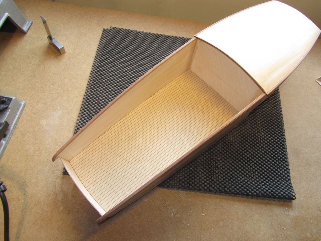

                      Today's job was to glue together the rest of the engine cover and add the "planking" to the top. The upright panels will be painted white as per some full sized examples. The planked areas will then be given a couple of coats of Schooner varnish and put to one side until the superstructure has been painted.
                      My fear is that if I glue the planked floor down that even if I mask it with Tamiya tape there is a chance that paint could bleed into the grooves of the planking and look a right mess. Not worth the risk.

                        I think it will have to be the Huntsman 28. and I agree with your thoughts that the paint would bleed into the grooves.
                        Eddie.

                          Yes, on the engine cover I'm going to have to hand paint the uprights rather than spray.

                            With the gloss you achieved on the fore deck you should be fine with a bit of hand painting.
                            I often think a bit of nicely done hand painting brings depth and character to a model that stops it looking factory made.
                            Always looking out for you next episodes and I repeat, lots of neat work to be proud of.

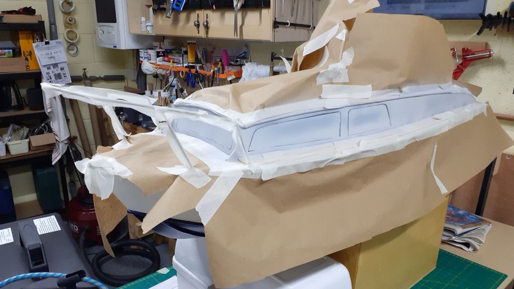

                                  Just thought you might want to see my progress …
                                  This is how it is today. Rubbed down and re-primed the cabin ready for top coat.
                                  …and this is whats under the wraps.  awaiting the Tamiya paint and 1mm clear plastic sheet for new windows.
                                  The RC access panel fits a bit tight at the moment so sits a little proud at the moment, but you get the idea.
                                  Edited By Brian White 3 on 13/04/2020 13:53:39

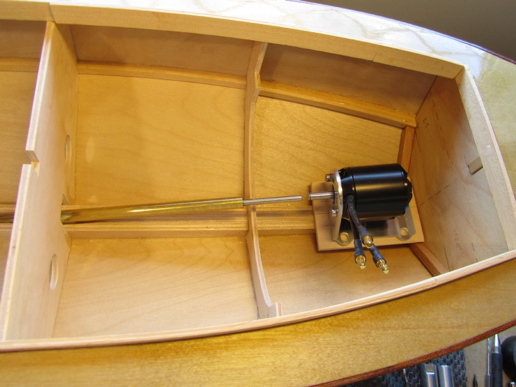

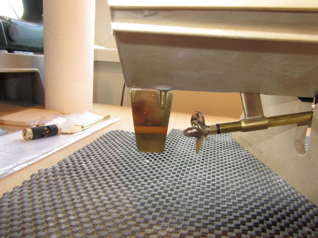

                                                  After my first ever prop shaft and motor install in the River Cruiser now to do the H28, the prop I was waiting for having arrived along with some others for existing and future builds in different dia. and thread sizes to give me options.
                                                  Having done the trial fit last year I'd forgotten that I was going to have to reduce the length of the shaft and the tube. I did however buy at the time a mini pipe cutter to do the job rather than using a hacksaw and file. I'm going to have to do some more filing to the hole through the keel as well as the prop is sitting too far from the hull.
                                                  I'm not using the UJ coupling shown in the last photo (that's the River Cruiser one) but one of the alloy and rubber sandwich type.

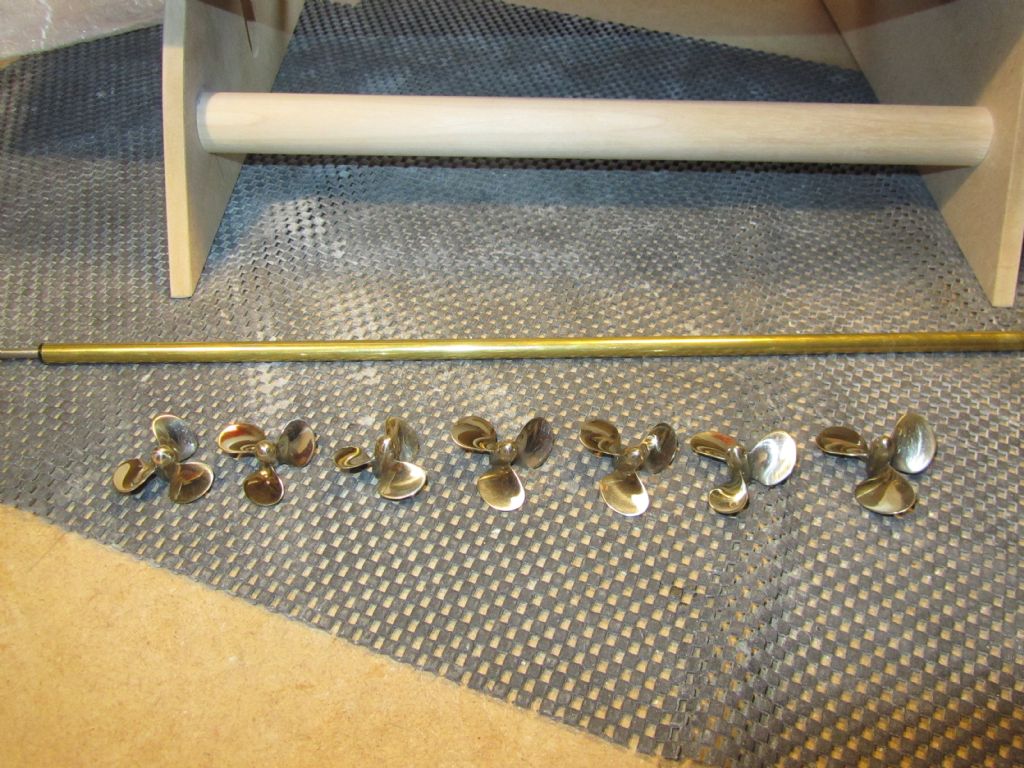

                                                    Blimey Chris have you cornered the market in brass props😄.
                                                    Eddie.
                                                    #87595
                                                      Hi Eddie
                                                      Even better, bronze.
                                                      Yes, I got a bit carried away not knowing what future supply would be like! Trouble is I bought some M5 for the Huntsman 31 and I'm going to change to an M4 prop shaft. I suppose I could wear them on a chain!
