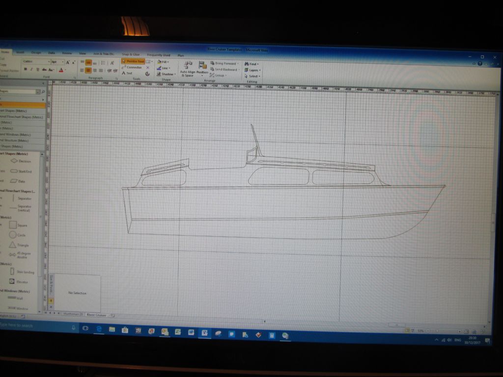

      As building of my Swordsman and commencement of building of my Huntsman 28 has been curtailed for the time being, due to my workshop (smallest bedroom!) being temporarily out of action what with it being filled with boxes etc. from the spare bedroom so that it could be used for guests over the festive season and wanting to do something model boat related I thought I'd return to the drawing board or rather the PC.
      Continuing with the Fairey theme but I wanted to do something a little different and so decided to start drawing up plans for the 23 foot river cruiser. Only one boat, the prototype, was built by Fairey and it never went into production.
      The hull was based on the Huntress but with a less deep vee as a deep vee isn't required for the more sedate and calmer river cruising and will produce less wash.
      I've attached a screen shot of the side view – I need to increase the freeboard though as it doesn't look quite right and realised that this needs to be done to compensate for the depth lost by reducing the vee as otherwise it would have been difficult to find room for the engine etc. in the full size boat.
      Once this has been done I can crack on with producing the frames etc.
      The river cruiser doesn't have the elegant lines of the seagoing Faireys due to the rather dumpy looking rear cabin but I like it because it is different and I have more of an affinity with cruisers having done quite a bit of river cruising and a trip on the Norfolk Broads in my younger days.

          Chris. I would build the thing as dimensioned by Fairey`s.
          It was a prototype, and if you alter it, it will simply become a n other Fairey barring having a larger cabin.
          #74748
            That's what I'm intending to do Ashley.
            Trouble is I only have one photograph to work from, which is at a slight angle to the side and looking slightly down.
            The freeboard in the photo is greater than in my drawing (and the Huntress), which is why I said that it didn't look quite right. And as I said, the overall depth of the hull needs to be the same to provide sufficient room for the diesel engine etc.
            I've now modified my drawing and am as happy as I can be with it. Now working on the frames etc.

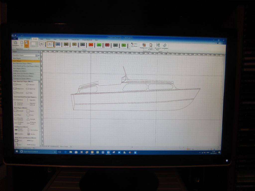

                rivercruiserupdated.jpgHi Dave
                Will do, be interesting what you find out. As it is I'm assuming that it has a rear window along the lines of the front one.
                Latest drawing attached. Still not convinced that the freeboard is deep enough. What do you reckon? The angle of the photograph obviously foreshortens it and makes it look more chunky. The line of the chine is obviously fixed as it's determined by the mould but I suppose I could increase the freeboard a little more. As said, so far I've increased the freeboard to match the reduction in the vee but it doesn't have to be. I've also dropped the angle of the deck so that it's closer to the angle of the flat part of the chine.

                      Thanks Dave – it would look better if the rear cabin had a roof that was more level but I guess the aim was to echo the line of the coaming on the Huntress and so keep a family resemblance.
                      The front cabin is longer than that of the Huntress which seems a strange decision as it gives less room for the cockpit and rear cabin. Perhaps that is why it never went further than a prototype. The longer front cabin and smaller cockpit, without the rear cabin, would have made a nice river cruiser.
                      All part of the Fairey history though and very interesting.
                      I've also got my eyes on doing a Fisherman 27 motor sailor once I've honed my model building skills!

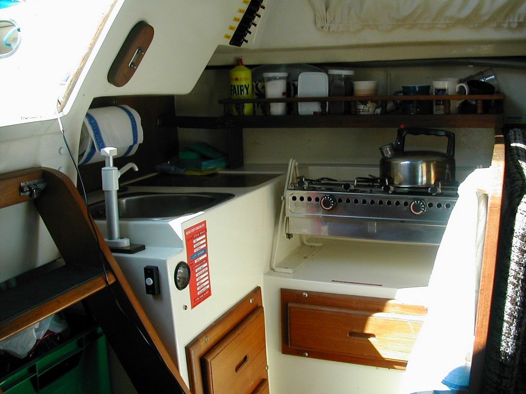

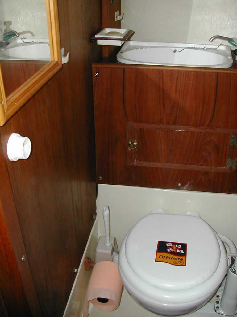

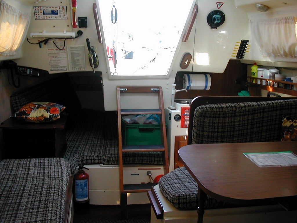

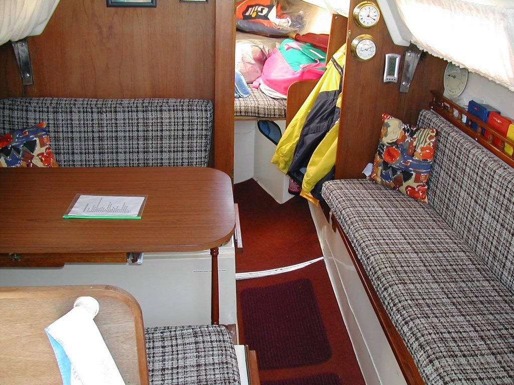

                            The provision of an aft cabin and the extension of the forward one were presumably needed to meet expectations of a river boat of that size for four berths plus cooking facilities and a toilrt compartment.
                            But I think the whole idea was misbegotten really. The Huntress was designed as a fast day boat with perhaps an occasional sleepover in a marina or other port facility. A river boat needs a fuller, deeper hull to provide adequate accommodation, headroom below and under berth storage.
                            My old Jaguar 25 was just over 24ft long, around the same length as the Huntress with a tad more extreme beam but a finer bow. The accommodation provided 5 berths at a pinch,a separate toilet, a hanging locker, galley area, decent headroom and a large cockpit. Photos below show how all this was crammed in using clever design. The dinette table converted to a double berth.
                            PS: It was such an efficient design that it had room for a Fairey in the galley as you can see….
                            Edited By Colin Bishop on 31/12/2017 11:18:11

                              Dave – evidently tapered blocks were laid in the bottom of the mould to reduce the dead rise. Increasing the height of the hull sides would have been easy enough.
                              Initially I thought that the Huntress cabin had just been grafted on but saw that the front side window was longer. So to get the relative positions of the cabins and cockpit etc. I copied the photo, positioned vertical lines on them and then stretched the photo and lines to fit the hull. This confirmed that the front cabin was longer and I reckon the drawing looks about right.
                              When you post the photo we can see what folks think.
                              So that was the superstructure sorted but as I said the freeboard needed increasing. Looking again this morning I reckon it still needs increasing a little more, not too much, so am doing that.
                              Performance wise, yes I'm going to use a pretty small motor and not worry too much about building light! Not a boat for Harry methinks!
