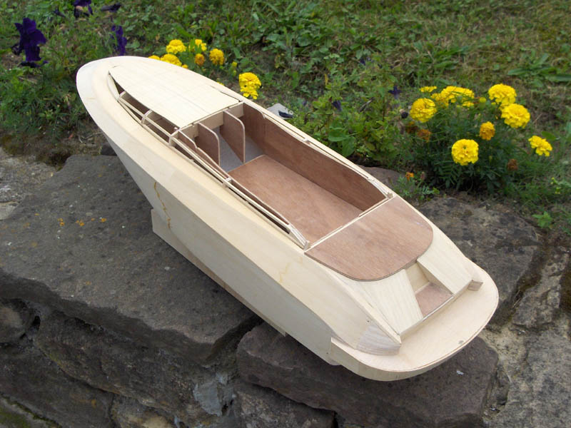

      I m show you the built of my second boat. It’s an express cruiser of 45 feets. I m inspire of the spider of Cantieri di sarnico. I m made it with my son Lucien.
      After a modeling on delftship I drawing on autocad alls plans of pieces, kell, and sections in first.
      I built keel upward. There re 7 sections in plywood in thickness 5 mm. The keel is made with 2 pieces of plywood 5 mm. Notches are cut for piece of wood 5×5 mm for consolider.
      Bye
      Philippe

          Hello, the continuation
          Here is now the pose of pieces 5×5 mm. There re only 4. Two for the corners and two for the deck plate.
          The floor of bath is stiked behind the first section with fobs.
          For the bow, I could not to arch the piece. It’s too little. Then I cutted plywood with the good shape. I added fobs in same material.

            Hello every body
            Now that the skeleton is very stiff, I pursue with the pose of hull. There re 4 boards. 2 for bottoms and 2 for sides. I m begin with bottoms and after sides
            First botton
            Second botton
            The pose of sides is more dificulte because the bow is very waisted. I m put in water the wood for soften it
            Before of to stick top of hull Lucien sand that who exceed.
            Bye

                Hello
                Now, we are going to put other pieces of wood 5×5 for access to the front of boat. There is 4. We added also a section in alft of the floor of bath.
                The little board stick on. We used paper size for drawing it correctly.

                  hello
                  Now I m stick pieces of access to  the bow. There re built in 4 parts. It’s board of samba in tickness 2 mm
                  Good night

                    Hello
                    Then I m start the bath board. It s easy to make. 2 boards, up and down and between fobs cut not parallel
                    The suburd is dress with a lot of pieces of wood and after sanded
                    Under I have stick a board the aesthetics
                    Bye

                      Hi guys
                      This is the continuation of stern
                      Pose of the base of the staircase
                      stick flask of staircaise
                      beginning of pose of stern
                      Bye
                      Philippe

                        hi guys
                        now I begin the cockpit . I start by floor and faces. After I cut pieces of roof. And for finish I start the pose of board
                        stick of all pieces of cockpit and roof
                        stick of wood rod
                        Pose of the biggest board of roof
                        Practically all the boat is equipped
                        Bye
                        Philippe
