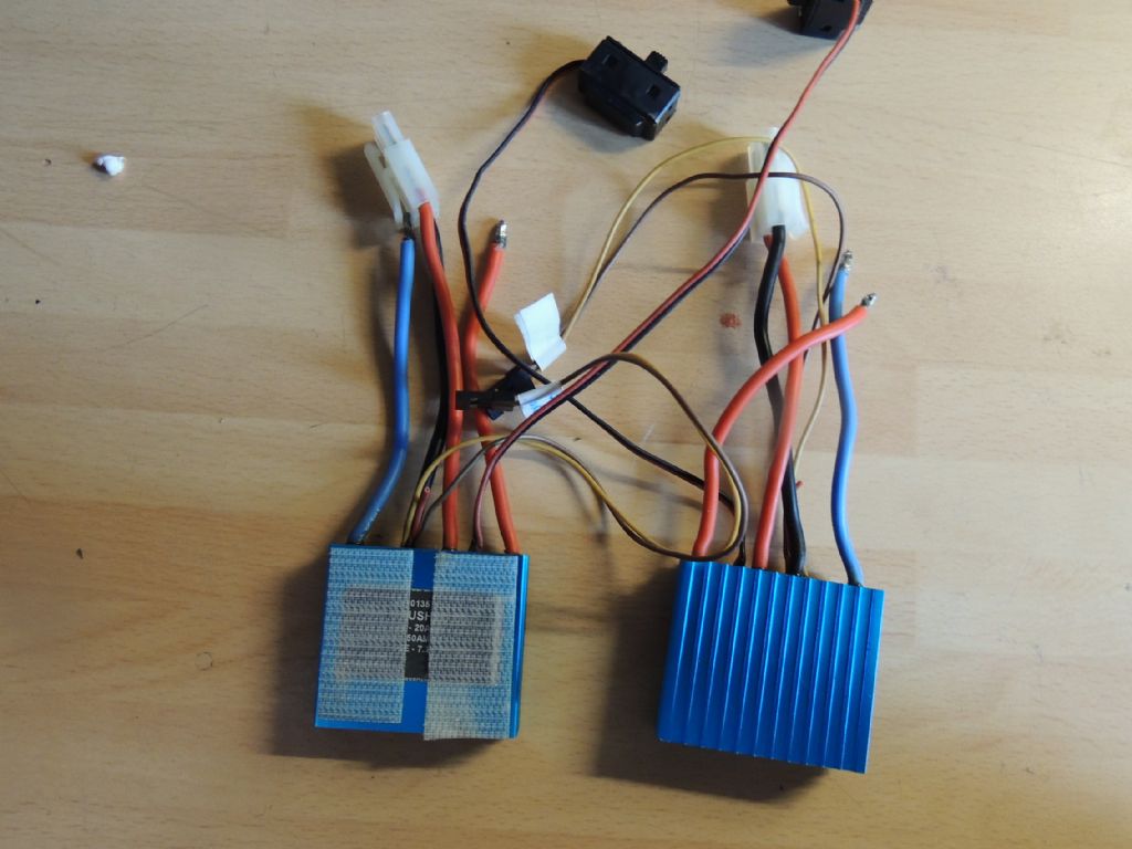

      HI there.
      I Hope someone can tell what these pair of esc,s are just pulled them out of my Graupner tito neri.
      I cant read though the velcro… and if I try to peel the velcro back its pulling the info label of.
      but all I can read is 20amp

        mark69
          @mark69
          Hi Graeme that looks like a JPerkins ESC I’ve been looking T these just now when l remembered your post..mark

          Graeme Linskey
            @graemelinskey75588
            Hi Mark
            yes your right its the 50amp version shame it only takes 12v I want to run my graupner 900 bb tourqe motors at a higher voltage any other decent esc marine you could or anyone recommend?

            shipwright
              @shipwright
              Mtroniks manufacture several ESC's for brushed motors for operating in range 12 v to 24 v . Whilst relatively expensive I have found their ESC's reliable (though I only use ESC's rated up to 12 v). Mtroniks brushless ESC's only available in 12 v rating.
              #64580
                Designed specifically for the job. I've run them at 32A and 34v – didn't even get warm.
