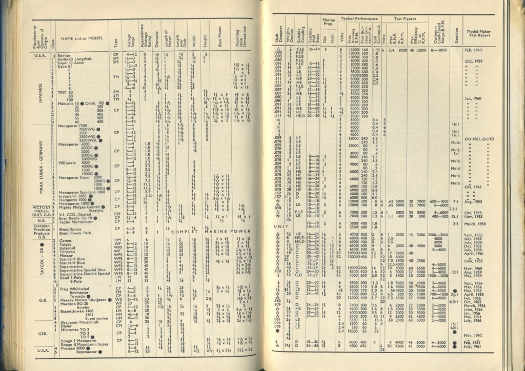

                        Came across this old list from the 1963 Model Maker Annual which may still be of use.
                        Dave, note the Bongo unit information near the bottom. Didn't you build a model which was originally powered by one of these?
