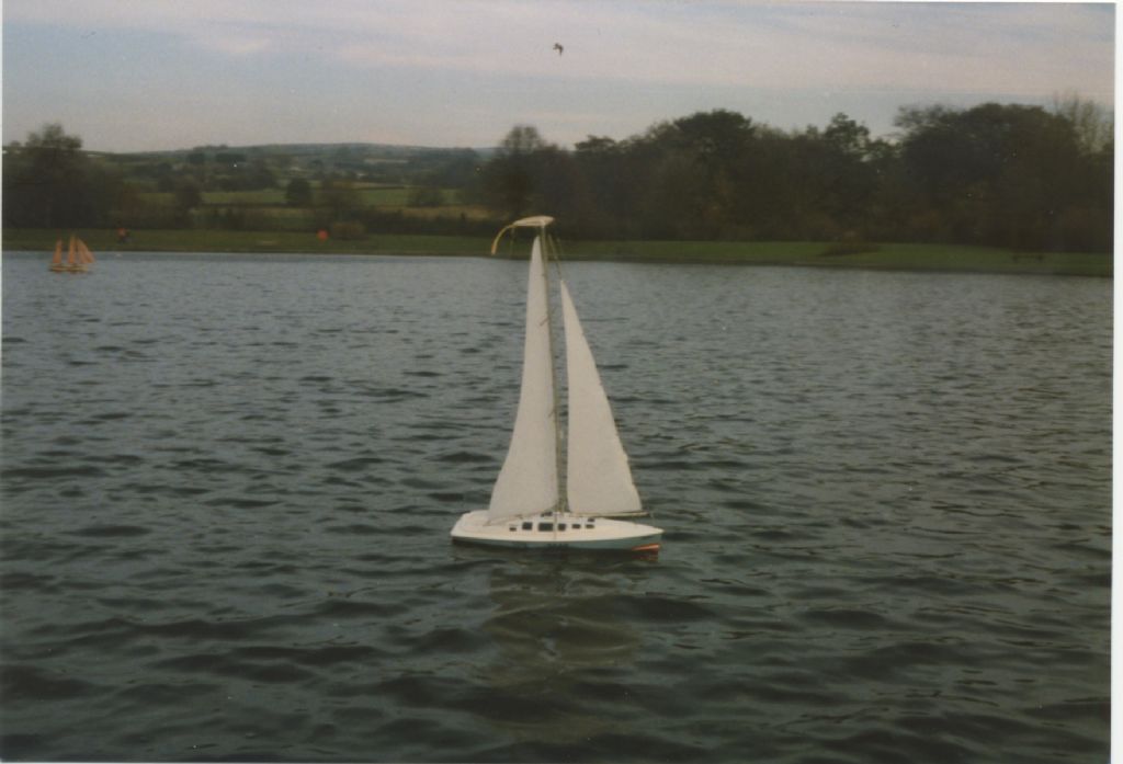

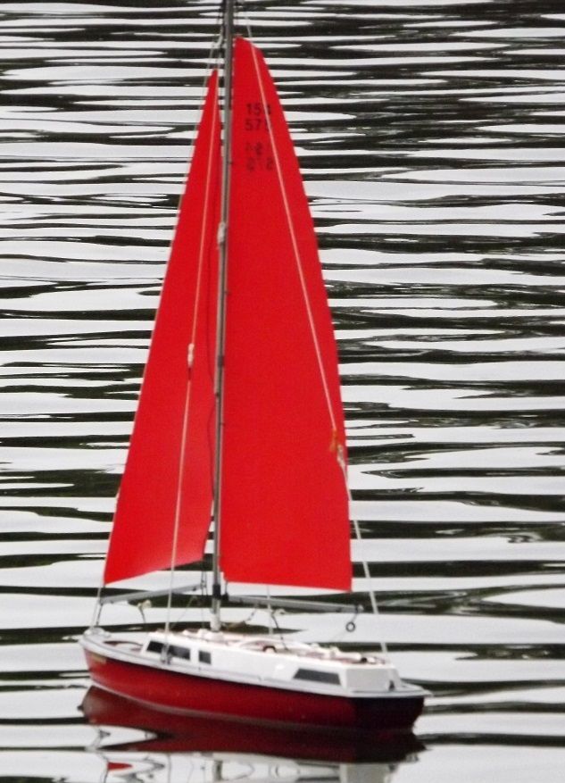

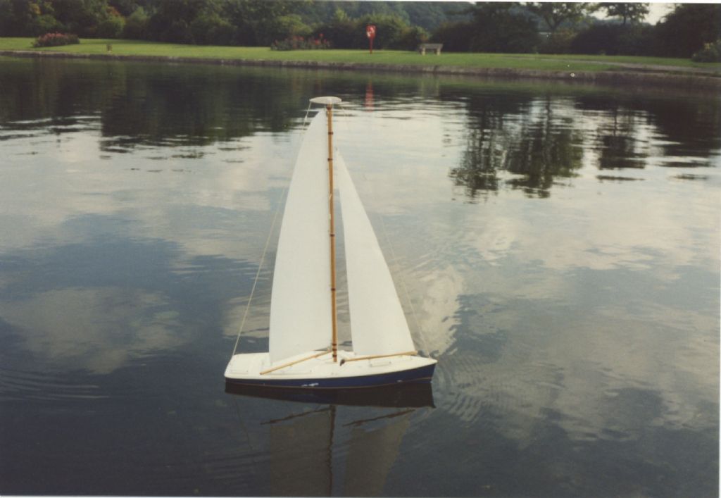

                  #88657
                    There was a good photograph of a 575 on the cover of Vic Smeed's 1979 book Model Ships. I like the Model Boats decal (or sticker) on this yacht.
                    Never had a 575, but really enjoyed my two 590 class models. The first, back in 1991 was the basic 590 and the second, which I had in 1996 was the 590s. They were a pleasure to sail. Wonder what ever happened to them.
                    Tony
