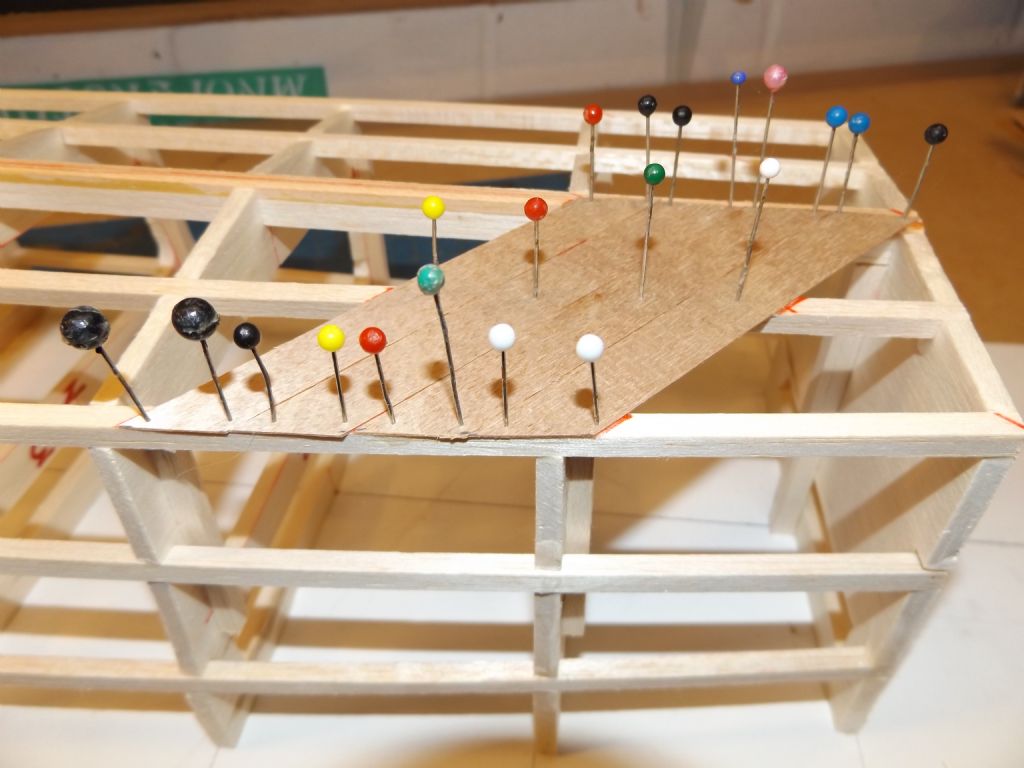

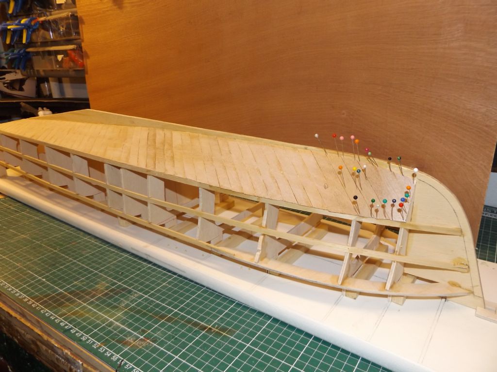

            wales & mtb decjan 16 006.jpgHi Paul,
            Here is the first layer of a double planked hull, with the planks pinned in place, a pair of pliers helps you push the pin through the 1/64th ply in these cases. Upper photo MTB 71, Lower White Marlin.
