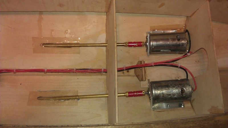

                                        Sorry guys, I let this post slowly die! I got part way through the project and a new project reared its head (rally car build) >>
                                        Thought I'd post where I got to as I plan to pick it up again in the next couple of weeks>>
                                        A few pics of the build up to last year after speaking with everyone:
                                        >imag0063.jpg>
                                        A short grainy video of its maiden voyage, please ignore the state of the hull … this was on 24v>>
                                        http://www.youtube.com/watch?v=KvOMlosMWsI&feature=youtu.be
                                        Hope to start updating again soon.
