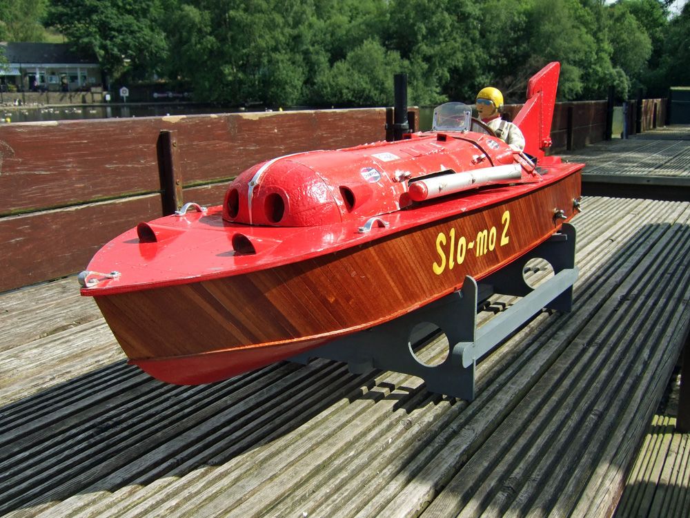

                Very helpful article and discussion thread. However, I would still appreciate expert advice on a motor/speed controller/prop combination for my twin proped Amati Riva Acquarama model, still in it's early stages of contruction.
                I used a Turnigy D3536-6 1250kv brushless outrunner with a 100amp HobbyKing reversible car speed controller on my 34" Vosper fire tender (maybe a bit of overkill with the ESC but I had started with a 45 amp unit and this was prone to cutting out – overheat protection?). With a 40mm twin bladed Graupner prop, this boat goes well.
                I am temped to go for a similar set up for the Riva which is about the same length but maybe quite a bit heavier. It would look much like the kit in Bob's Slo-mo-2. I want the boat to plane well but not to leap out of the water. I have some concern over cooling as the engine room space will be more confined than in the Vosper – maybe a bit more like Slo-mo-2. The is no opportunity to introduce air ducts into the enclosed space.

                  Have looked at brushless myself, look on ebay etc for a watercooled motor mount, tihs may help, also there are watercolled mounting plates for the ESC, also helping keep things under control!!!!
                  Have you thought about inrunners with smaller props running faster???
                  Bob's Slo-Mo is quick when he is brave enough to open the power up. Proble is our lake is quite small for very fast boats, dodging ducks is a major problem as well.
