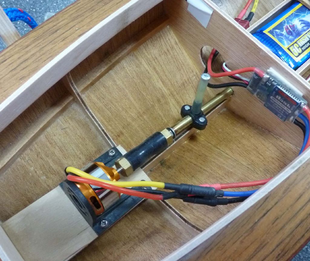

      I’ve just fitted a replacement 2435 4800kv 12t inrunner in my aero-naut Classic sports boat. It’s certainly shifts. I have the same motor I want to fit in my small Samson tug. I obviously don’t need the speed requirements. A suggestion was to fit a lower voltage battery such as 4.8v so the rpm is less. What do you think?

              Even with 4.8v you're talking about 23,000RPM. The right brushless motor would be an outrunner [for the torque needed in a tug]; nearer 480kv, and would probably cost less than a gearbox for the one you have.
              For a small tug like the Artesania Samson I'd be thinking along the lines of a small brushed motor like a 385 – or a 555 at most. Using your 4800kv inrunner would be like putting a Formula 1 engine into a quarry dumper truck.
