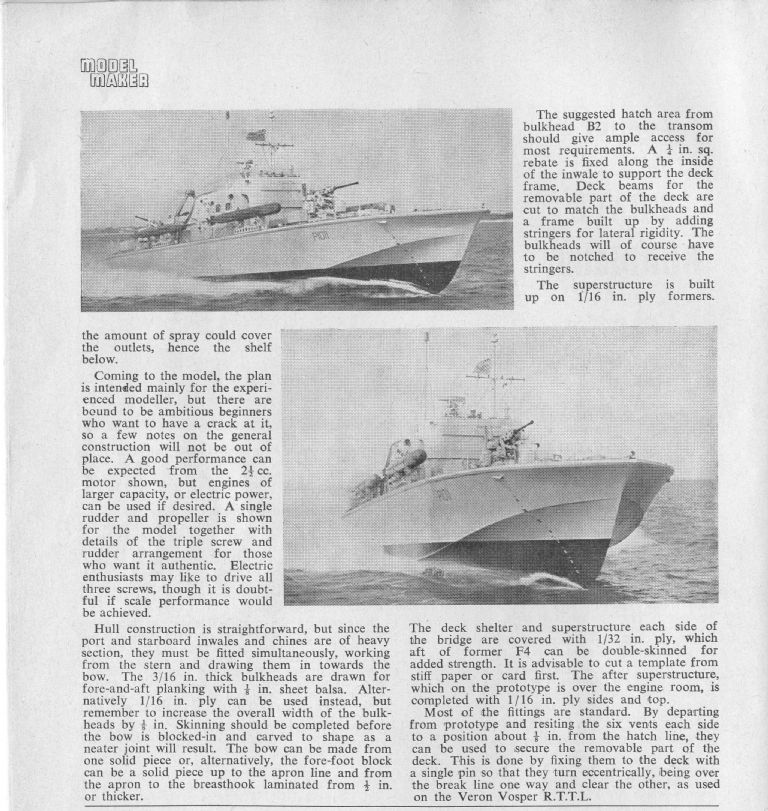

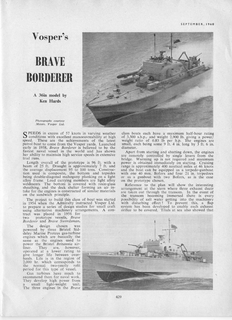

            Gary,
            I've scanned and attached the magazine item which accompanied the plan (MM609) from September 1960 Model Maker magazine. There are a few basic notes on building in the second page, obviously things have moved on since this article. To enlarge, click on the photograph and then enlarge.
            There is information on the full sized craft at the British Military Powerboat site –

                            Not really master pieces, you can always find somebody who does it better or in a different way, plenty of variety of subjects is the spice of life I find . Are you planning to double diagonal plank your hull? I recall weight is quite an issue as the stern is quite narrow. Are you building the 36" version as the article Tony posted?
