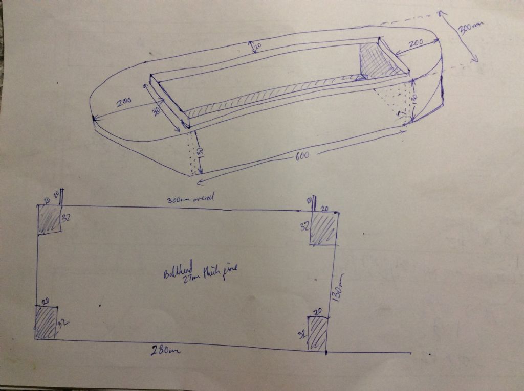

        As i started talking about this on Today’s boating but thought it better to start a thread here.
        I need a roughly 1:20 scale Thames lighter for my river tug to tow. It must be no more than 1m long or it will be a pain to fit in the car.
        I have sketched the below general layout and a scale sketch of the bulkhead cross section. The 4mm ply offcuts I have are a bit floppy, but I found some 20x32mm batten in the garage that will make nice longitudinal stiffeners and some other hefty bits of pine for the bulkheads each end of the central box.
        Is the cross section feasible or is it too shallow? All the numbers are millimetres.

          #78113

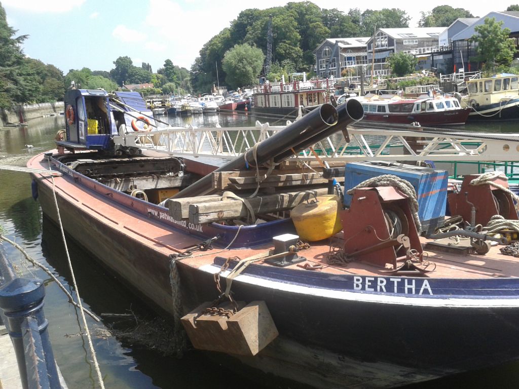

            Hi Noel,
            I couldn't open your sketch, but this is the drawing I based my barge on, they are normally 80ft long approx.

              That's better.  Not sure what happened to the link there.
              Thank you Ray that picture of yours looks generally the same proportions.  My only concern with mine was that it was not deep enough for its given beam, but I think your proves I'm probably OK there.
              Only other question is should it be narrower at the bilges than the deck?  Would be a bit easier to make if the cross section is rectangular.

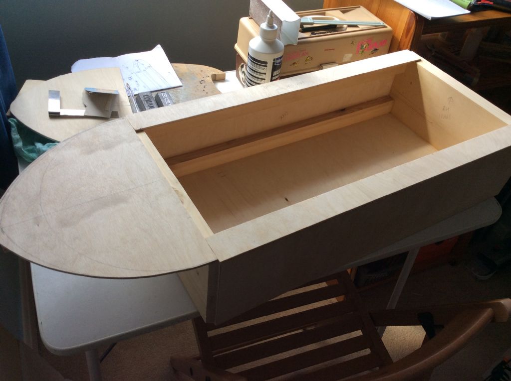

                                  After being on holiday and then gathering materials I have now made some progress.
                                  Ashley has very kindly spent some time cutting my plywood and other parts to size on his bandsaw – so I have nice square consistent edges. Thank you Ashley! This has made it glue together very easily so far.
                                  I have the basic box and the foredeck in place. It is very robust indeed. Next is to add a stiffener for the bow to fit to and then template the flat front and wraparound skin for the bow.

                                  #78658
                                    Noel. I have an idea on how to make the template for the bow pieces very easily. First I think you need that stiffener, and then the other bow bits can be made.
                                    Be there Sunday, or call me tomorrow am, wont take 5 mins to make the stiffeners and explain about the template bit.

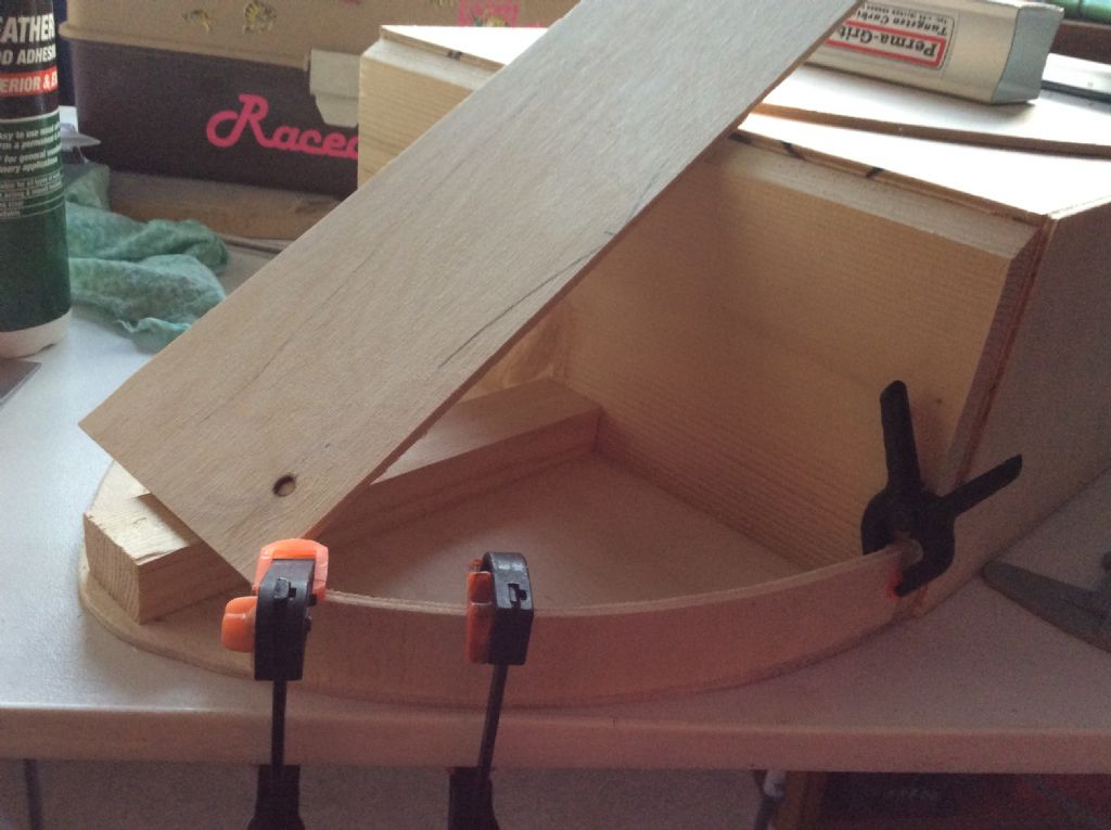

                                    Noel
                                      @noel26080

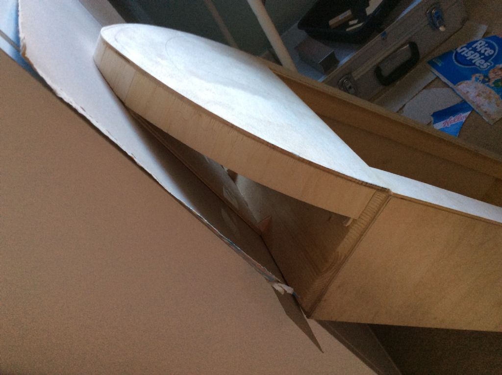

                                      ae324d24-bd5f-4a40-9d72-bec0dfbdce68.jpegI think I will be there Sunday yes.
                                      This is what I have so far. There is a batten to support the tow bollard that will be fitted on the foredeck.
                                      Then I have added a strip of ply glued to the curve of the bow, to give the skin ply something to glue to. The bow stiffener is to be cut to length then glued in. Once that’s in I can template with cardboard.
                                      What you think?
                                      #78808
                                      Noel
                                        @noel26080

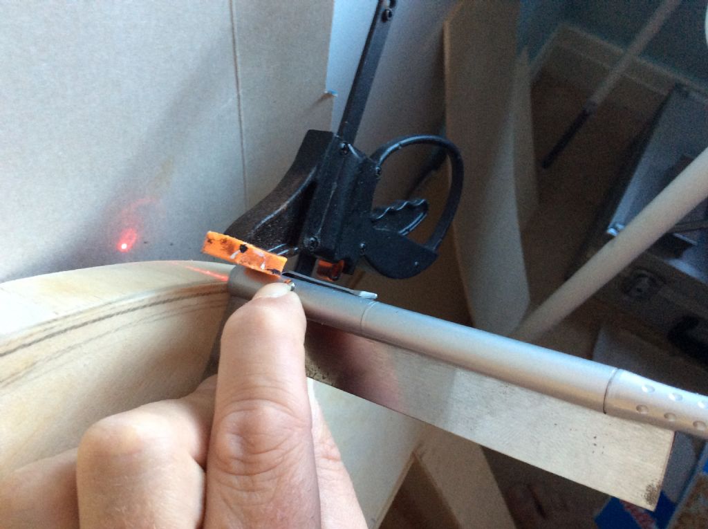

                                        Now done prepared to template the bow front:
                                        Could not work out how to run a pencil round the edge and keep it perpendicular to the foredeck and the right length as it worked its way round the curve. So I clamped a laser pointer to my square and then shone that just over the edge. I could then mark out a line of dots on the cardboard, which I can cut to!

                                          Clever stuff Noel. Where would we be without some of these modern techie gismos!

                                          Noel
                                            @noel26080
                                            It is also somewhat cheaper than a professional laser square or level!

                                              I suggested simply drilling a hole in a small block of wood to take a pencil and running that around the top, but OH NO…Noel has gone all high-tec….

                                              #78844
                                              Noel
                                                @noel26080
                                                Its basically the same idea as the pencil through a block of wood, but solves the problem of the pencil thickness.

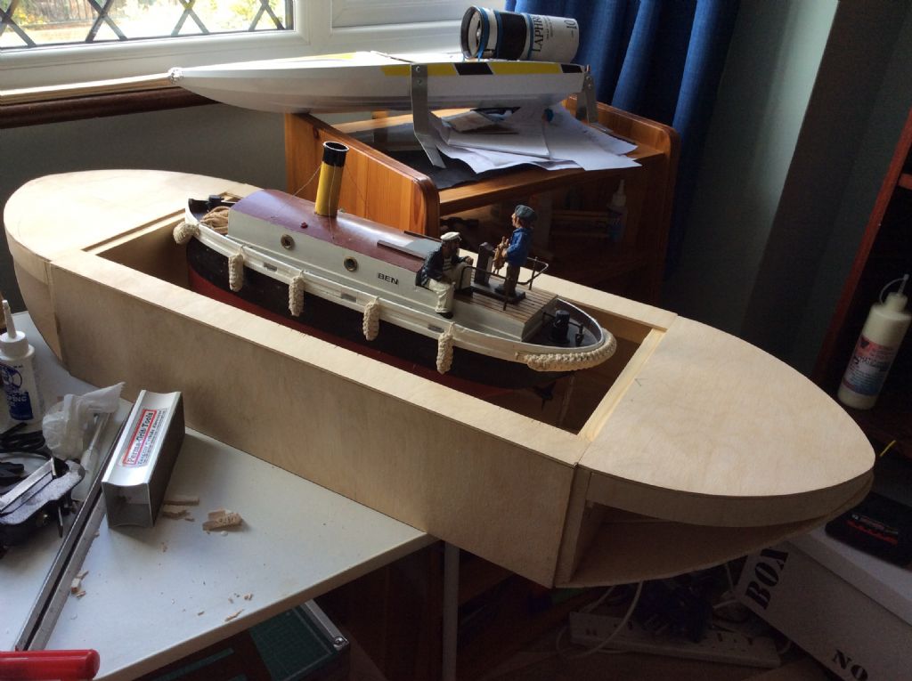

                                                #78990
                                                Noel
                                                  @noel26080

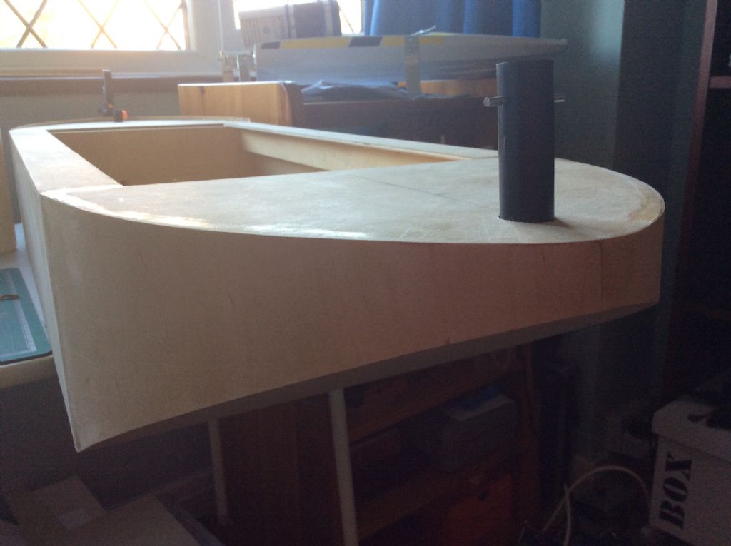

                                                  Getting on with this. Need to sand the stern section to final shape, then ready for skinning with 0.8mm ply.
                                                  Added a big bit of pine plank to act as a keel inside to stiffen it as it’s going to have to support a lot of ballast.
                                                  Tug fits inside nicely for storage. But it is big!
                                                  #78994

                                                    #79082
                                                    Noel
                                                      @noel26080
                                                      Good point, I think to start it will have a load of real shingle to see how it sits. Thing is it’s going to be a fair mass to tow.
                                                      Now have the plywood round bow and stern so it is looking more finished now. Coming and a few bollards on deck then I will seal it.
