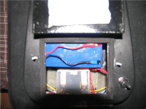

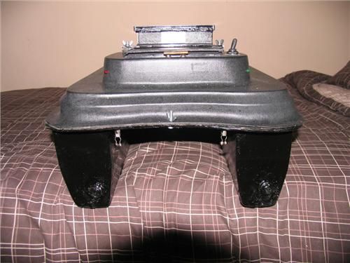

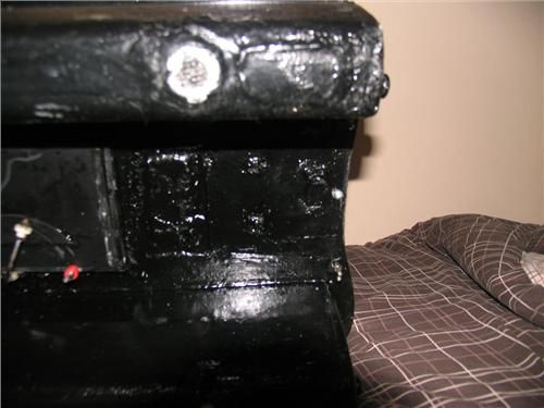

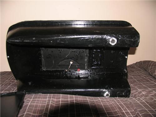

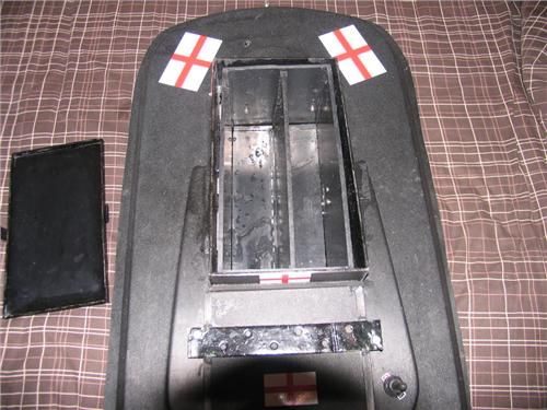

                          hi ashley yes i think two rudders would be the way i will try and post pics with this so that position can be advised ive done pics where do you think they should go would it be possible to use just one on left or right hand side so i can tighten turn circle a bit
                          #12764
                            Steve…hhhmmmm Nice to see a good honest working boat,  If ever there was a model boat designed for one thing only (function), bait boats have to be it !  Twin rudders would be the only way to go to achieve any meaningful increase in manoeverability, but I can see that there would be a bit of difficulty in doing this. The rudder pivot would have to be external (giving a possible snagging problem), and the linkages to them fed back into the boat through the hull (as I assume the entire top lifts off?).. by the looks of it all the bits and bobs are already in the back of the hull so any internal linkages would have to go across all this, or you would have to be creative and use aircraft-style sleeved wires to control the rudders from a servo, for instance, at the front of the craft. Bearing in mind that robustness in the field has to be a no1 goal (after all you are there for the fishing, and not spend time faffing around with boats) I could see that it may be best to leave well alone ? Ashley

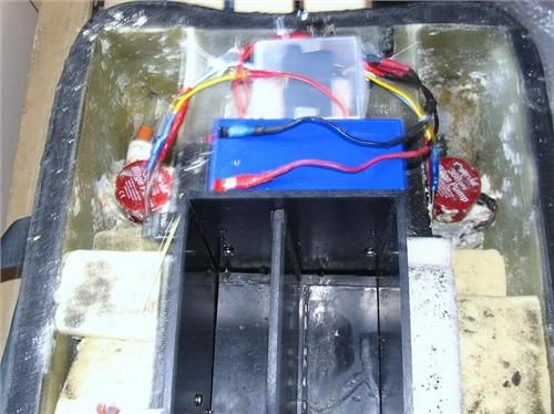

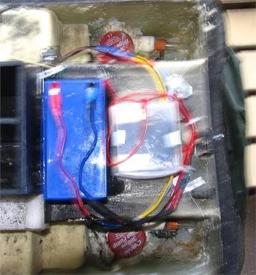

                              hi ashley now you know why i go fishing and not making model boats or anything for that matter  !!! anyway ime sort of having fun with this project with all your help its ok ime trying to upload some internal pics of boat  i cant upload files too big i can send via e mail if you like

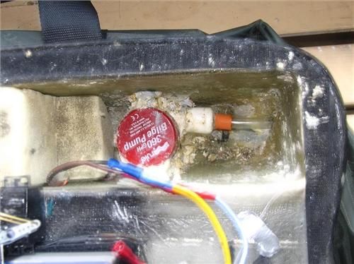

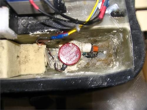

                                hi ashley just managed it hope they help there is a bit of room i could put 1 servo by battery and use just 1 rudder that side or use link for two or two servos 1 each side not sure about channels could i use the link/dual feature as in aeroplane rudder.aerolons or am i talking b===== my head hurts

                                  Steve. One servo linked to two rudders would be easiest, it looks like you have the room. Also, unless the rudder posts are inside the hull, you will need to get rudder pivots on the outside (easy enough) but them an arm to operate the rudder and also a rod likage from inside to the outside (a bit more tricky), and waterproof this to boot..using rubber bellows as per submarine practice.This will leave a lot of snaggy things on the stern of the boat….? One rudder only might enhance the turning performance enough, especially if it were oversize, but you would need to experiment there, and if it was no good, convert to two. How about a rudder/rudders at the front instead???  Should have more room at the bows. I assume you have a free channel on your transmitter? Oddly I have no exprience of anything other than 2 channel gear, and dont know what sort of control on a servo you have with the secondary channels… anyone? Ashley
