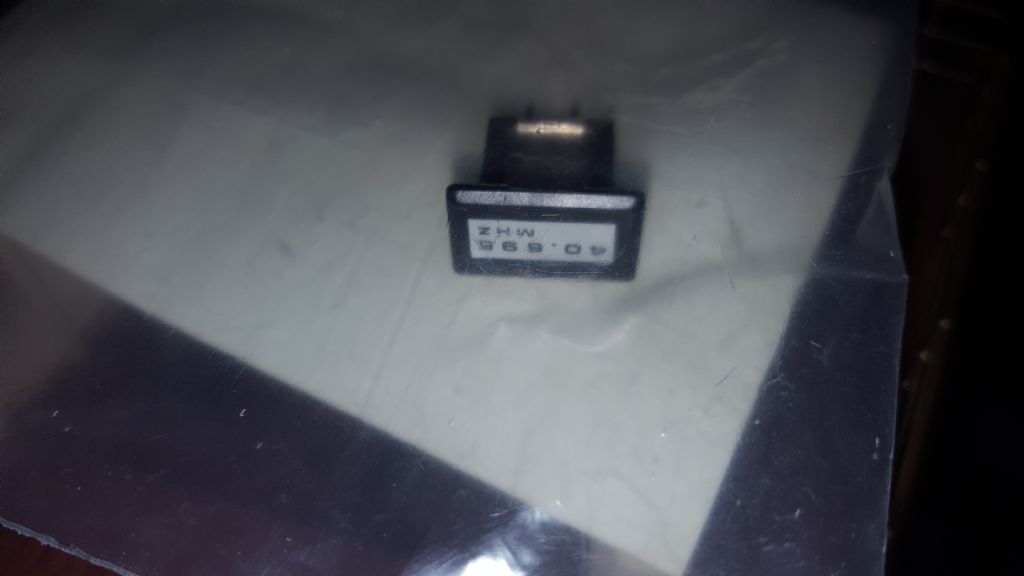

          The "small receiver gadget" is a 40MHz crystal. If there was no radio with the model, it won't be much use.

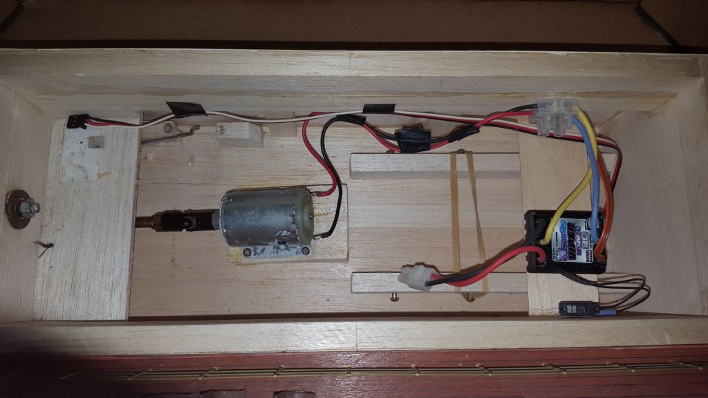

          To have a guess at the battery required, measure the tray, then have a look in Maplins battery section to see what fits. Probably an SLA, at a guess a 6 volt type.

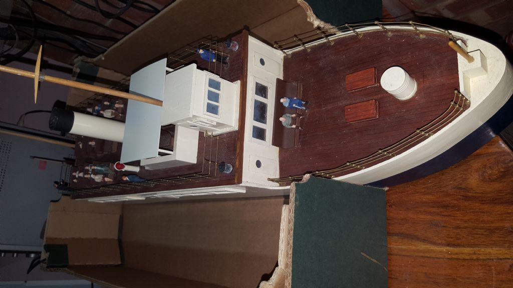

          Type/name? Looks like a ferry, to get a better idea as to its full identity, a couple of full model images would help, side or 3/4. Maybe with something to relate to to give an idea of size.

            Thank you for the reply. i guess i need another crystal plus a radio? i will try up load another pic. thanks again.

              Looking at the connector on the speed controller (the bit with 'MTroniks' on it), plus the elastic band, I would say the battery was most probably a 6v NiMH pack like this one ……………

                Hi Steve, I agree with all that has been said, but have a little extra info for you. Regarding the rudder, there should be a gadget called a servo connected to it, which would plug into a receiver. This will give you steering. There is probably another part of the model at or near the stern that comes off to give access to it. The models quality, from what I can see is typical of what most club modelers make, its a normal model boat. The value won't be high, it's surprising how little most models are worth.

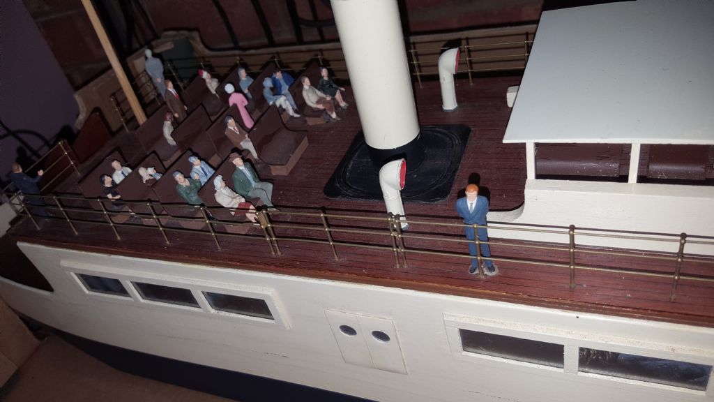

                  ​The passengers I recognise as being ready painted types from china/e-bay wot are intended for model railway use! I have the same sets on my converted LCM/ferry.

                    the model looks quite familiar, I am sure it may come from Glynn G stables or even from Marine Modelling plans; if you have a look at pics that show the internals – the top left hand corner shows evidence of a servo mounting and what looks like a tiller bar or a push rod to the rudder. If you move this bar back and forwards, does the rudder move? I will have a search for more information – I will be back

                      Blimey John, eyes of an eagle you've got, I presume those are servo mounting blocks next to the linkage.
                      So Steve, you will need a 2.4 gig transmitter and receiver ( I.e normal) and a servo to steer the boat. Plus battery and charger as recommended by my esteemed colleagues. It's still worth checking to see if there is any access to the rudder post from inside, for maintenance.

                        1) i take it the battery plugs into the white connector with black and red wires from the "viper marine thingy"
                        2) i guess the servo is like a motor? and this would be stuck above the rudder arm and connected to it? i take it the servo plugs into the small black thing that looks like a phone sim card (3 wires)? just above the rudder arm
                        3)does battery voltage not need to match motor voltage? (theres no writing on it)
                        4) if all above is correct and i still need a transmiter and receiver (i guess the receiver is the joypad/remote control) where would the transmitter plug into as theres no connections left?
                        apoligies if these are stupid questions
                        chas i managed to lift the rear deck and there is only linkage for rudder. nothing else

                          ive added 2 new pics – the boat is 30 inches
