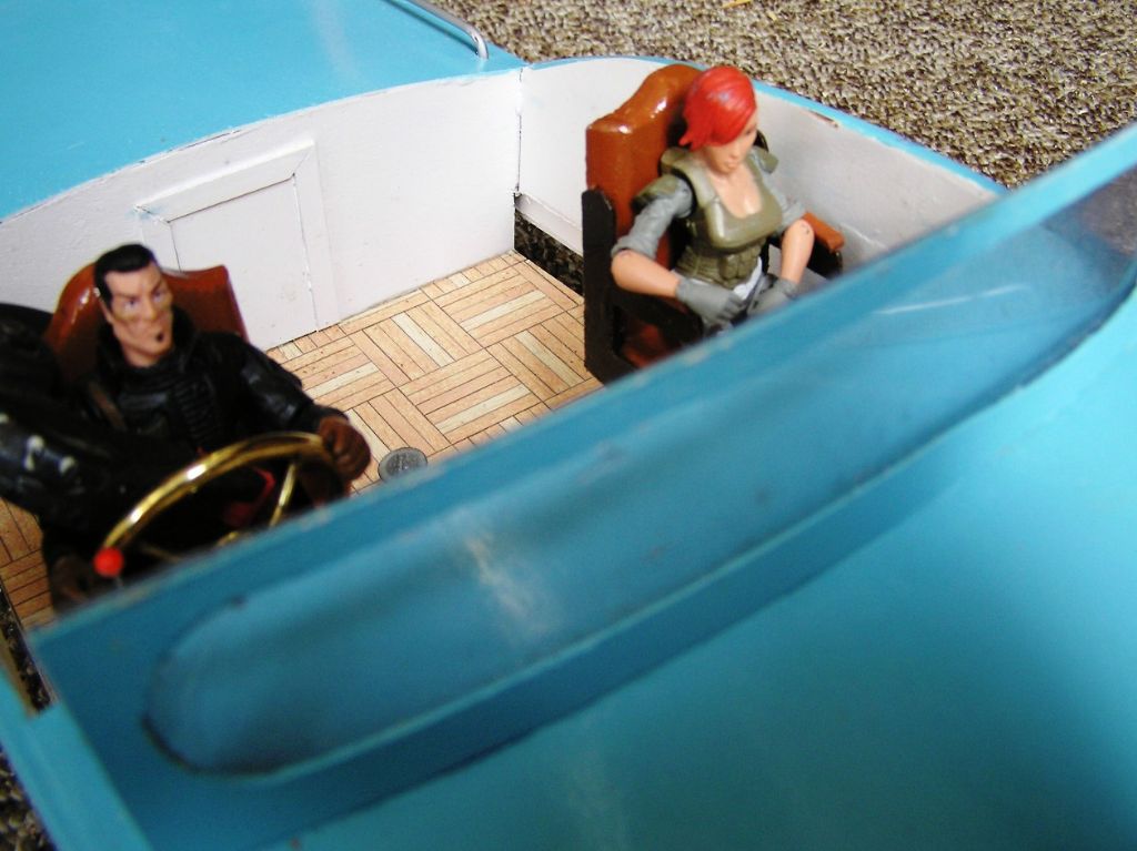

                  I have the cockpit seats out of the boat and remodelling these fit two 100mm figures onto the seats.

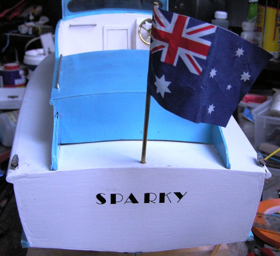

                  I fitted a big AUSSIE flag to the stern cut from a silly umbrella hat.
                  I have a few props to test on the boat, but, I am very happy with the start setup.
                  #67112

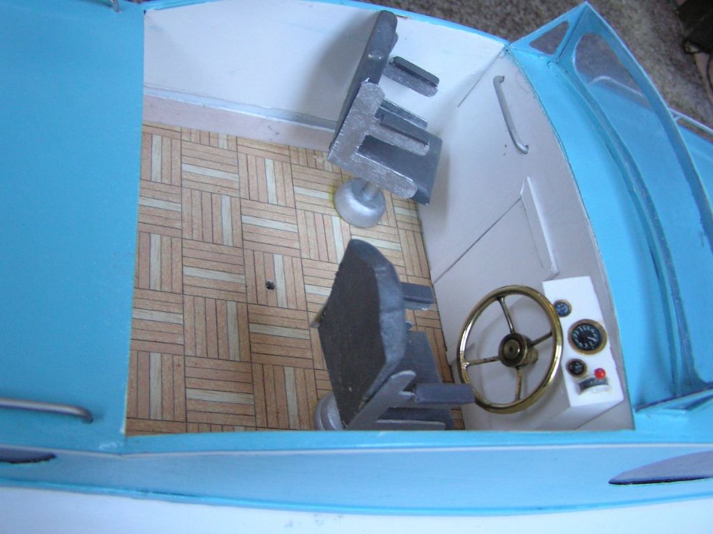

                    remodel seats with crew.jpgHi All
                    Finished remodelling the seats added the crew(hang on for dear life) and rename the boat SPARKY.
                    This was our second last Pom dog's name.
                    I tested a 42mm 2 blade prop with on increase in speed, so plan B a 3 blade 37mm or a 45mm 2 blade.
                    I missed a duck by 6 inches today, the bugger pulled out the flaps and boot scooted up into the air.

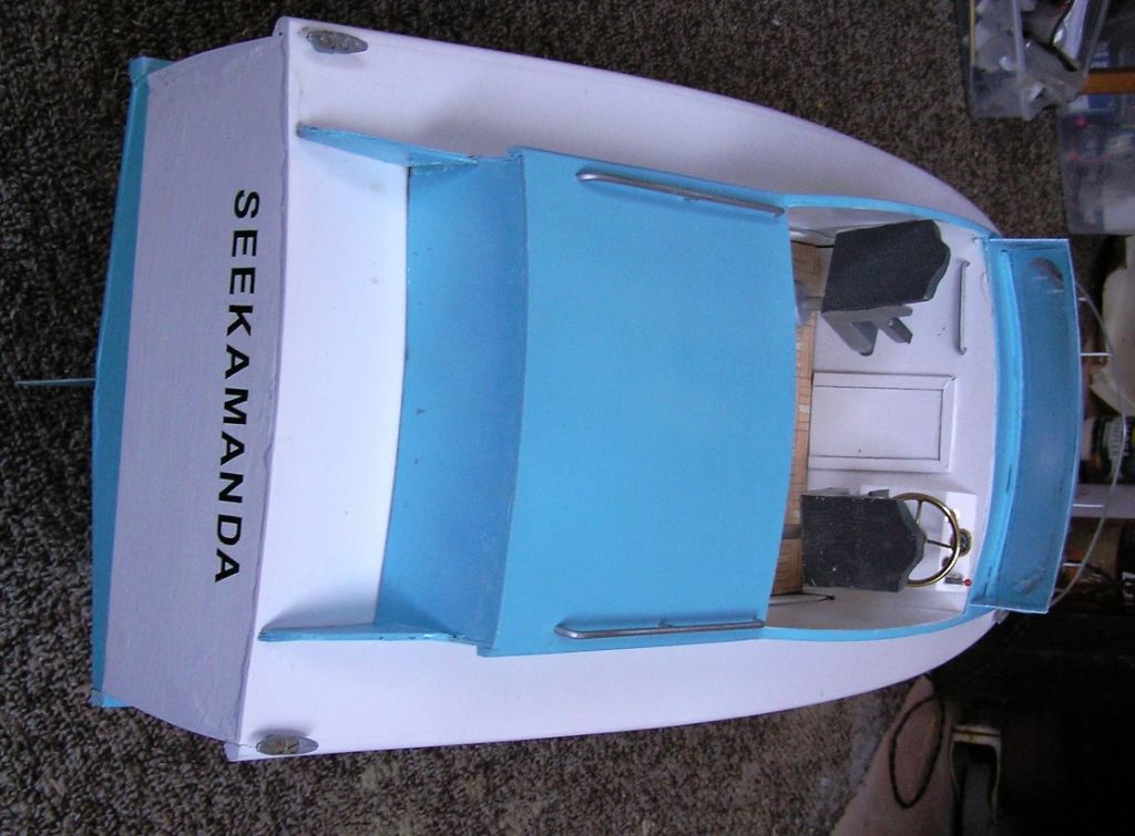

                      Added two sets of 10mm square magnets under the floor, so as to get rid of that screw hole in the floor.
                      I used two magnets together at each end, the dam things are so strong I can lift the boat minus the battery.
                      I think I should have used two not four and they are only chap one's from Hobbyking.

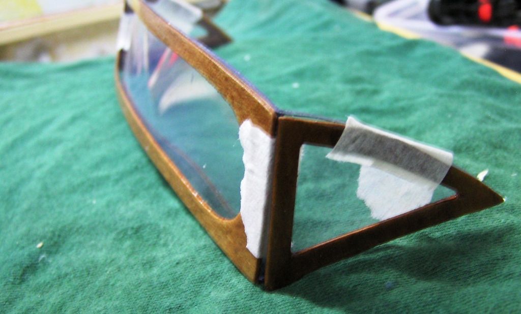

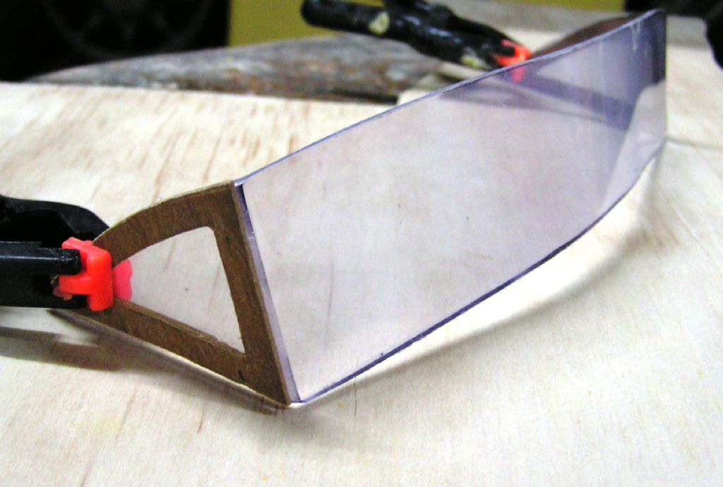

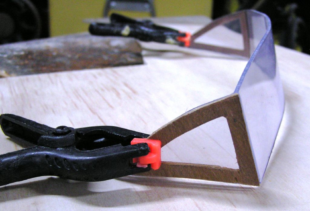

                              new windscreen 2.jpgHi All
                              I was look at the Sea Commander today and the windscreen with the triangle sides did not look right.
                              The front is OK but does not go to the outer edges of the sides.
                              The triangle sides does not match the side profile of the cabin.
                              So I have started making a new windscreen.
                              #67643
                                Finally vanished the surround for the front of the windscreen.new windscreen 3.jpg
