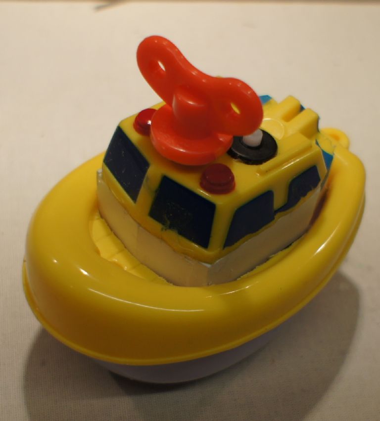

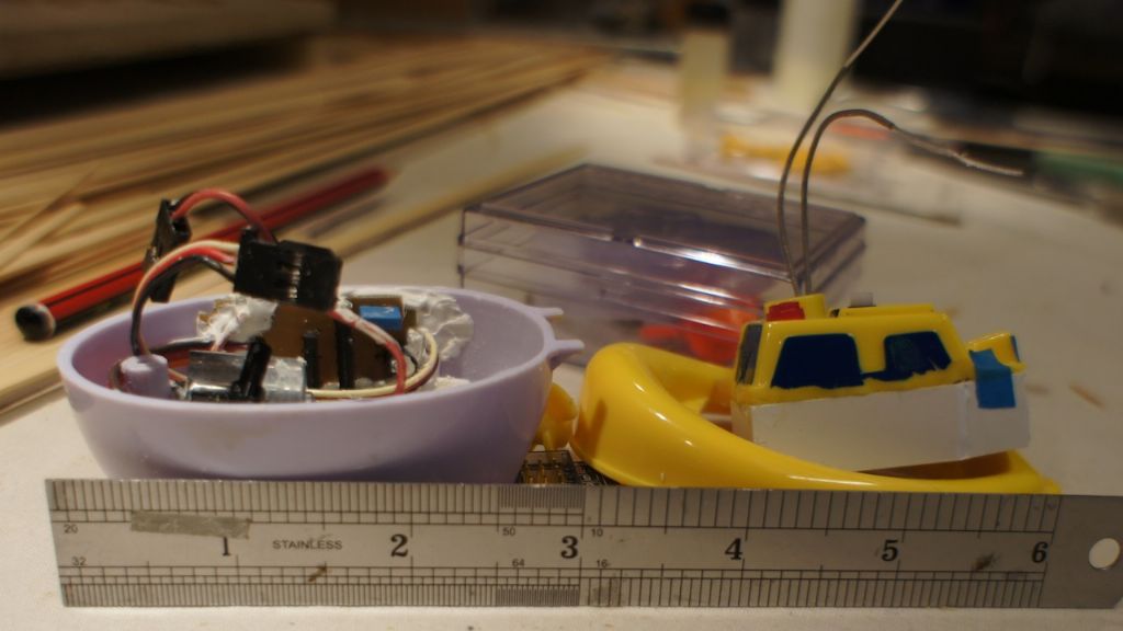

                  Hi again Soup.
                  This is a toy conversion, Ashley will like this.
                  Clockwork tug boat for the bath, from Greenwich Maritime shop.
                  Stripped out the clockwork gear, then inserted adapted servo, motor now main drive, and servo potentiometer neutral set point. Full forward and astern drive. 2.4GHz (smaller ariels) and miniature servo for tiller.
                  Eh voila…………………..
                  Can now be used in bath, or on the tug steering course as a mini (if you've good eyesight!).
                  Kimosubby
                  Edited By Kimosubby Shipyards on 09/03/2013 18:13:06
