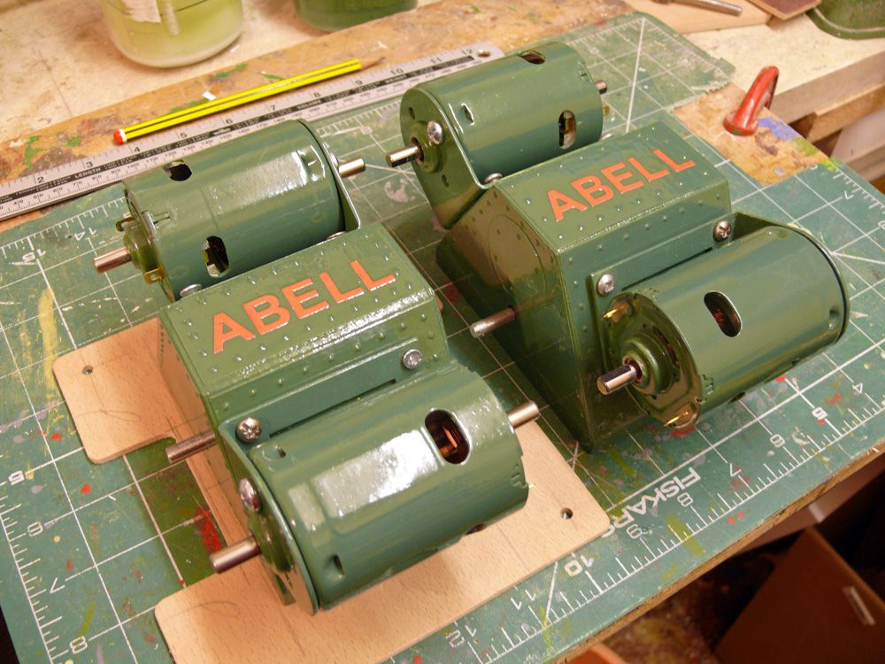

              I think you may not have found my proposed motor drives…..As the thread is quite large
              Here are my motor drives in their early stages….
              Just keep popping in

                  Each pair of MFA 850 motors will drive a single LH 60mm or 70mm dia prop and each prop will have a rudder
                  We have a single keel

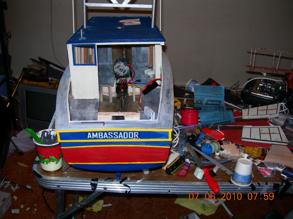

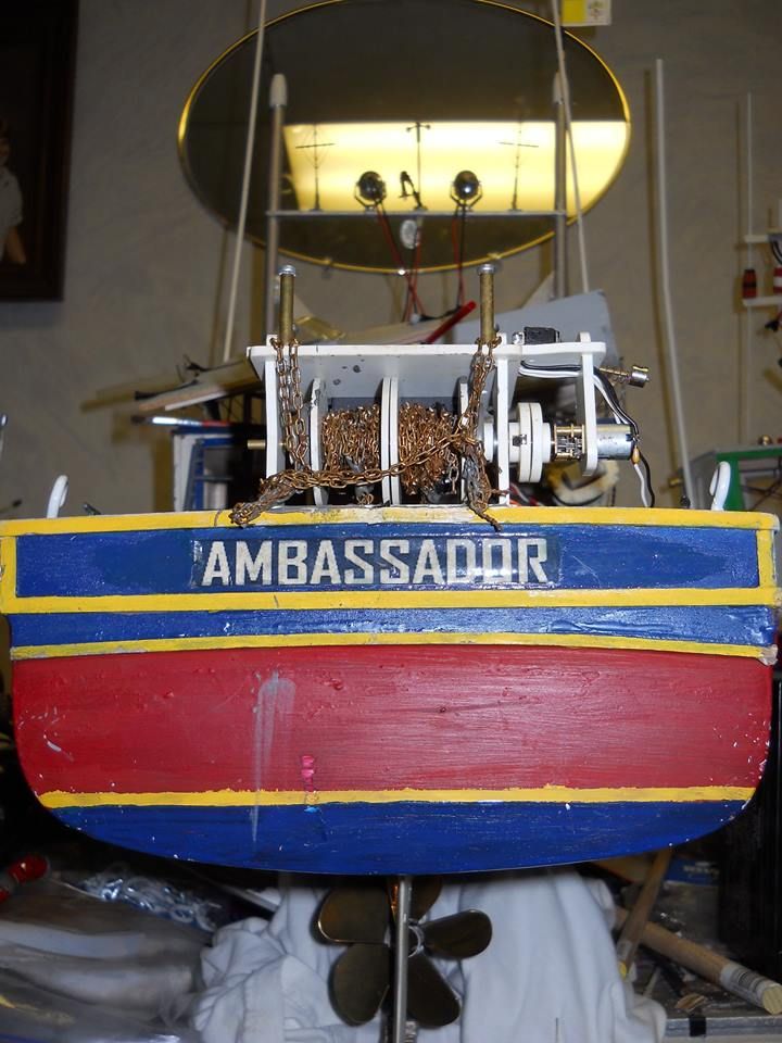

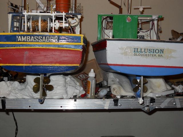

                          Wow Paul!! The Mighty Thor is truly powerful. My heaviest, and most powerful boat is the Ambassador. It's just about 3 feet long. MFA 850 with belt drive reduction turning a 65mm 5-blade prop. It was a veritable miracle how I mounted the motor!
                          My big boat will have to compete with the Ambassador.
                          Right now, I'm thinking of 4 MFA 800s, direct-driving 4 55mm props. I use the 800/55mm setup for my lobster boat Illusion and it's perfect.

                            I just had this thought. Instead of a new boat, maybe I could jam in two more motors into the Ambassador. Would it be OK to add twin 540 motors, geared 2.5:1 turing 2 45 mm props… humming along with the 850 turning the 65 mm prop?
                            What effect would that have on the propulsion?

                              Adding more motors sometimes just means adding more weight and the extra propulsion is lost in pushing the extra weight about.
                              It is also possible that the hull isn't capable of handling any more motors and so adding additional motors and propellers will simply 'boil the water' without providing any more thrust.
                              Can you post some more photos of your model so that we can see the shape and style of the hull.

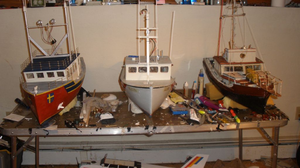

                                That picture you posted is the USS Enterprise… Sovereign class!!! Actually, if I make a big beast of a boat, I might name it "The Sovereign"…
                                Based on what you suggest… then maybe I should indeed build a whole new boat. With 4 850s geared down, turning 4 75mm props!!
                                My Ambassador is basically what we call here in America a Novi Hull. Not much space left, but I think I could jam in some 540s…..
                                (Ambassador on far left)

                                  I have had a look at the specs of the Novi style of hull and whilst they have excellent sea keeping qualities I don't think that they are suited to having multiple motors.
                                  For a powerful brute of a boat you will need a deep hull with plenty of mass so to achieve your dream you might need a 'bigger boat' (a line from a film?)
                                  #53918

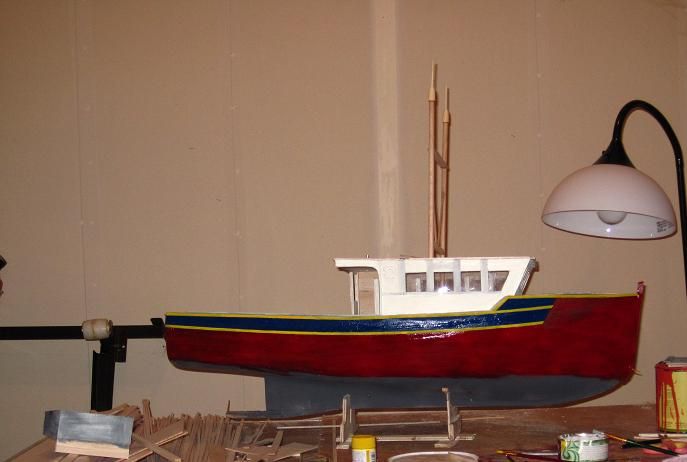

                                    Yes, a "bigger boat."laugh Yup, that's from Jaws. And that's the Orca in my pics. That boat is made of wood with fiberglass resin and cloth over it.
                                    OK…. I'll go back to the drawing board.

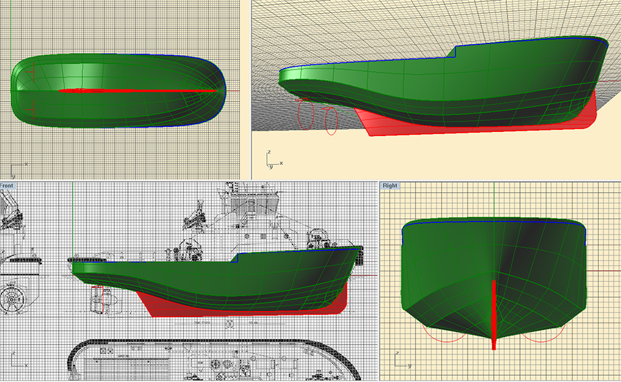

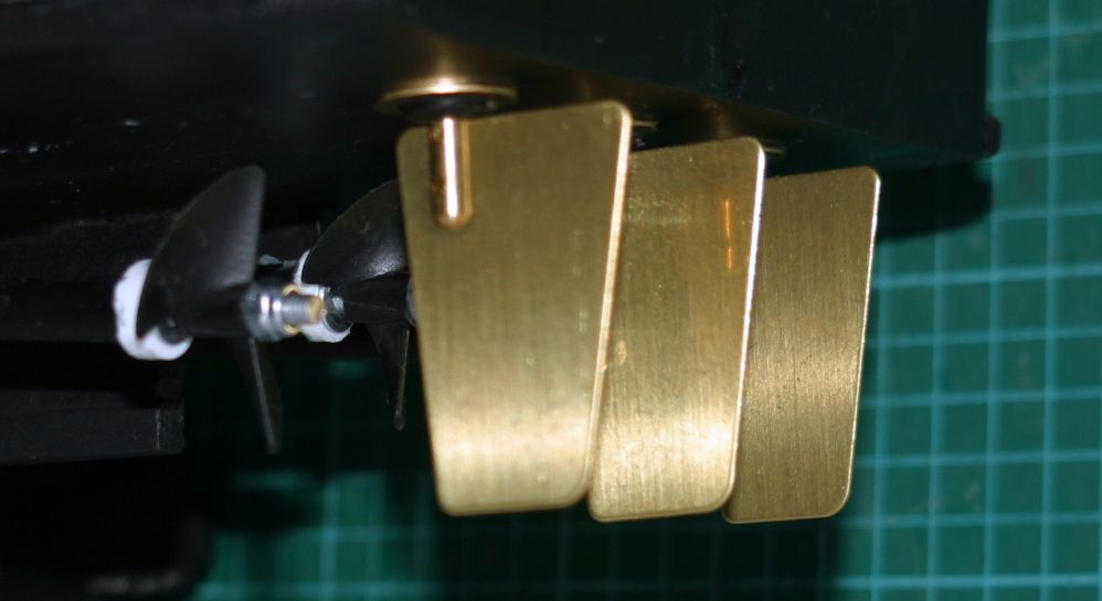

                                      This is a triple set up on a MTB that I built last year

                                          Something with a wide flat back end !!!
                                          Think of a drug runners boat with all those outboards on the back….

                                              #59635
                                                Tug hulls are wide and deep to give them mass in the water
                                                Putting multiple heavy motors in a hull like this would produce a very powerful model.
