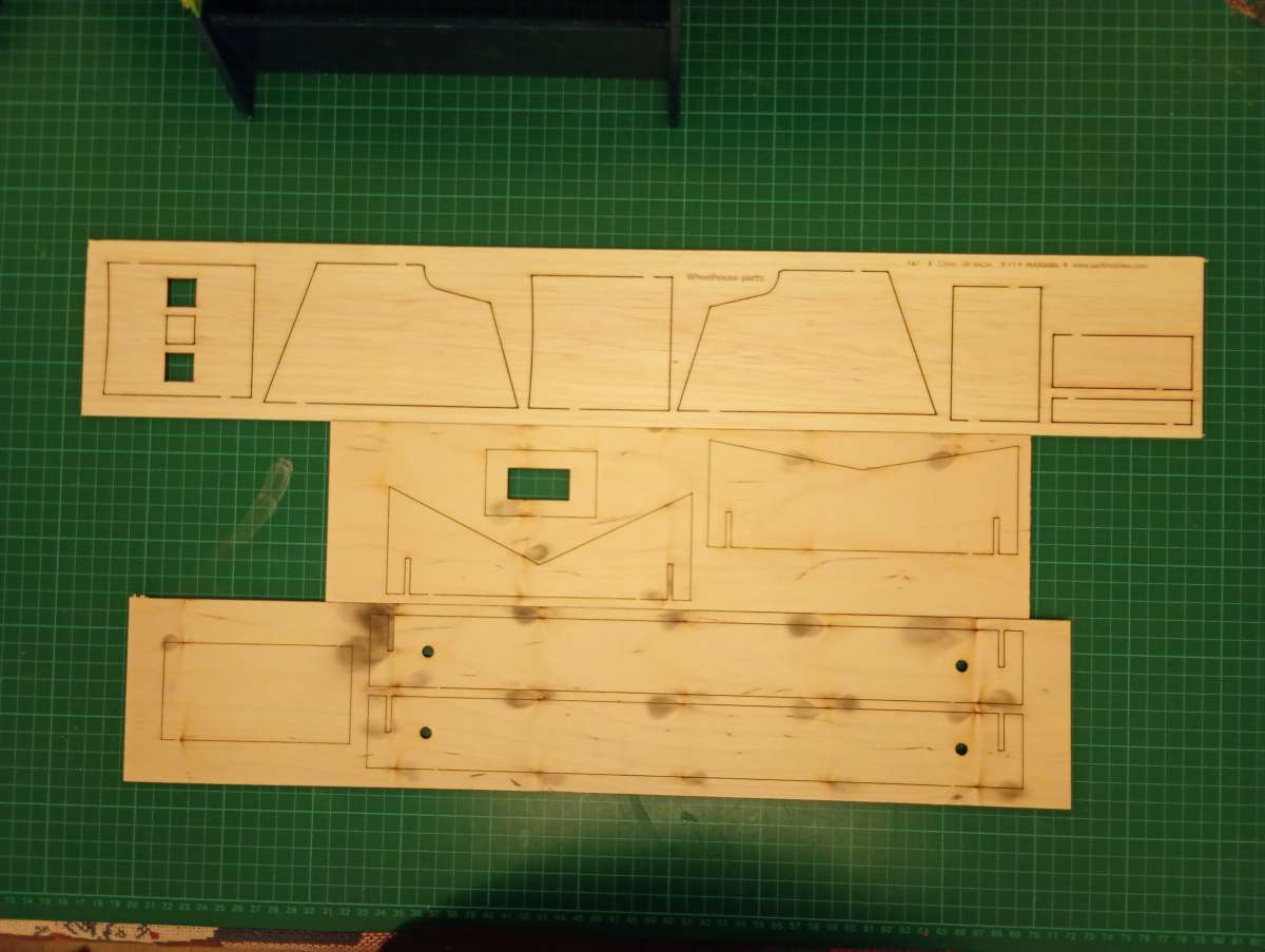

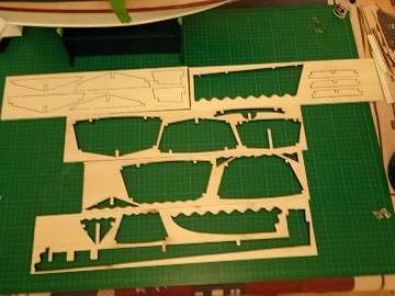

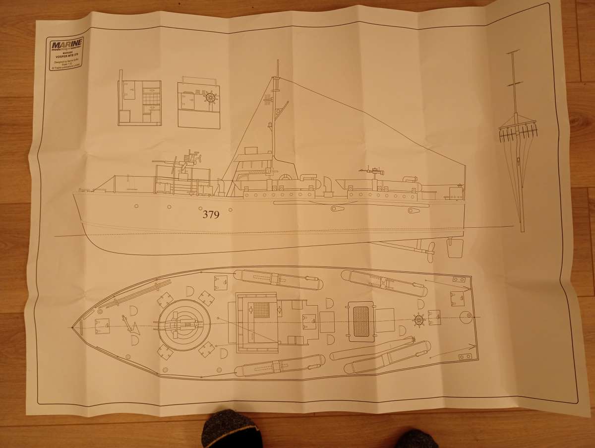

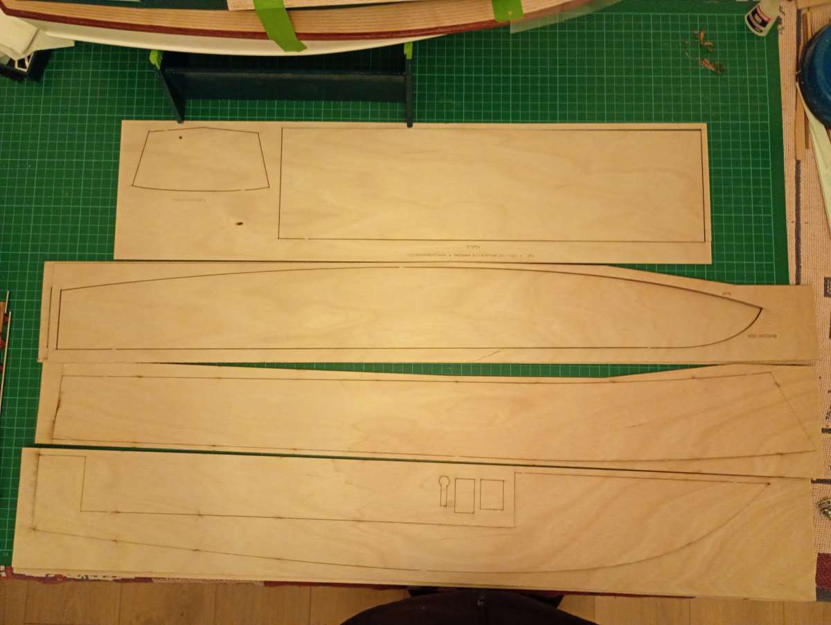

                                              Philip Oxley
                                                @inonowt
                                                Hi John.
                                                In truth it’s 710mm x 195mm which is 1/32, so same sizes as yours.
                                                Attached photos of balsa and plywood wood pack.
                                                1..Frames, most of which I’ve removed.  Some frames are made of 2/3 pieces glued together.
                                                IMG_20260131_184056861_MFNR
                                                2…Skins and deck, paired.  Transom and hatch.
                                                IMG_20260131_184345863_MFNR
                                                3…Stand and wheelhouse.IMG_20260131_184424319_MFNR
                                                There are also 2 drawings of the components for reference.  Also a deck plan and elevation, attached.
                                                IMG_20260131_184552414_MFNR

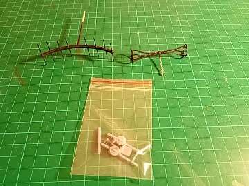

                                                I’ve bought the deck fittings at 1/32 from Battlecrafts.  They should be delivered this coming week.  My arthritic hands won’t let me do small detailed work.
                                                I’ve bought 2 twin Vickers mg at 1/32 from Ringo resin on eBay and I made the IFF transponder and interrogator myself, after a few trial efforts.
                                                IMG_20260131_185858443_MFNR
                                                I placed and order with Cornwall MB for stanchions and such like, and I’ve bought flags from Cap Marquettes
