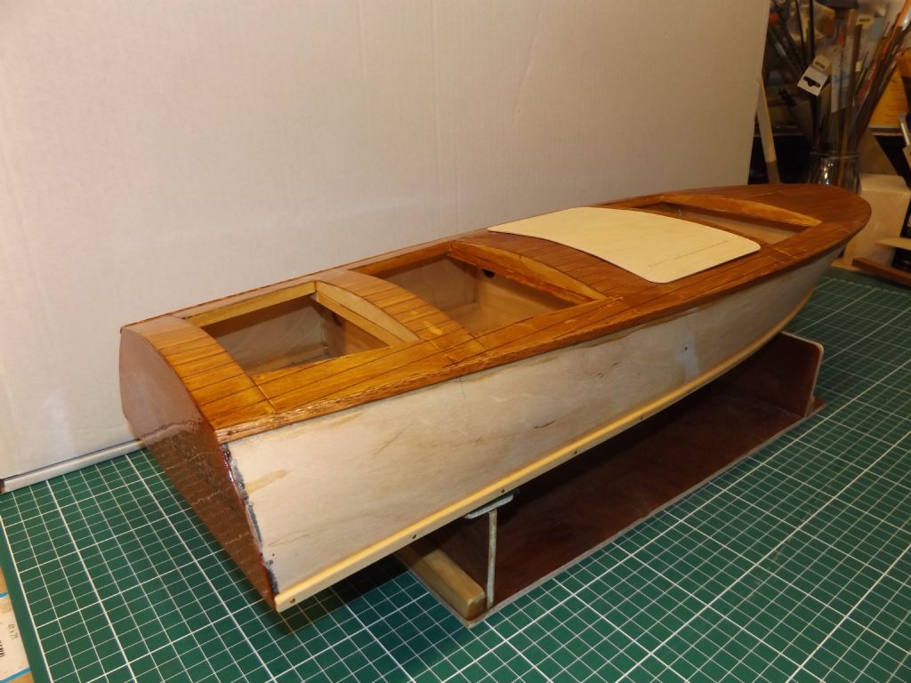

                                Thanks for the hull pic, Ray, that mahogany sheet on the transom looks good. I'd originally thought of having a flat full length deck on my model but seeing the sea hornet arrangement, the curved deck looks good so think I'll go that way. Looks like there are separate curved formers on top of the bulkheads.
                                This is a model for the varnished wood look…
