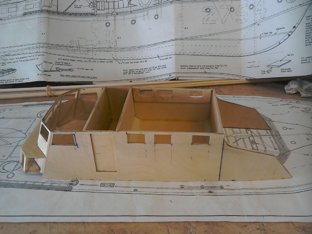

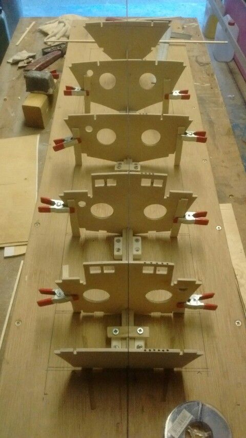

      Hi all I thought I would add some pics of my build I started !! I got carried away I was only supposed to make that patterns whilst I'm making my yacht …markimg_20160523_201634812-480x853.jpg

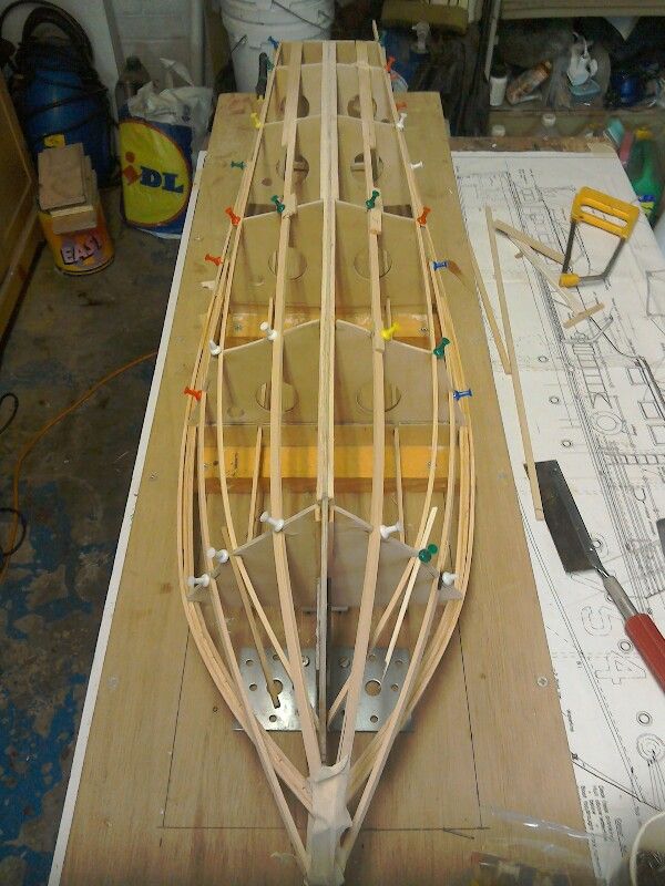

          Hi all I've been busy with my vosper build ,I'm not to impressed with these plans though they seem to leave a lot to the builders interpretation ,if you look at the hull its supposed to be concave but with only the deck and chine stringers these no way of curving the plans ,so I'm going to have to cut the mid stringers in oh well back to balsa cabin in the week for me then !! …….markimg_20160605_105311.jpgimg_20160605_105323.jpg

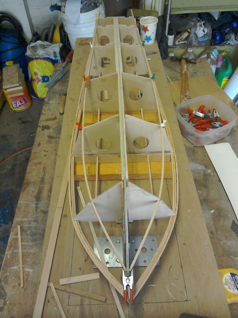

            Hi all I had the day to myself so in between the other build ive turn the hull over and started to add the stringers I did notice that the plans show concave sides but had seemed to of left the off the bulkhead drawings so with my countless cups of coffee I set about putting this right but as I only bought enough wood for what the plans showed I'm now back to the Balsa Cabin on my way home from work Monday …..markimg_20160605_183319-600x800.jpg
