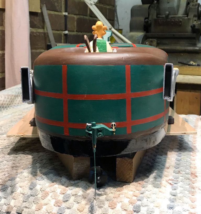

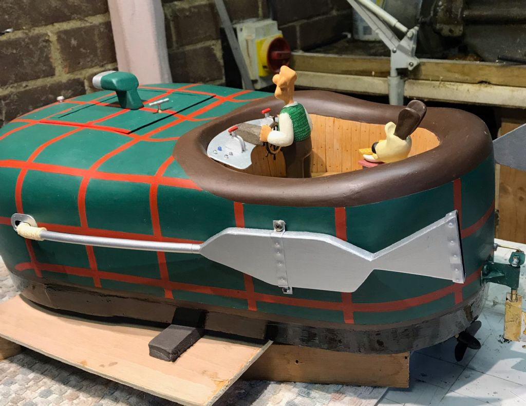

      Skidding being the right word with absolutely no response from the rudder! Hope to have cured that, will find out tomorrow! Hold tight lad I’m going for full power!

        OK. I am going to spill the beans.
        Richard has a hot 540 installed (the sort with adjustable brush timing) with a flexidrive and a (poss Beryllium) racy prop.
        It did exceed expectations, and a test in calmer water will give us a better idea of how well it goes.
        The slipper is very nose-up, and to be honest, I thought this was ok considering the novelty of the design. I squarer shelf fitted at the stern, possibly in acrylic so as not to be noticeable would/might help to keep the nose down.
        Although it was going very well, some more performance might be available if Richard could get rid of the obvious cavitation that`s going on. Essentially this would call for a larger and possibly surface piercing prop (which work better than normal props when a bit of cavitation is present) but might strain the 540. A speed 600 could be easily fitted I suppose and this might turn a slightly larger prop than that fitted.
        HOWEVER….is all that work worth it??? It went really well considering, and was a great larf. I suggested that perhaps a bit of half-round section wood/plastic/woteva could be fitted around the `welt` of the slipper to prevent some of the spray that is causing internal wetness, but it may have been that the fairly severe weather conditions were more to blame than any shortcomings in the design.

          Yes Ashley, a less choppy test is needed before I start chopping and changing things. Always change one thing at a time then test, always worked for me with all my projects.

                  Another surprise from the slipper. It didnt go as well on the dead flat calm pond that was today, as well as it went on Sunday!!!
                  We put it down to the chop actually helping by lifting the thing up and down. Then it broke.
                  What to do??? Richard will no doubt let us know.

                    Underside of Slipper is having a refit, more buoyancy needed. The soaking it got on Sunday seems to have fried the receiver or the Cheepo speed controller did, anyway, tested the receiver tonight with a 6 volt pack and it started getting hot so it’s dead. Need to track down a replacement Planet ts2 receiver, any ideas?
