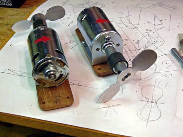

        Just one  word of caution Bob I’d be tempted to keep the fans smallish no more than about 50% bigger than the motor diameter they do shift a fair bit of air and they will load the motors a bit. Not as much as in an edf setup as the exhaust is bigger than the inlet the exact opposite to an edf unit.

            I agree with Phil. I think something as simple as two or four blades, a bit of twist on the blades and round ends. Too fast an airflow might actually detract from a good circulation in and out of the boat hull.
            Maplins for instance does a good range of alloy heatsinks, one of which you could glue on the motor casings with heat conducting silicone gloop, they would conduct the massive heat generated by your 1/2 horse (or whatever) motors into the airstream to be dissapated as global warming air currents.  I think I saw this on an Australian chaps type 21 frigate in THE OTHER magazine a while back?? looked impressive to me.

              Thank you Phil and Ashley for your cautionary words of advice.
              Perhaps a simple twist of ali might be suffice?………Or the aero prop idea?
              I fancy the glued on heat sink idea, Ash……….Thanks for that
              What do we think of the aggressive looking terbo vents then?
              Brrrrrrrrrm!…..Brrrrrrrrrm!……….etc………………Bob

                Very nice indeed Bob I’ve been thinking about these fans and ducting and I reckon a 55/60mm 5 blade fan and a half pipe cover for the fan and motor would do the job ok without loading the motors significantly heat sinks on the motor would help too. thinking on I reckon I prob have a couple on some old pc fans in my bits box I’ll have a look over the weekend and let you know.

                  Why do we have such a problem with a water-cooling coil, chaps? It’s cheap; it won’t take any power from the motors, and it’s been proven to work. I for one would not like to put my hand in there to operate a switch with a pair of ersatz circular saw-blades ready to sever my fingers.

                    Just inventing the wheel!…………..Don`t like waterpipes……You can never be sure it`s working…….Our pond is full of duck muck and algae in summer

                          Suprised you didn’t know what KISS is Bob still never mind having had a sort through the shed I’ve spotted a fatal flaw in the idea of using off the shelf fan blades they’re all the wrong hand mate assuming that viewed from the motor the rotation is clockwise. all you’ll get is air moving the wrong way might be best to resort to circulating H2O, Shame cause I quite like reinventing the wheel too. Air scoops on the front might be suficient as I’m betting the motors etc won’t heat up much except at high speed

                            Good job you spotted the fan handing, Phil
                            I`ll stick with a new home made pair, but a lot smaller next time.

                                                “Keep it simple, silly”!………He said…………..So I have done!…….No scoops and water pipes for me, shipmates!
                                                New simplified fan shapes
                                                I `m confident that this idea will be OK……………….Bob

                                                  Certainly simpler Bob I trust you’ll check them for balance (at least a dry run out of the hull ) we don’t want the motors shaking loose do we

                                                    Please test the aluminium paddles on 12v first. If you go straight for 24 volts then can I have an hour’s warning and full body-armour? Somehow Manchester doesn’t feel like it’s far enough away…………
                                                    #25463
                                                      Hello Dave and Phil!
                                                      You two are beginning worry me now!………All these alarm bells going off are making me nervous!
                                                      Seriously though, I`ll be very careful……..I`ve tried them on a 12v jelly for a fleeting second and it was quite fearsome!…….The fan gave a hefty blow!…….Might have to make them a bit smaller and safer
                                                      I`ll make a perimeter guard before I try again, just to be safe……and wear goggles and tin hat!
                                                      If it appears dangerous, I`ll scrap the fans and go the water pipe route
