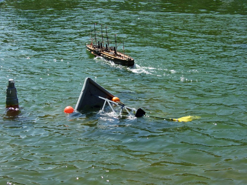

                            #36125
                              The deep keel on my Great Eastern has proved to be very successful.
                              It is fully adjustable and can be added to or lightened as required
                              The model sails in an upright majestic style, with no wobbling, rocking and rolling and was sailed in a howling gale at Colwyn Bay regatta recently and she didn`t bat an eyelid!
                              Hull based ballast lacks the leverage and steadyness of a deep keel…….Imho….lo
