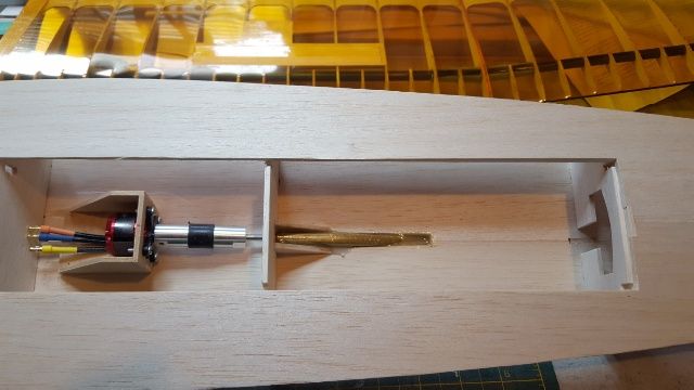

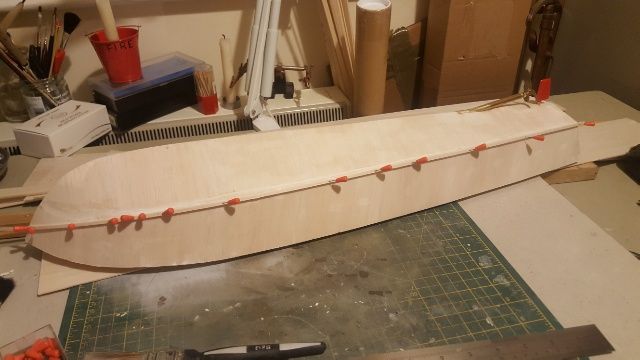

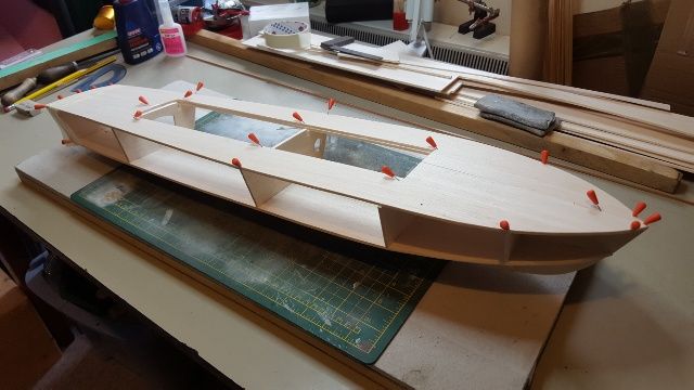

      I like it seems many others have decided to build this between projects as a simple no frills build as yet no problems and fun working in balsa I'm doing a 28" model as it will be running in the local estuary.

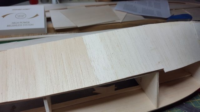

      I am still building the hull and installing the running gear progress is steady but no issues as yet I have double skinned the hull bottom for a little more durability.

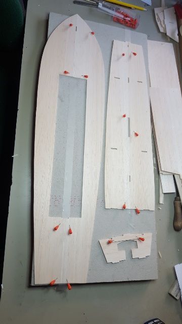

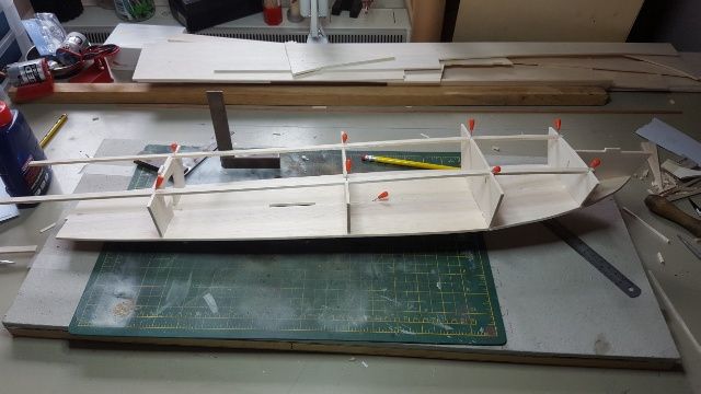

          …I see you're using the 'notched bow skin' technique popularised by Les Rowell.
          How big are the unsupported gaps between the bulkheads? I find that 1/16" balsa tends to sag after a while when the gaps are bigger than about 4". But of course if you are using double-skinning the gaps can be bigger…

            I have kept the gaps the same but the double skin has made it quite solid I will do the sides the same way.

              Prop shaft epoxied in the rudder post next.

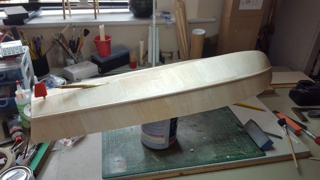

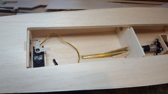

                Not to much progress recently I found an old Acoms servo that works fine so I'm using that, the double thickness skin seems plenty good enough.
                I have added the spray rails and it's had an initial couple of fills and rub downs I've done two coats of dope and waiting now for a varnish coat to dry before rubbing back.

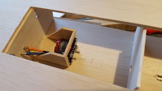

                  What size motor, prop and batteries are you expecting to use? I found that the original was so light that even the smallest brushless on 7.2v was enough to push it at a good scale speed. In fact, I had to trim the rudder to stop the turns getting too tight at speed. With the size of rudder you have I suspect that you won't need much throw at all at speed, which may make it a bit harder to manoeuvre when going slowly…

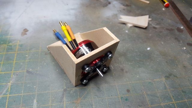

                    As I am trying to keep to the school boy ethos it won’t be doing slow! I could mix in a throttle rudder mix so more throttle less rudder. I have used a spare brushless I bought for a glider which I think is around 170w on a 3s so I may only go 2s I have a 35mm 3 blade prop.
