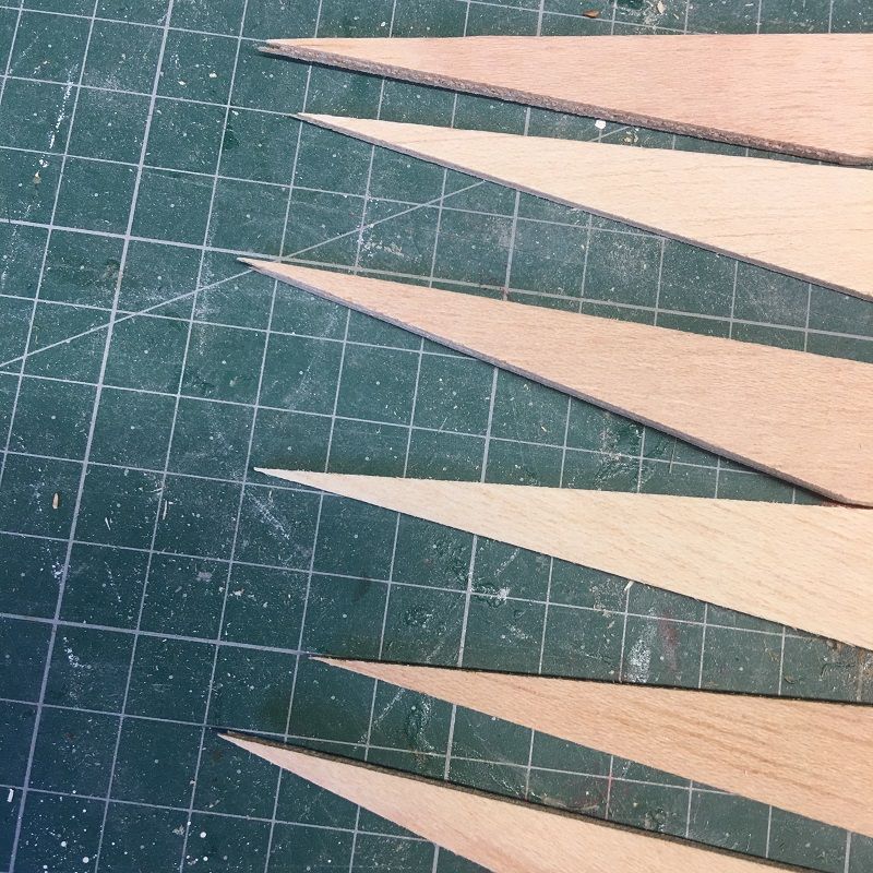

                                              Have just started work on the H31 build, no problem with the Liteply even when cut to a very fine point with a router.
                                              I will continue this build on another thread.
