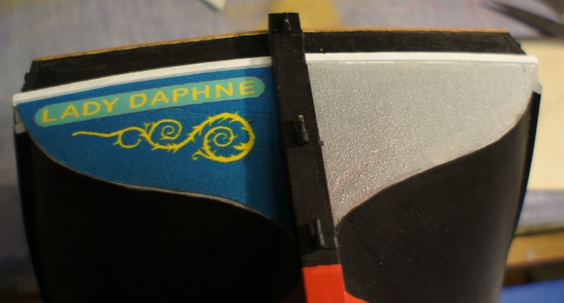

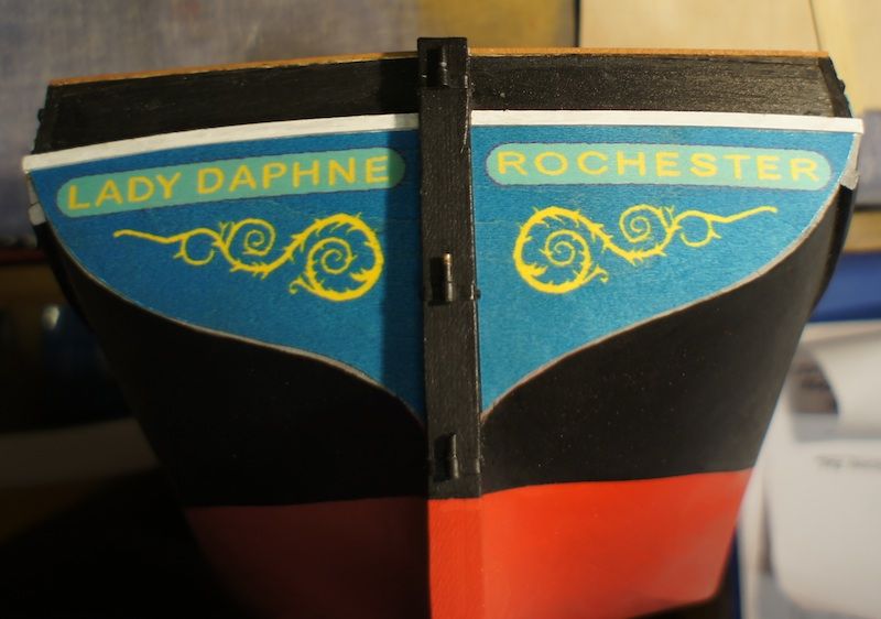

                    On a new thames barge I’m building I used doubled sided tape for the small scrolls bow and stern for fixing, applying the tape to the small item, trimming to exact shape, then removing backing tape and pressing firmly to hull.

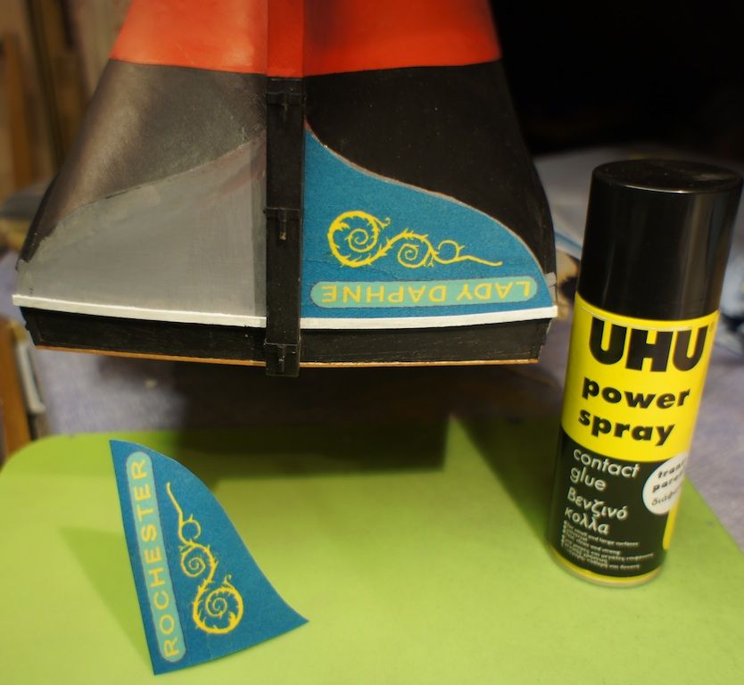

                    For the stern pieces, I used the UHU spray, did one side last evening as a trial and have images of the second piece which went on today.
                    The boat, upside down, port stern piece on, and the other shown together with the glue.

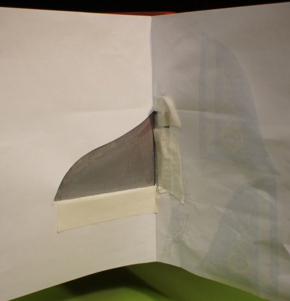

                    I masked the area with a sinle sheet of A4 having run masking tape around hull curves, and the stern post and deck beam. The spray is actually quite directive. The piece for attachment was temporarily stuck to an upright spray board with a loop of tape and sprayed at the same time.
                    The masking removed, and the hull stood on her nose whilst the glue is allowed the “standing time”, in this case, 10 minutes.
                    Carefully positioned, if gentle with no pressure fair amount of adjustment can be made, then pressed home, using flattened edges to smooth outwards.

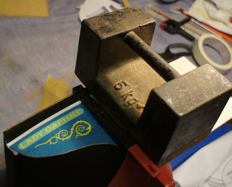

                    And finally, the instructions suggest a bit of applied pressure whilst the glue goes off – which is quite quick in warm conditions, I left this on for 30 minutes.
                    Any over spray does remain tacky, so I avoid as much as possible. On bare wood it dries out, on plastic or painted/varnished/sealed surface takes longer. I’m sure with some experimentation a suitable solvent could be found to “wipe” excess off without too much damage to surfaces.

                        the spray is a contact adhesive, so as is the norm a small amount to each, let dry till tacky, then join together.
                        Its a question of size too, the barge stern is quite big, so sprayable. So both bits got done.
                        It is possible to just spray one component, but then join after spraying and keep some pressure on. This was when I got that advice, instead of spraying a 6″ hull to fit paper decking, and getting whole hull covered, I sprayed the decking piece and then fitted the deck. It does state that if one component to glue is very porous ie paper, then spray and bring together straight away.
                        I applied the weight to see if there was any difference – result – none that I could tell, the glue was stuck, so i would not use it again.
