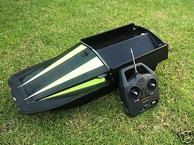

                              @jimbo68
                              http://www.modelboats.co.uk/wp-content/uploads/sites/5/images/member_albums/4014/686c_1.jpg
                              Big Bessie. My Bait Boat, the cause of everbody else’s problems
