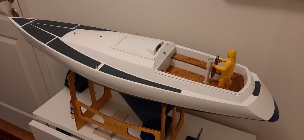

                              After about 3/4 months I have returned to my workshop to try and complete my Comtesse. I am in the process of painting the hull and fitting some of the additional parts which can only be done after painting. All the pictures I have seen of this model have a blue/turquoise series of what appear to be transfers on the deck. I have checked what was supplied and I only seem to have the transfers for 6 windows and one for the hatch next to the mast foot. Should there be more in the kit or do you have to create your own for the deck?
                              Any guidance appreciated and George from Norway especially, if you can remember that far back!

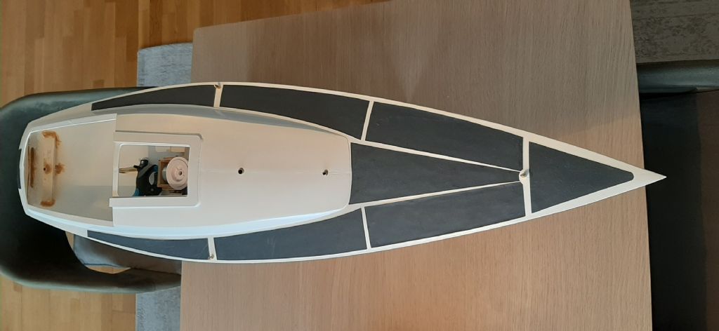

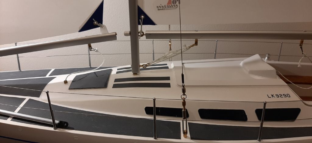

                                My Comtesse is in the cellar store room and not readily to hand. If you look in on my build log for the Comtesse you can see the the ports are all dark blue. I don't think I used transfers.
                                The deck markings for non-slip 'treadmaster' are probably just in the pictures for show. I made mine with 1200 grit wet&dry sandpaper (waterproof).

                                  20200605_152038.jpg20200429_131813.jpgHi again Chris, painted my windows dark blue. Added one to the hull sides which deffinately looks 'add-on' as it's not recessed into the hull. Neither are the supplied kit ports. Not noticeable under sail though.
                                  Lots of photos on my album where you can see my 'wet and dry' efforts.

                                    Thanks George for your help once again. Not been able to progress much as it is my wife’s birthday today and preparing yesterday and having family around today has put any thought of boats to bed. I did however spend a pleasant half hour with 2 of my grandchildren and a recently completed Tamiya Hornet. The youngsters seem to take to it like a duck to water.
                                    2 final Q’s please. How did you stick the sandpaper on to the deck and did you seal it over the top? I am spraying Billings boats paints and they do a gloss and satin or Matt finish.

                                      Hi Chris, it's no bother, but be aware that on occasions it can be a few days between each time I 'look in'. Especially now that I have a pile of wood flooring stored in every room in the flat. I'm actually about half way through the job…going a bit faster than I expected.
                                      I glued on the 'treadmaster' with water proof wood glue! The stuff I use is called 'Hard Head' and is used by joiners on outside jobs. I've used it on my Fisher 34 model and presently on my Colin Archer RS1, You can also use '506 Canopy glue' but it's more expensive, a litle bit thicker, and cures rather rapidly and gives less time for adjustment of the treadmaster if that is necessary.
                                      I would advise a test-glueing on a peice of scrap plastic from the Comtesse kit.
                                      I made a few very light razor cuts in the deck surface just to give a 'key' for the glue, A light sanding would also be OK, but be sure to keep in inside the perimeter of the area of sandpaper to be applied.
                                      Any wood glue which oozes out kan easily be washed off (without delay) with a wet sponge or cloth.
