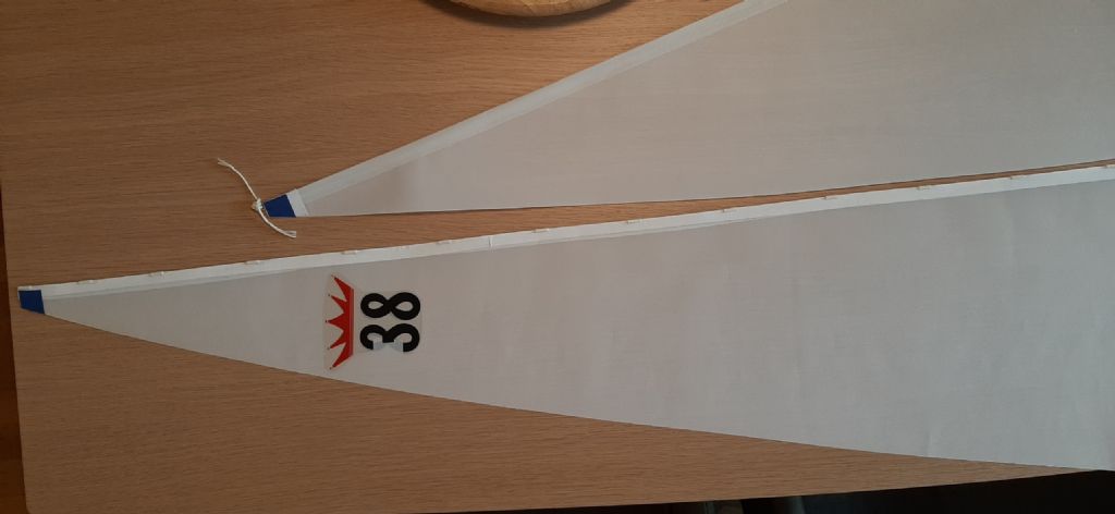

                      Made up the sails today. Not much shape in them but they came with the kit so they'll be given a chance. I've never made sails before so when I do my homework and make sails for the Fisher I may be able to make better ones for the Comtesse. For the time being I'm content just to make a 'sailing vessel' which stays afloat, sails and looks the part.
                      George

                            Another piece of worthless info: the sail number has been 'doctored' from 88 to 38. The reasoning for this is not worth knowing about so I'll stop at that.20200515_091943.jpg

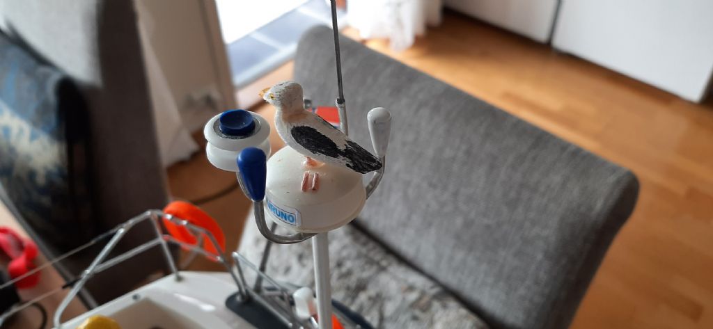

                              Pulpits now mounted on deck. Radar mounted on a Scanstrut together with dual AIS antenna, SatNav, GPS and the latest jetisonable floating VHF antenna. High-Tech yacht this. Hope it floats. Photos in album.
                              George.

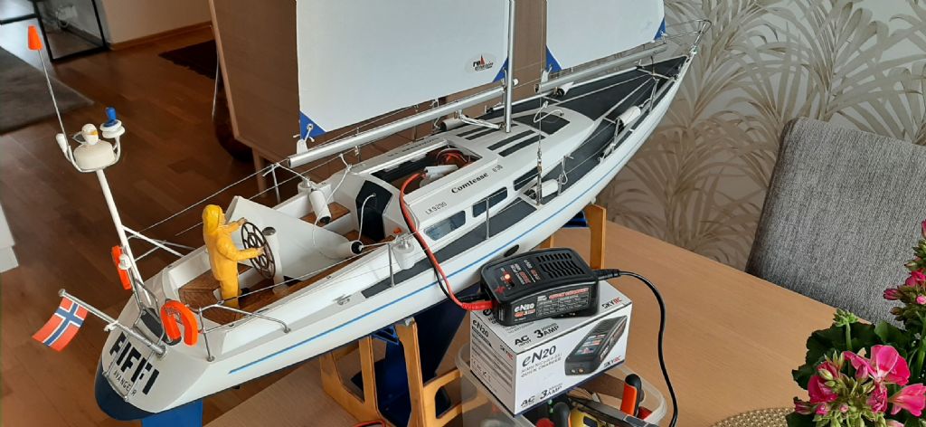

                                        The Comtesse is nearing completion now. Rudder servo installed and functioning. Have to find suitable locations for ESC and Rx mounting.
                                        I was not looking forward to the process of 'binding' the receiver and transmitter on the Graupner R/C gear which I bought last year. Instructions for 'binding' are written in two separate booklets (one for Tx and one for Rx). As is often the case, it can be more complicated to understand the written instructions than actually perform the actions. Graupner instructions seem to me to be written by technical wizz-kids. Acurately written, but a bit complex for 'non-wizzers' like me. I bought Graupner R/C because that's what the lokal (80km away!) modelshop stocked.
                                        Anyway, after several re-reads and a couple of attempts, the R/C gear was tested OK on the kitchen table and is now en-route to the hull internals.
                                        I'll post a photo or two of the completed yacht on the water…if it floats long enough. I'm at least pleased with the end result visually. From a distance it looks vaguely -as hoped- like the Bavaria 37 I owned in 2007.

                                            It floats -to it's marks! Only managed a few photos and a short video taken at a nearby shopping mall water feature -as explained in my Soapbox thread.
                                            I had a bit of luck with the chosen waterline marking. I knew the Comtesse would be a little heavier than standard due to helmsman, radar mast, large-ish digital servos and 3600mAh battery so I added a few mm to the waterline markings when spraying the hull.
                                            The yacht looks as good as I had hoped for -on the water. She sails in 'no perceptable wind' conditions which means that graceful sailing is posssible in calm, pleasant conditions. Just what's needed to be able to combine a lakeside picnic with both wife and yacht.
                                            I will post a few photos from the floatation test and maybe one or two from a lakeside venue later and that will conclude the Comtesse saga – unless some important event/failure occurs which needs reporting.
                                            George

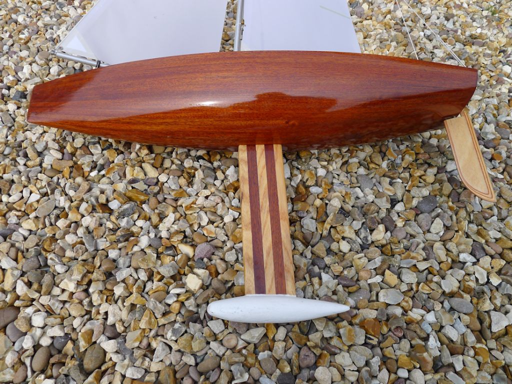

                                                    Please can someone advise me on how to fix the heavy metal wing keel supplied for the Comtesse. This is my first sail boat and only one previous boat build which was the SLEC Huntsman.
                                                    I have been building model aircraft for some years and decided due to age to have a change of direction. I am reluctant to create a hole to fit a bolt but not sure glue will be strong enough. The winged section weighs 880 grams.
                                                    Thanks in anticipation,
                                                    #98144
                                                      Chris, I'm afraid I am not a sailing modeller but I do have a beautifully made yacht which might be of interest. The keel has a tapered section at the top which sits into a matching socket that goes right through the hull. This ensures that it can be totally sealed and watertight. The keel is simply inserted and a brass thread which is bonded into the blade of the keel, pops out on the deck. A nut and washer holds the keel in place.
                                                      If this doesn't make sense then let me know and I will take some better pictures of the arrangement.
