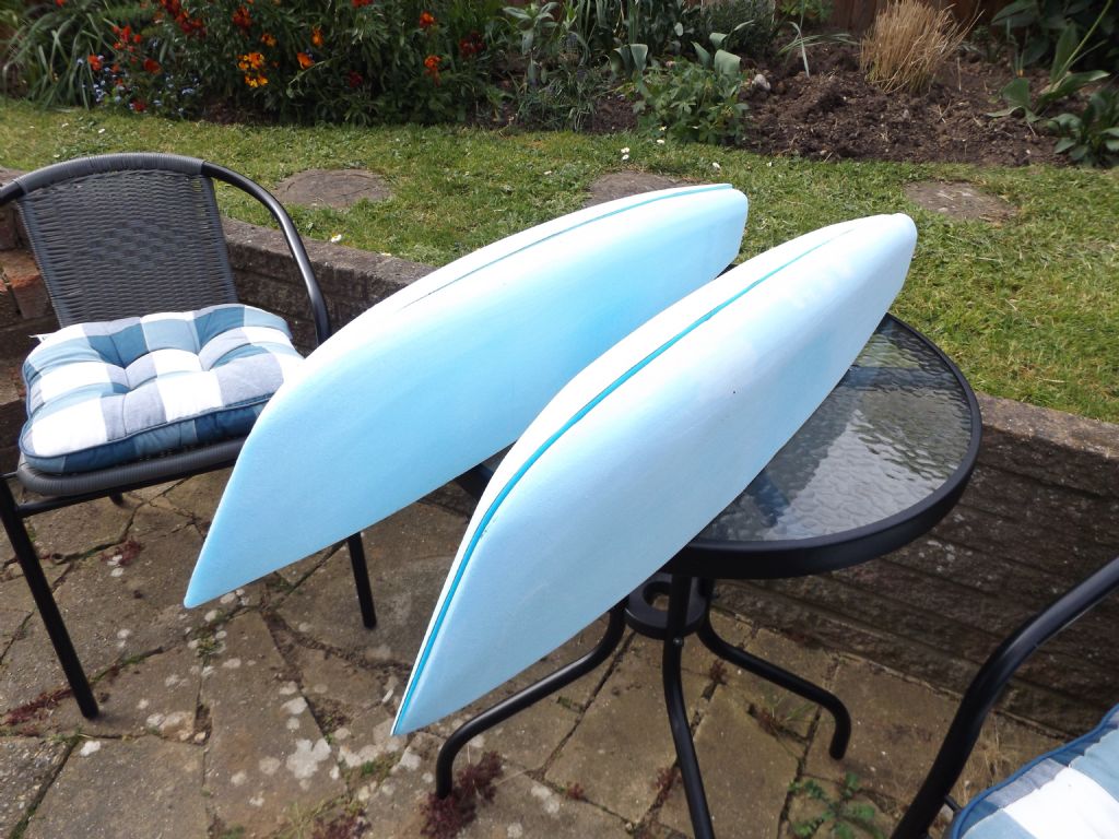

                        #82093
                          Hi Chris,
                          Blue Styrofoam is easily carved and sanded to shape, if your going to glass cloth and epoxy the hull it works well 😊
                          #82094
                          chris fenerty
                            @chrisfenerty25956
                            hi, is that the real dense foam 12mm thick laminated to larger sizes
                            #82095
                              It comes in 50mm sheets here as insulation,, either known as Roof Mate, or Floor Mate, it's light weight, used in RC aeroplane building, I'm building a cat with it at the moment.
