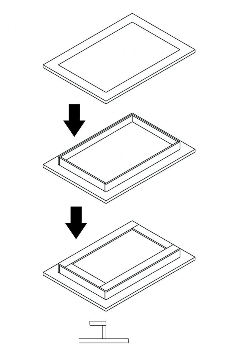

I don't understand your question about "the channel". The strips of styrene form an L section which is glued to the hatch to prevent it warping or twisting. If you glued one of the strips face down to the deck then it wouldn't form an L section any more; it would just be a flat beam and nothing like as strong.
