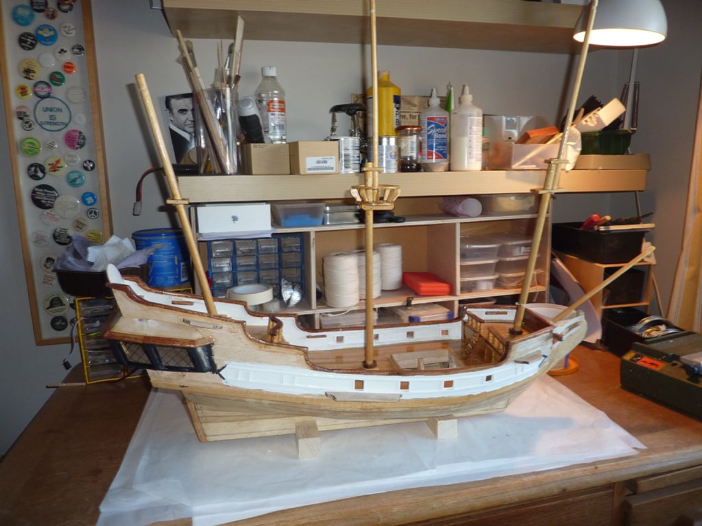

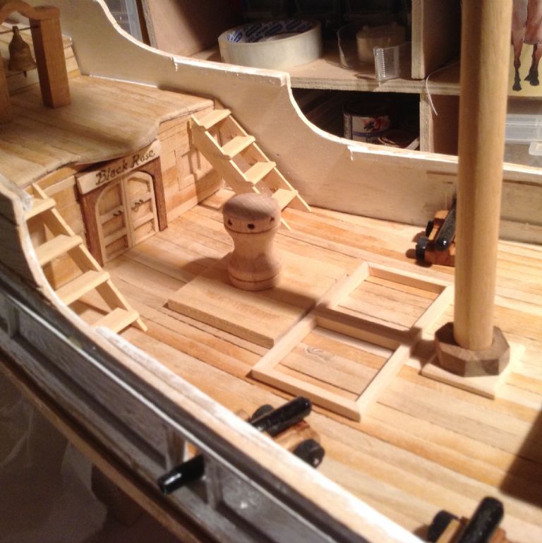

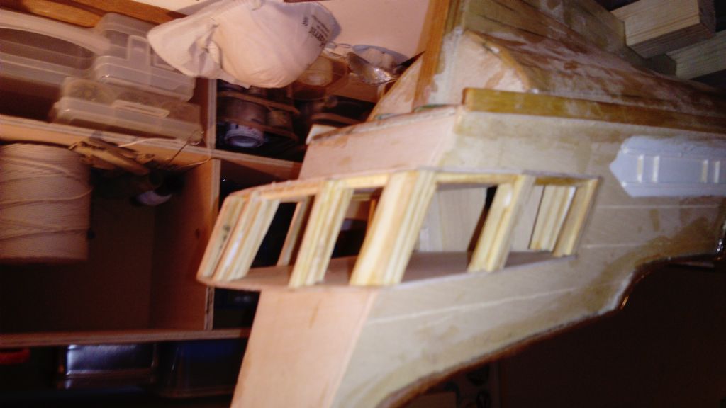

      Brian Muir
        @brianmuir84327

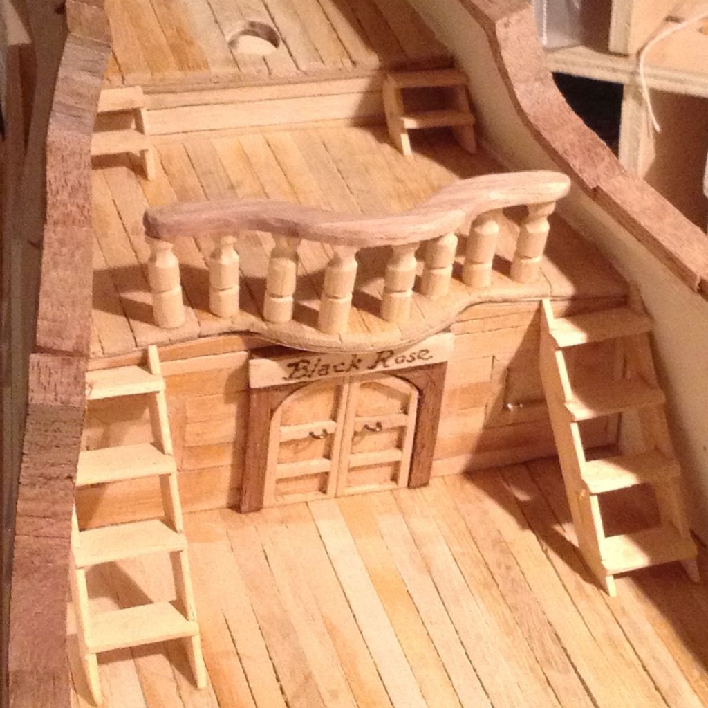

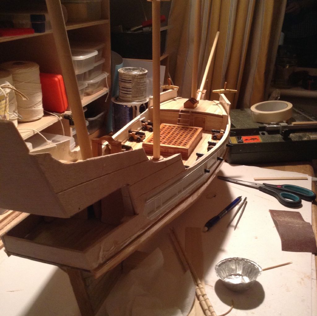

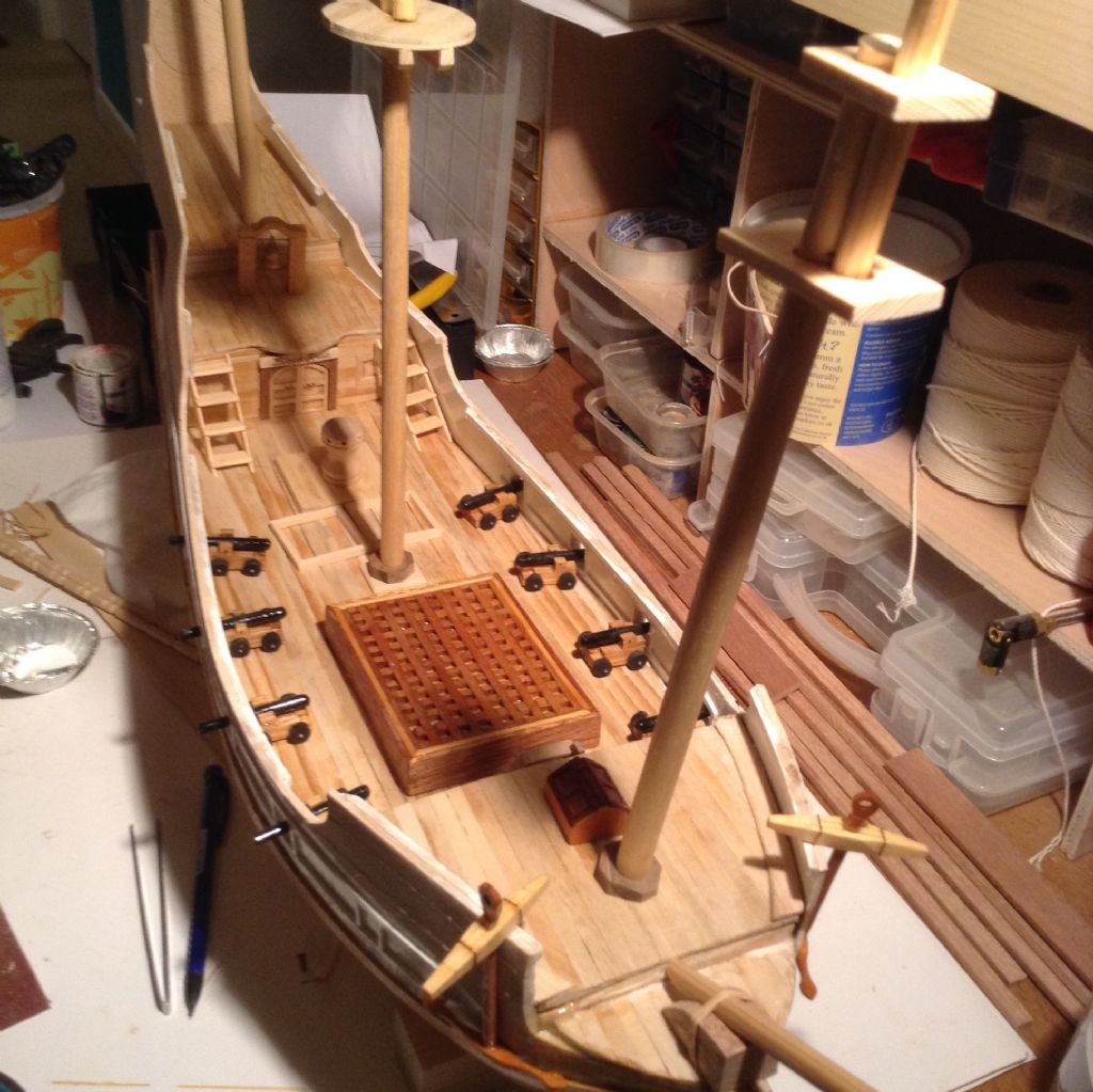

        Steady progress, have coated hull in epoxy resin to waterproof and toughen it. Capstan was turned on a lathe. Inside of bulwarks and strip along the gun ports painted white, the hull will eventually be black or dark gray. The ships wheel and the ships boat are the trickiest bits to make at this scale, anyone any advice?

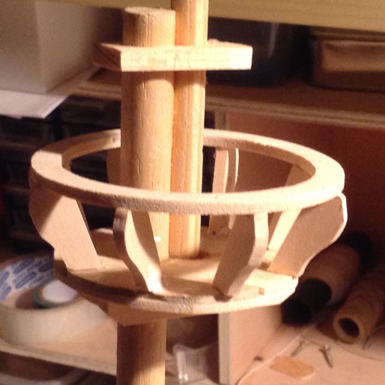

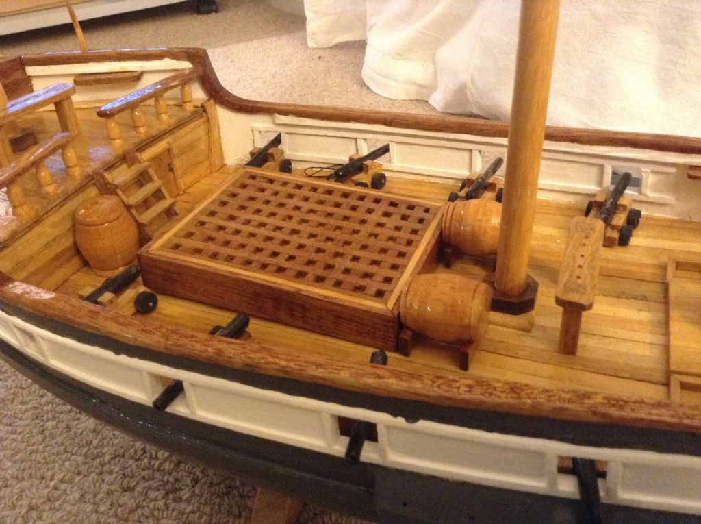

            Crows nest and taff rail on the quarter deck done, taffrails rails around the bulwarks fixed, now waiting to be sanded into shape, all Sapele wood which looks great when varnished.

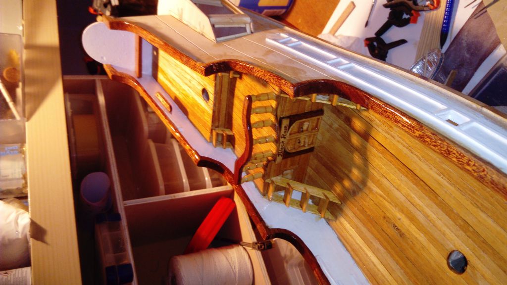

              #69549
              Brian Muir
                @brianmuir84327

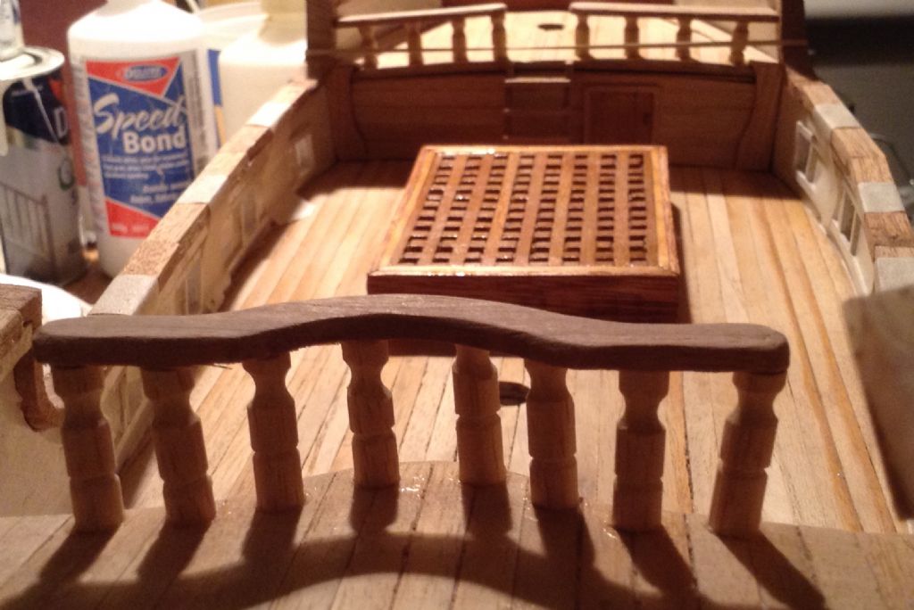

                The taff rails now shaped and sanded, the Sapele wood feels great when sanded then the varnish really brings out the grain of the wood.

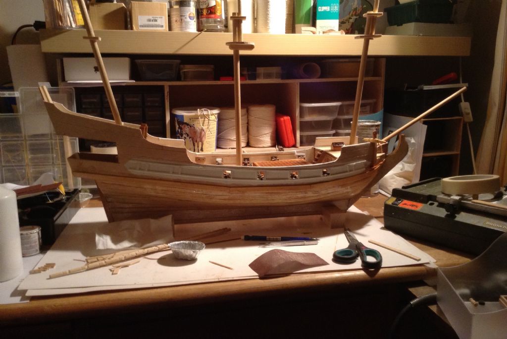

                      #69653

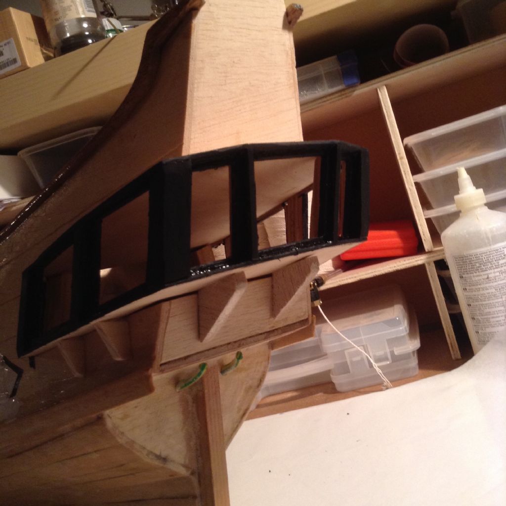

                      Brian Muir
                        @brianmuir84327

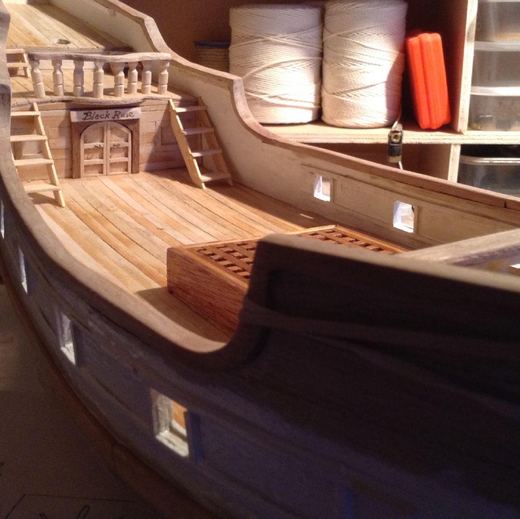

                        The taffrails are gleaming with their final coat of varnish and work started on the cabin.

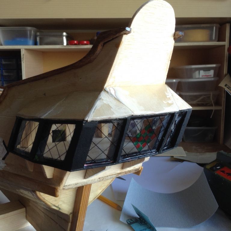

                        Brian Muir
                          @brianmuir84327

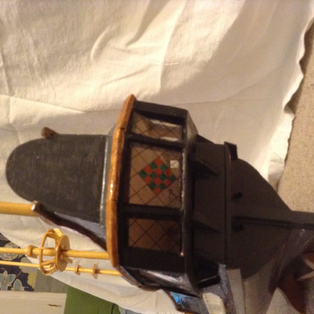

                          Remember to paint the inside of the cabin window frames befor fitting the Perspex sheet "glass"
                          #69711
                          Brian Muir
                            @brianmuir84327

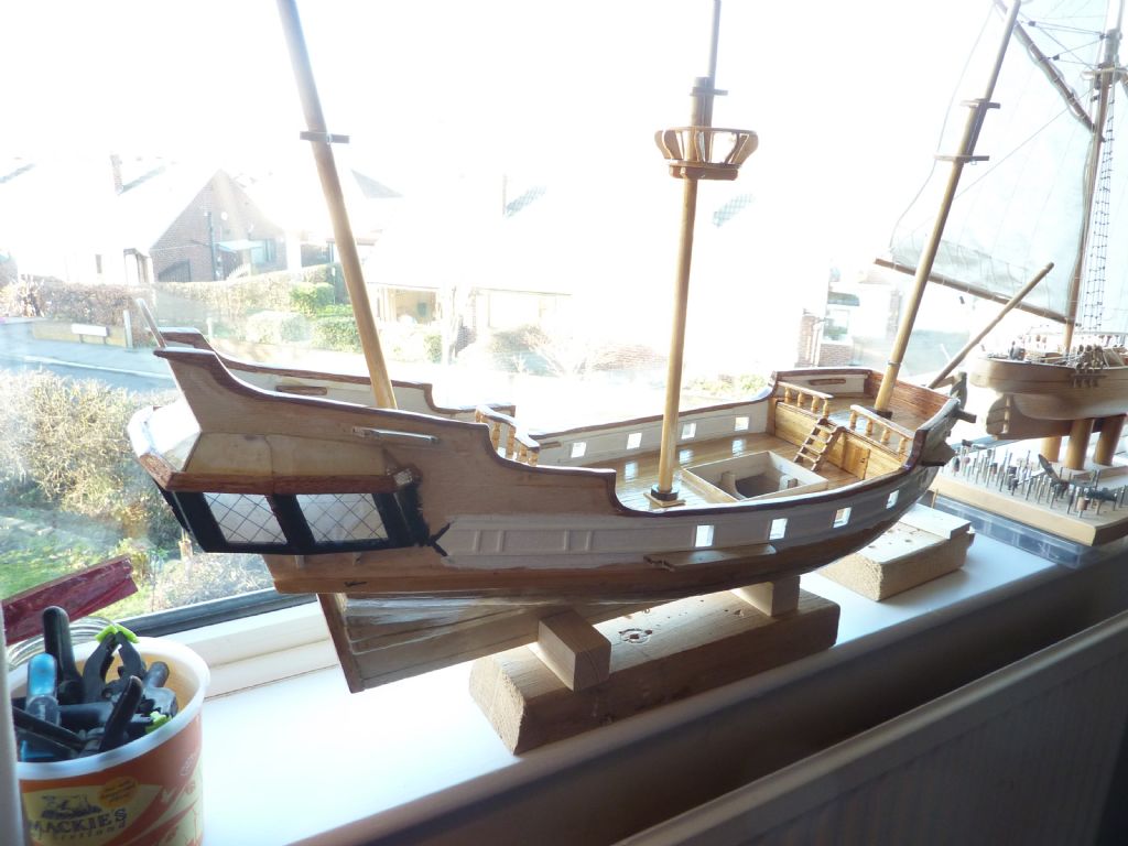

                            "Glass" in place including stained glass middle section, and cabin roof added
                            #69713
                              Excellent Windows, Brian!
                              The coloured effect is really nice and convincing!
                              Would be even nicer with some sort of lantern to highlight them?

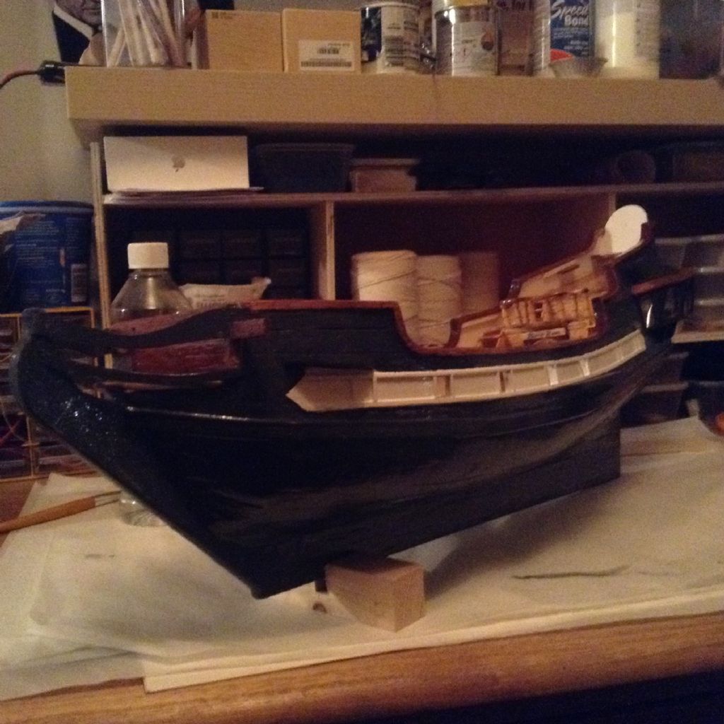

                              Brian Muir
                                @brianmuir84327

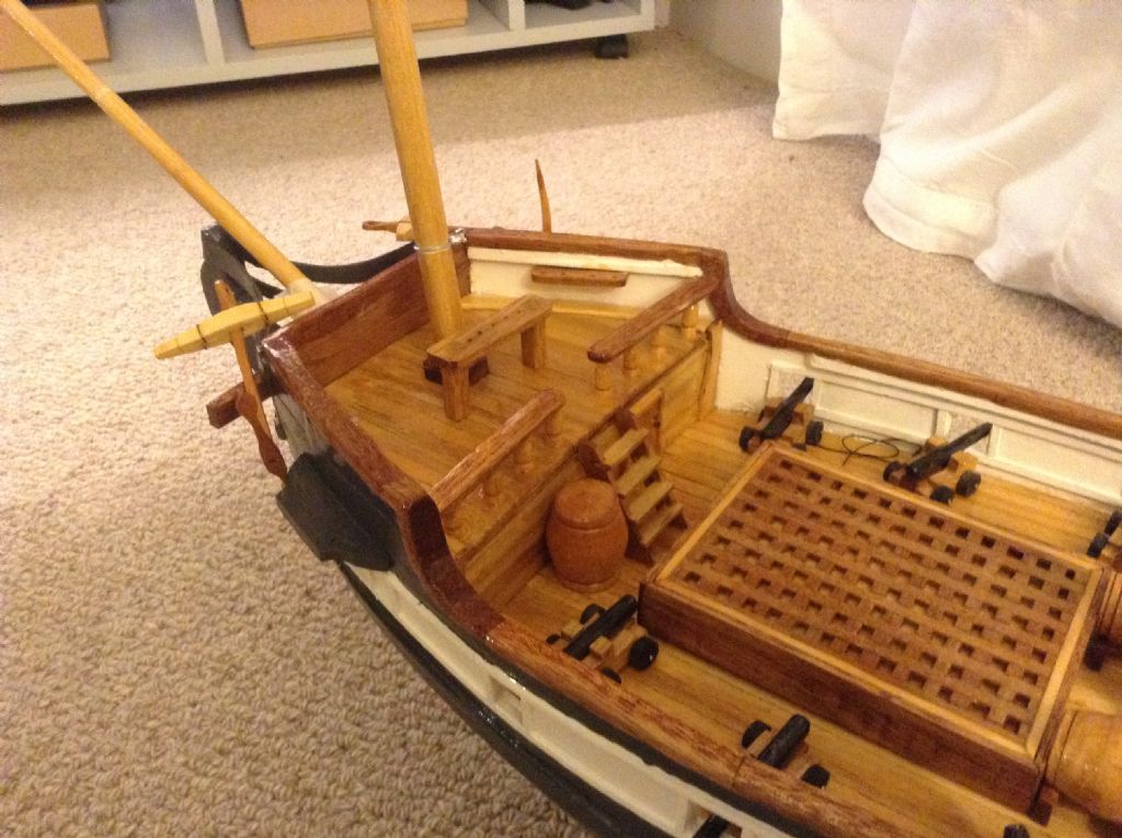

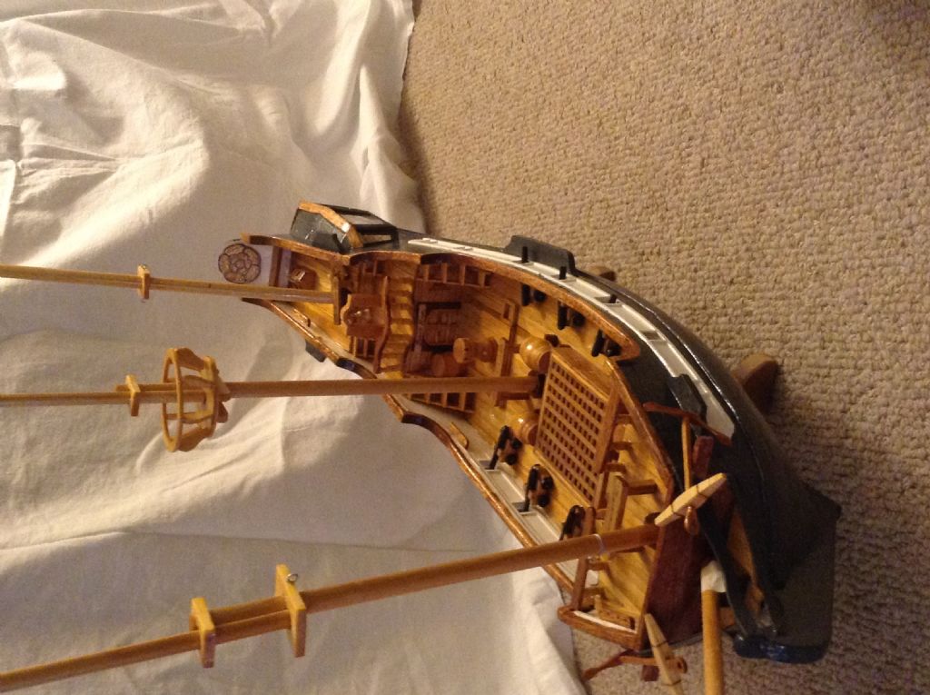

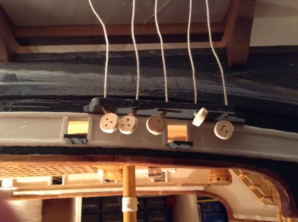

                                The dead eye fixings and the fancy bow pieces in place, all the bare wood now vanished, just the hull to be painted and the deck fittings fixed. Might add a lead keel and try it on the water, but I am dubious about this odd planking plan, the epoxy resin has sealed the gaps but they do look vulnerable? Oops, forgot the gun port hatches and the rudder!

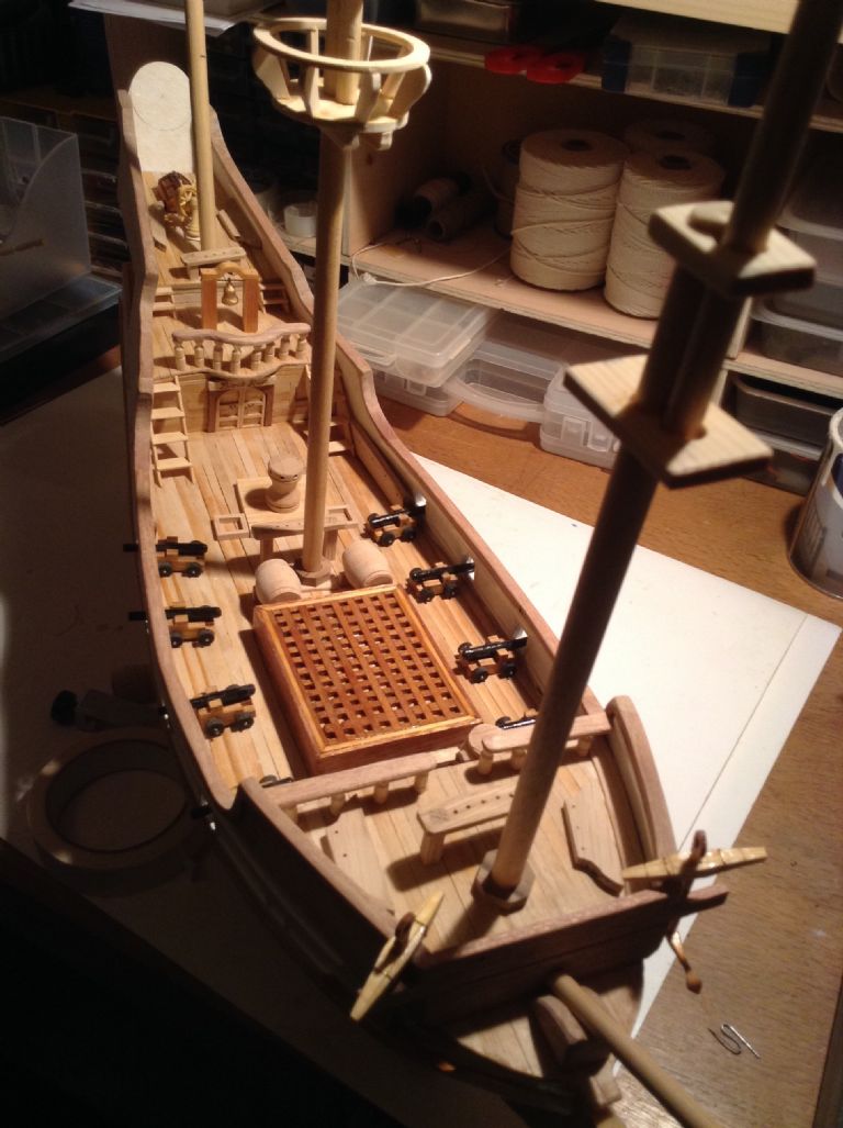

                                        Brian Muir
                                          @brianmuir84327

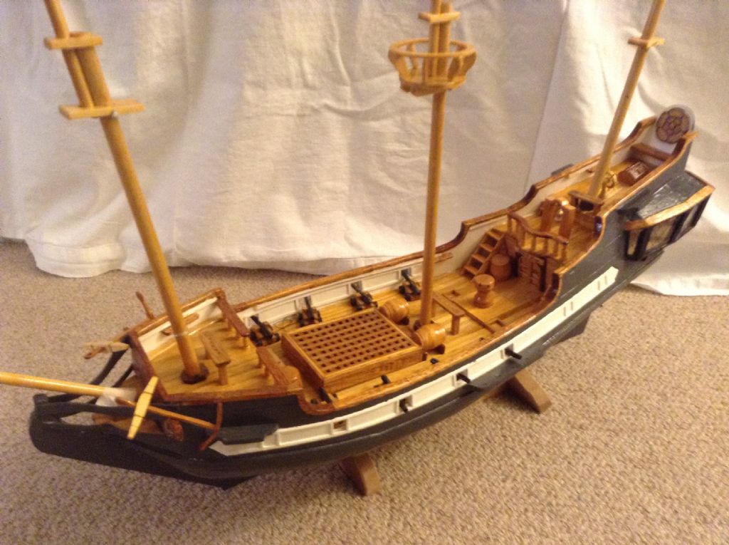

                                          Starting on the rigging
                                          #69828
                                          Brian Muir
                                            @brianmuir84327

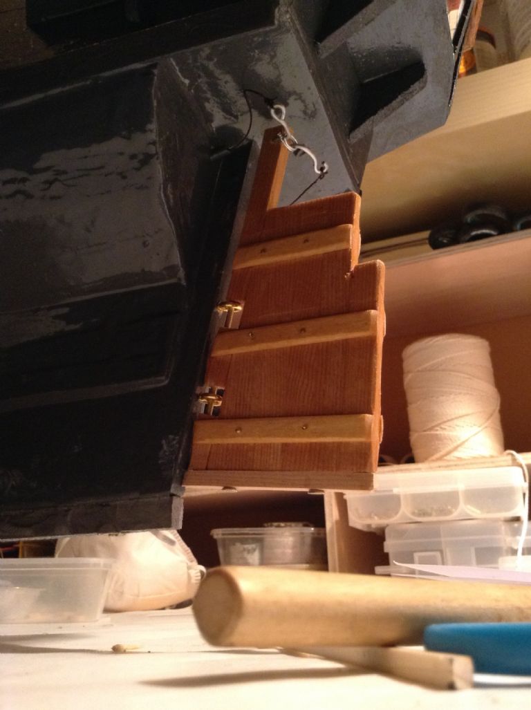

                                            Rudder in in place and lead strip on the keel, and lower dead eyes in place

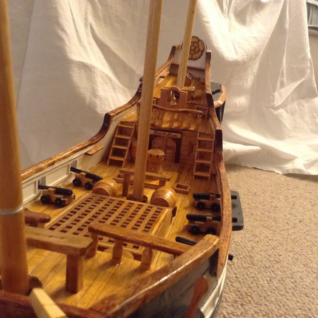

                                              How long is your model?
                                              #69834
                                              Brian Muir
                                                @brianmuir84327
                                                Ive worked out that it because I'm using an iPad which you can turn anyway around to take the pics. I have put on a lead keel and R/C steering to try it on the water in light winds, so not just for display.

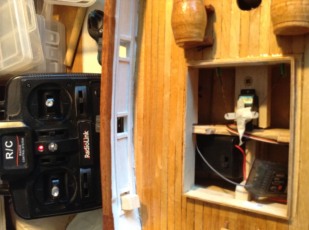

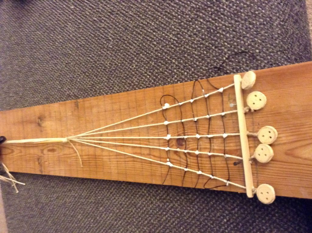

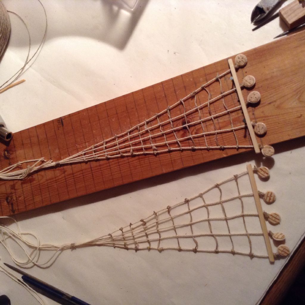

                                                  Brian Muir
                                                    @brianmuir84327
                                                    R/C steering gear installed
                                                    #69896

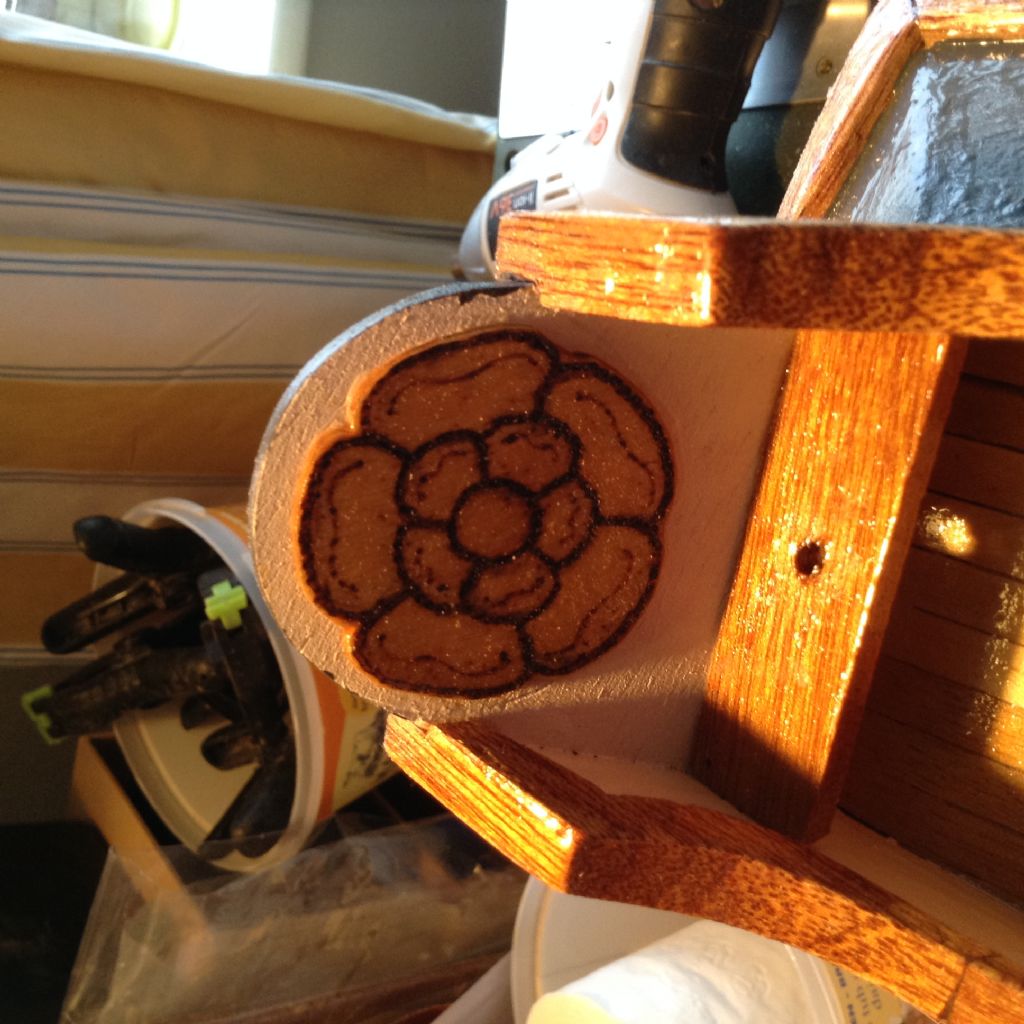

                                                    Brian Muir
                                                      @brianmuir84327
                                                      Rigging ratlines redone, and a rose emblem (pyrographed) on the stern.
