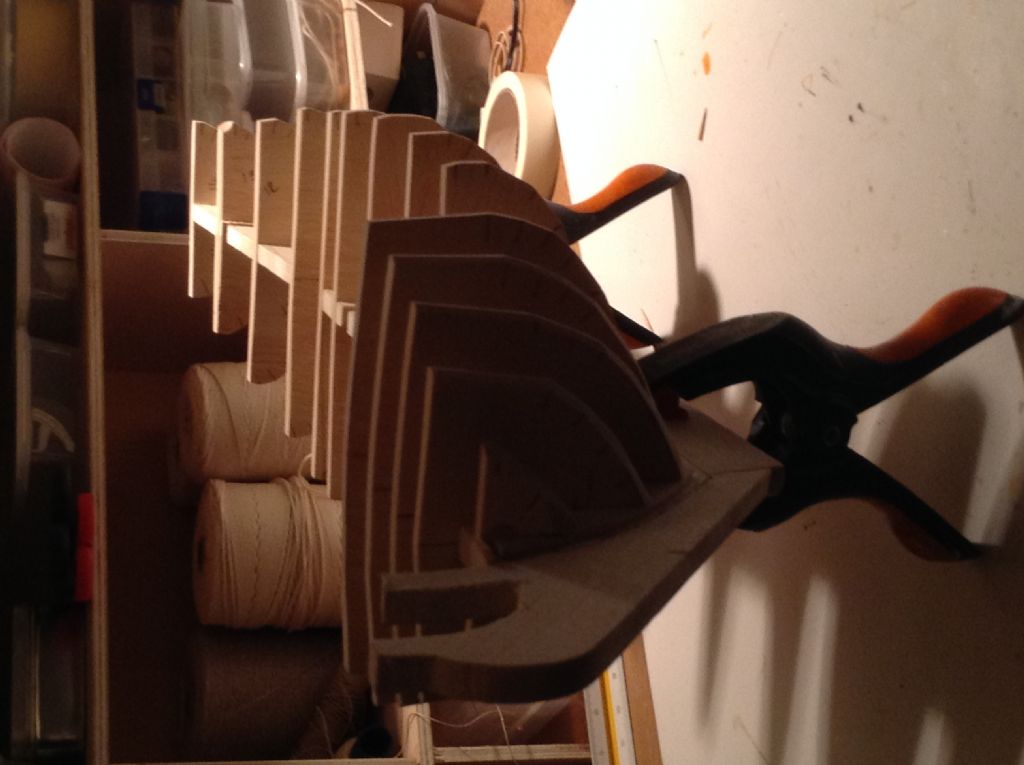

              Balsa is fine for a sailing model as long as you apply a suitable exterior finish to it e.g. lightweight glassfibre cloth and resin. Here are just some ideas I cobbled together a while ago **LINK**

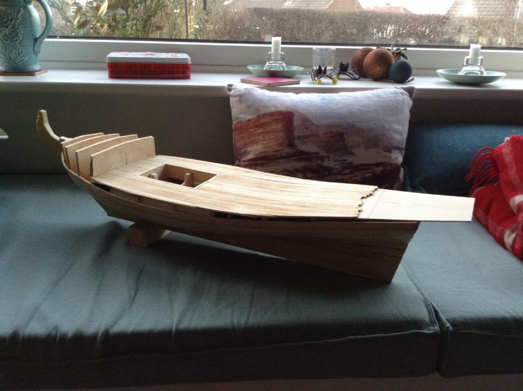

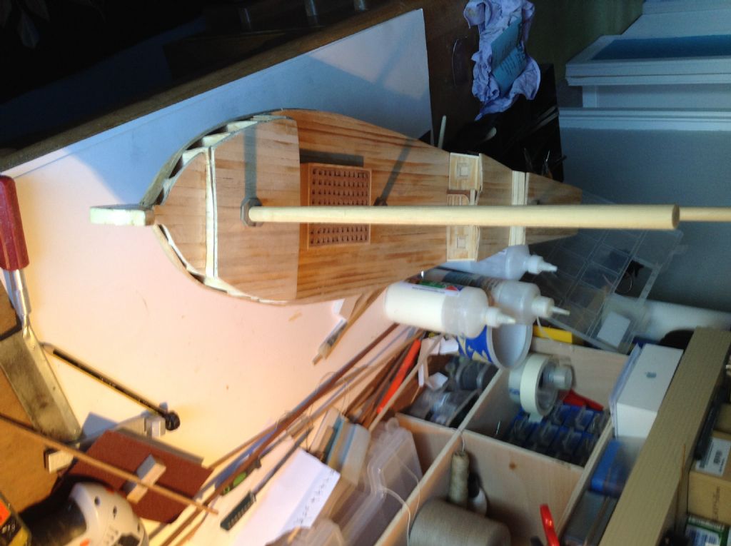

              #68977
              Brian Muir

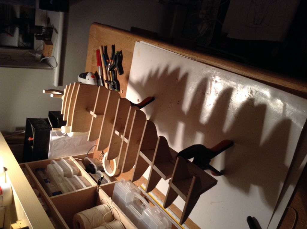

                @brianmuir84327

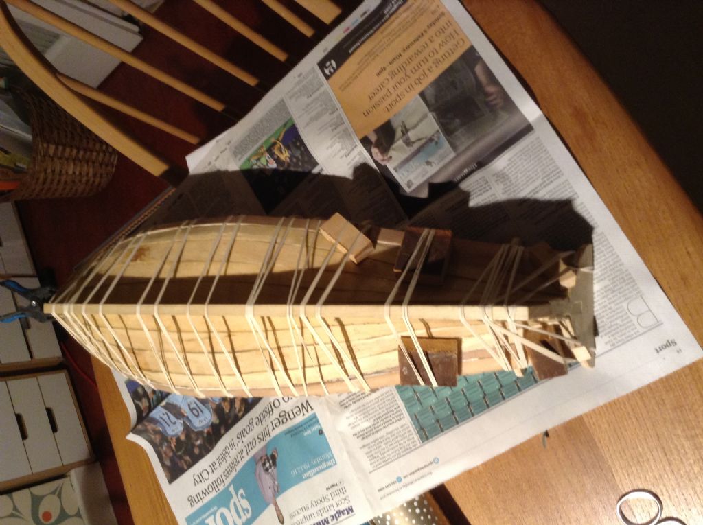

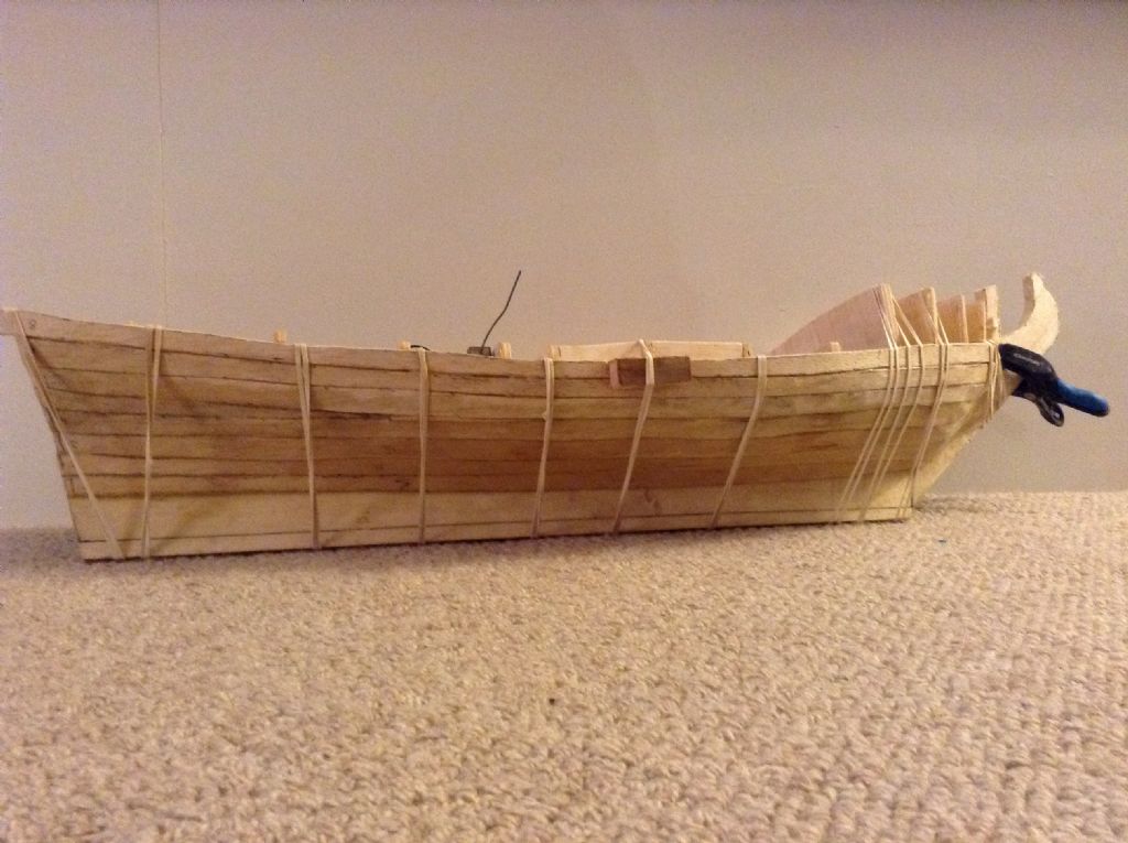

                image.jpegI have found balsa planking difficult to bend, is soaking it OK or does it need to be steamed? The keel and frames are in place now.

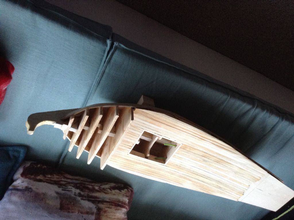

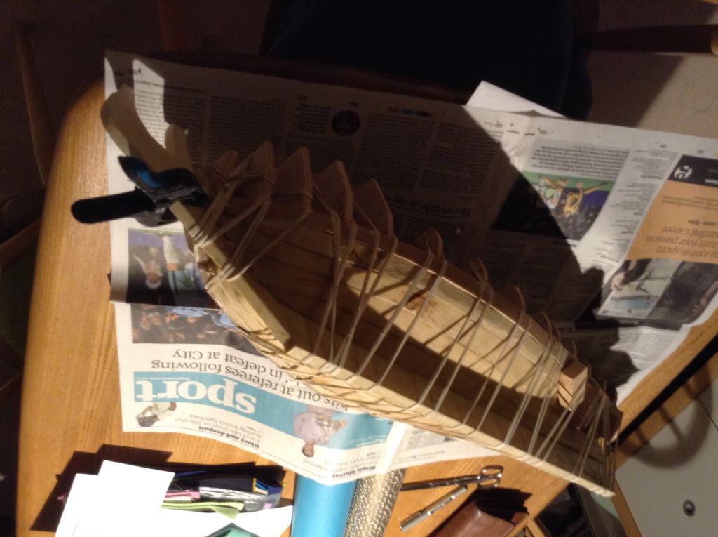

                #69104
                Brian Muir
                  @brianmuir84327
                  These odd shaped plank sections are very cleverly shaped but really hard to fit together neatly.

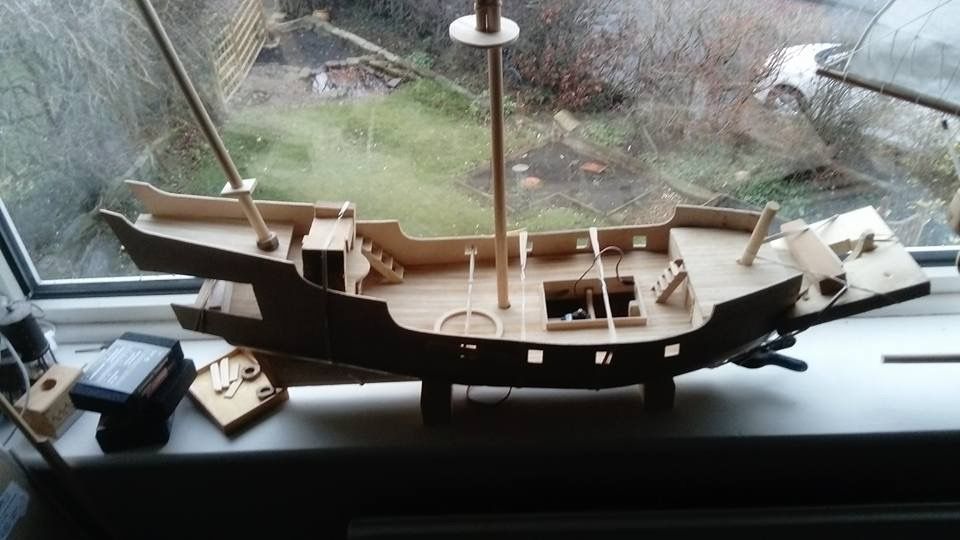

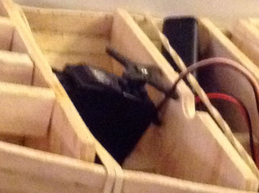

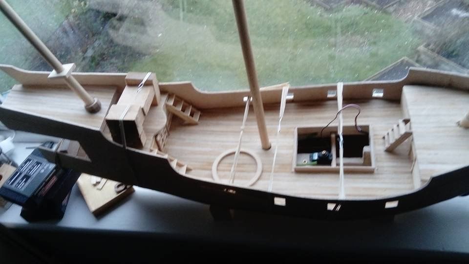

                    #69111
                    Brian Muir
                      @brianmuir84327

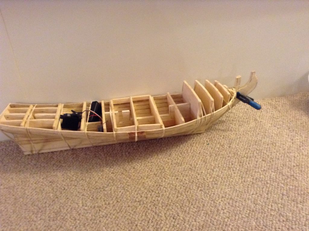

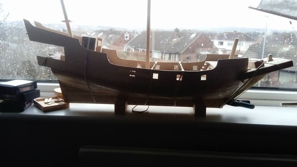

                      Last row of planking fitted, but I'll need a smaller servo for the steering. One thing I really do regret is using balsa for the keel, it is so easily bruised and is going to look battered by the time I'm finished, fortunately the model is supposed to to look weathered!

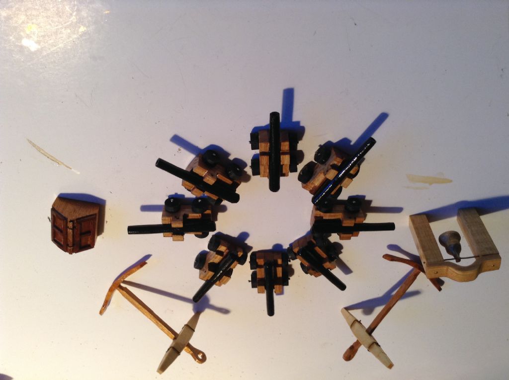

                      #69118
                      Brian Muir
                        @brianmuir84327

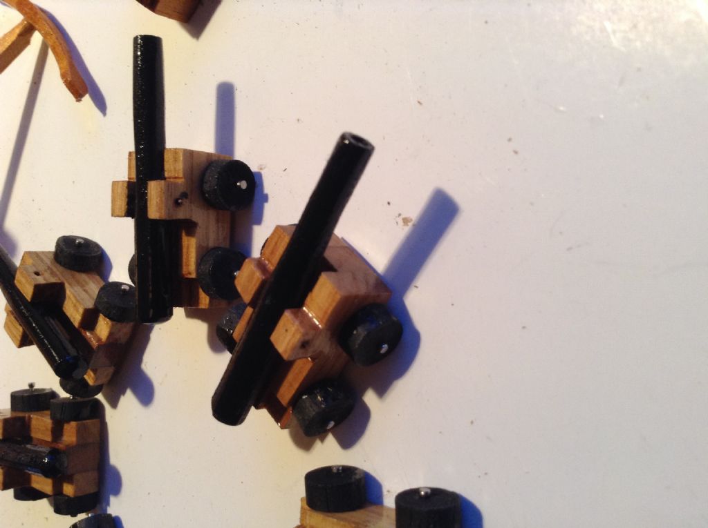

                        Guns, anchors, bell rig and cabin skylight made whilst the epoxy resin hardens.

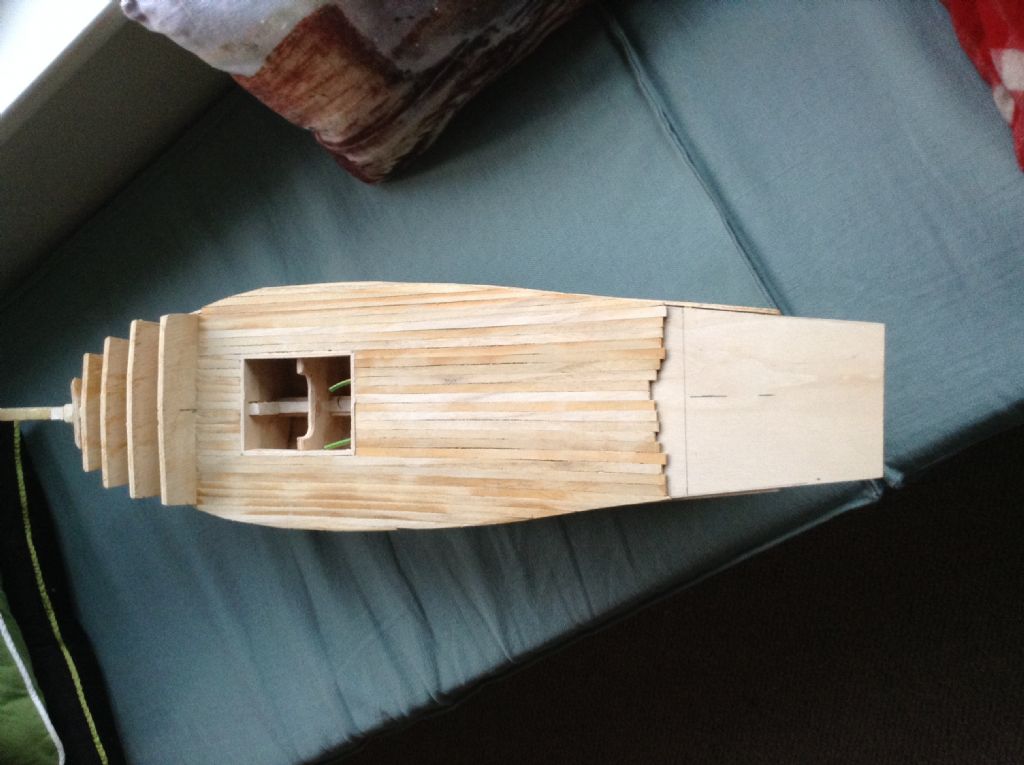

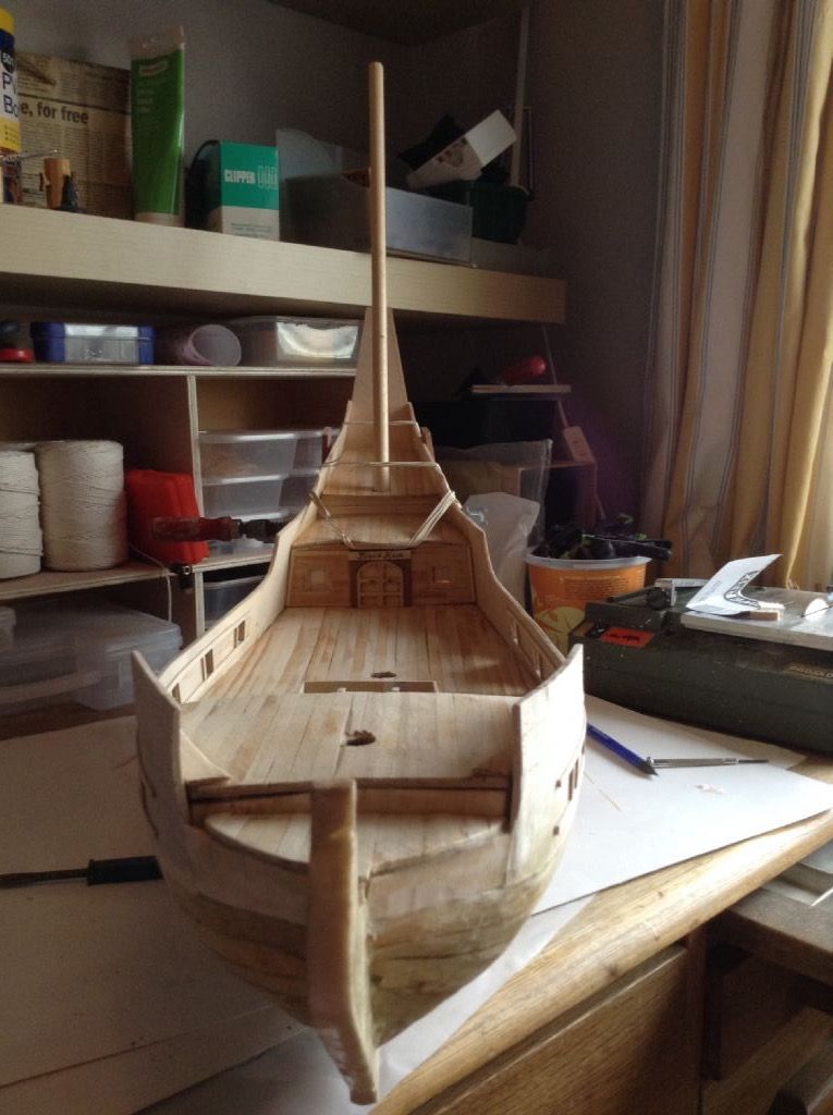

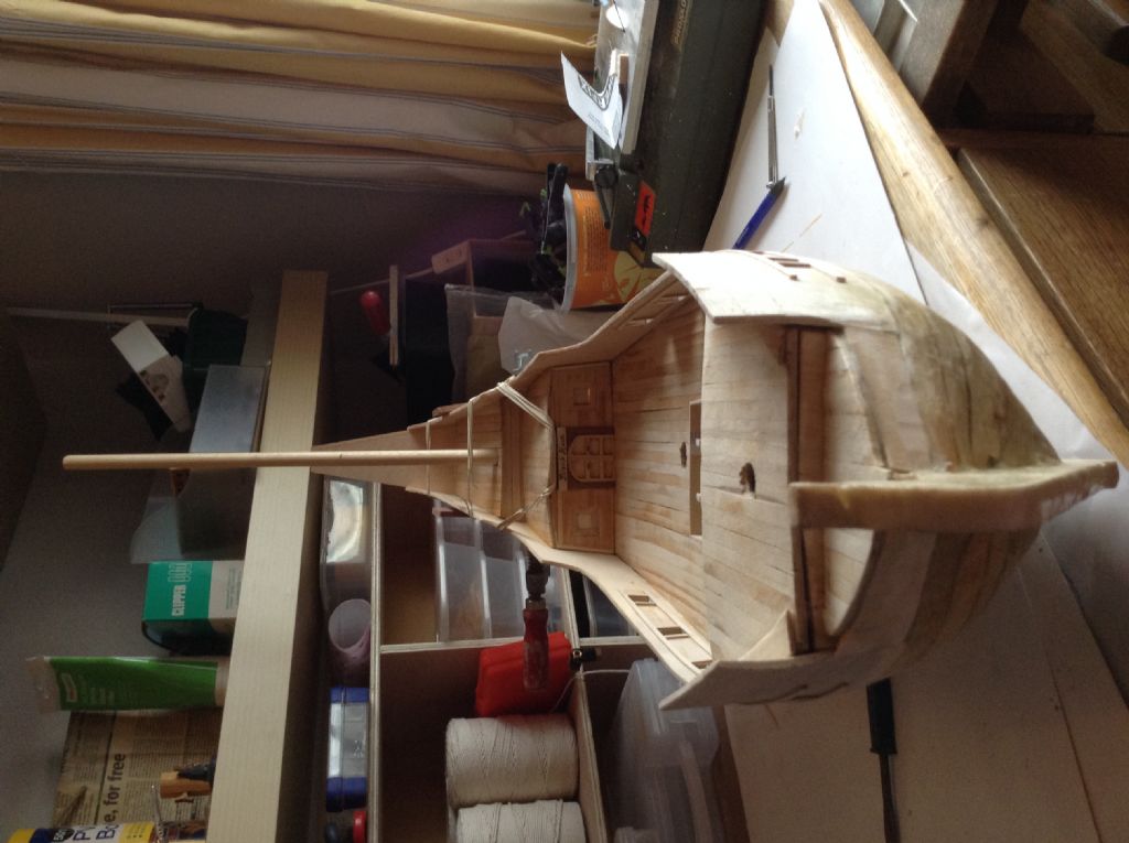

                          Deck fitted and planked

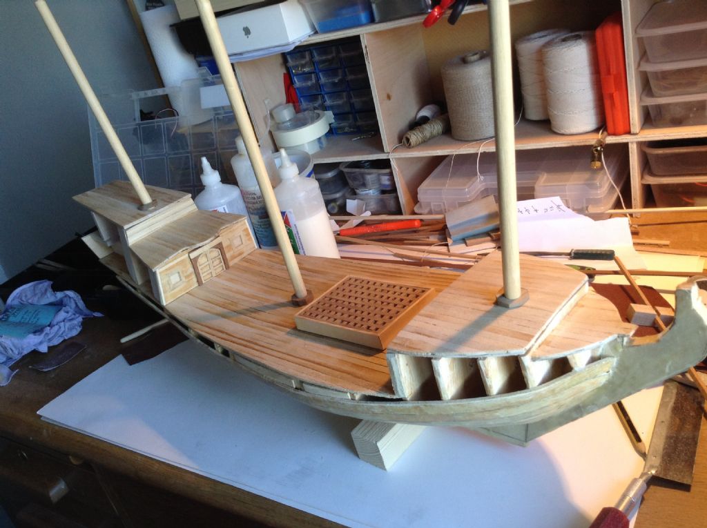

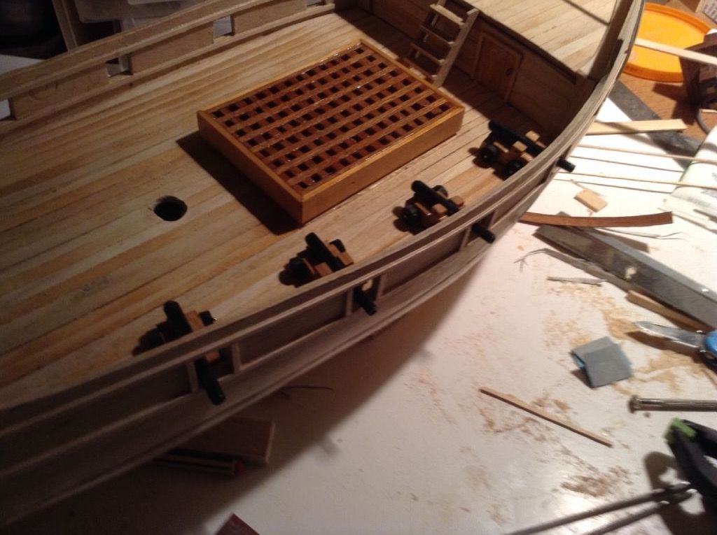

                          #69203
                          Brian Muir

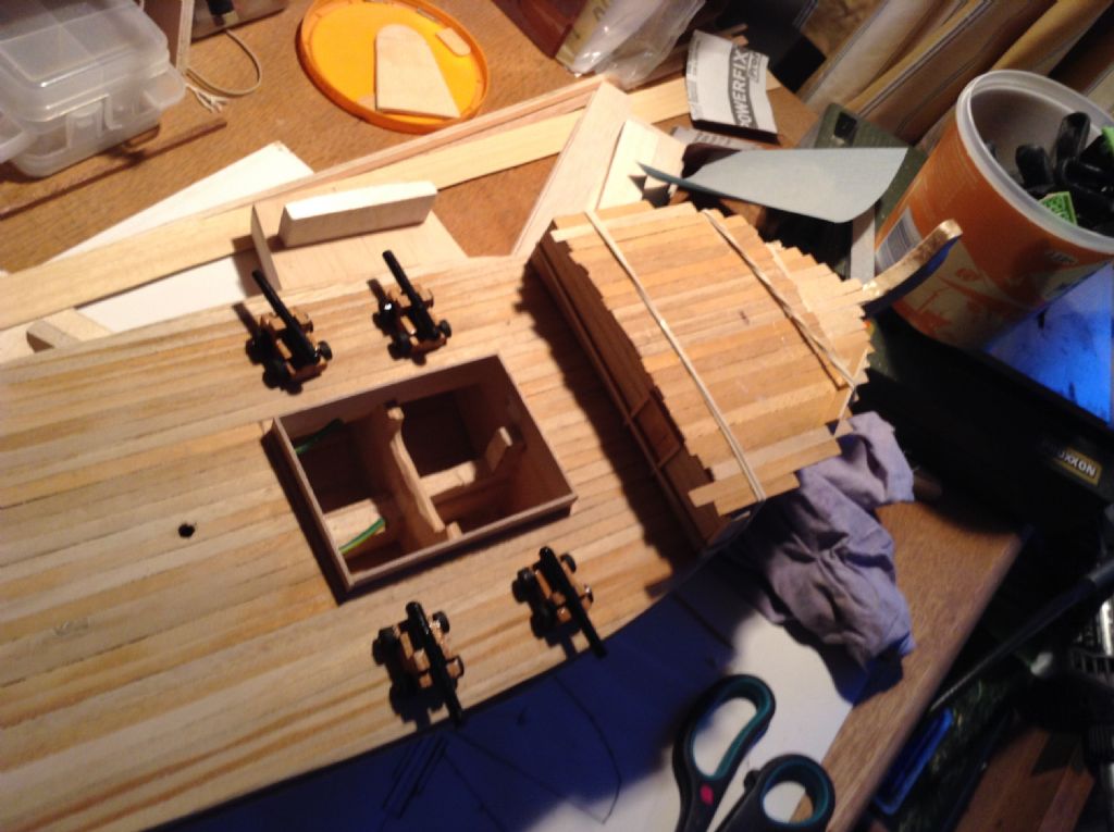

                            @brianmuir84327

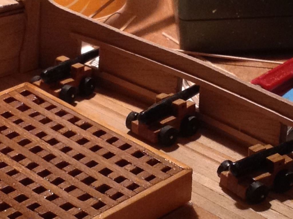

                            Fo'csle deck with planking, hatch combing to keep electrics dry, and checking the look of the cannon which look to be in scale

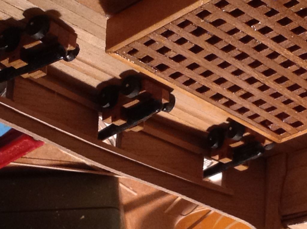

                            #69320
                            Brian Muir
                              @brianmuir84327
                              Gradually assembling all the different elements of the stern section, I am assuming that I have to fit all the cabin bulkheads and decks before fitting the bulwarks. The hatch cover must be the fiddliest  bit and the most work, all for the least visual impact, over 120 tiny tenon joints needed!

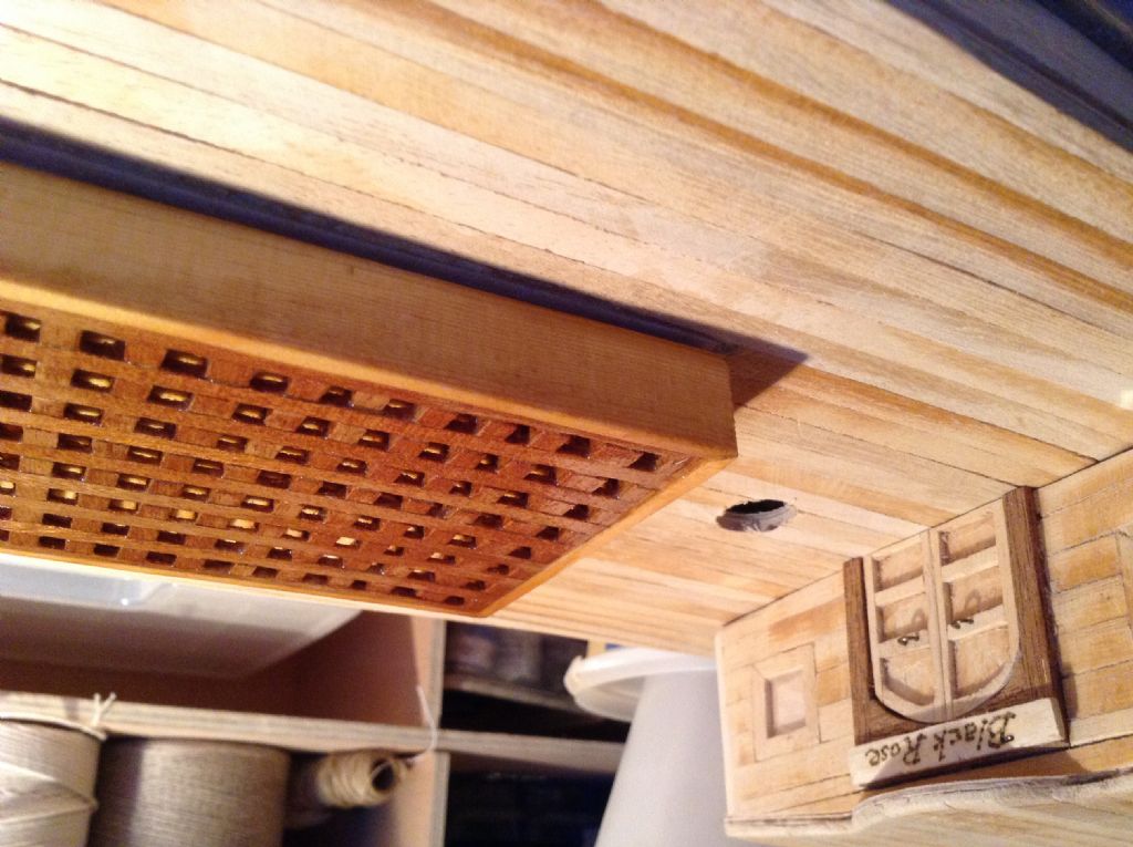

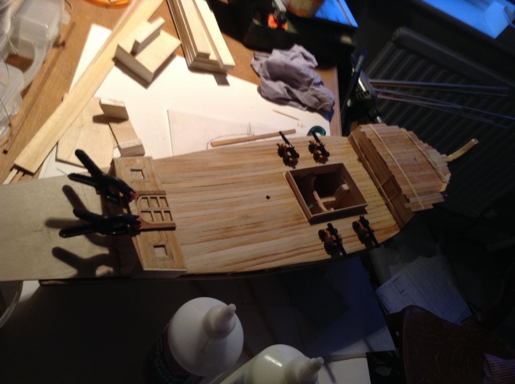

                              #69399
                              Brian Muir

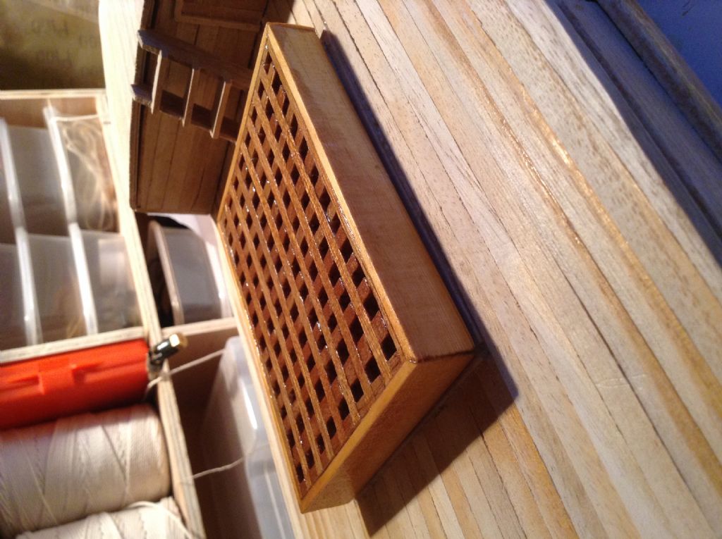

                                @brianmuir84327

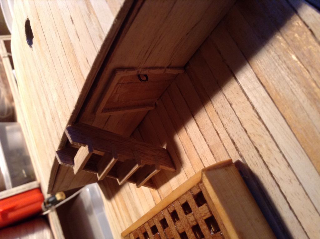

                                Varnished hatch cover, steps to foredeck done and inscription over main cabin door.

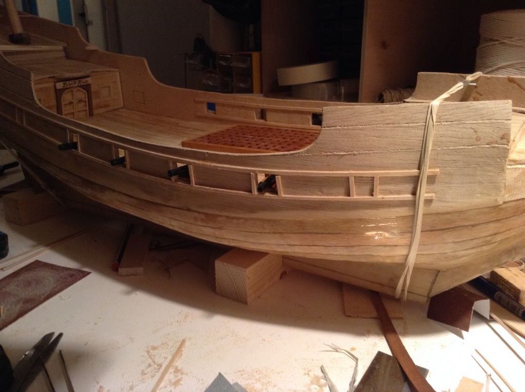

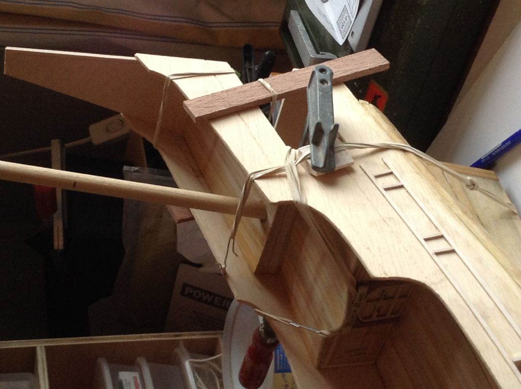

                                #69408
                                Brian Muir

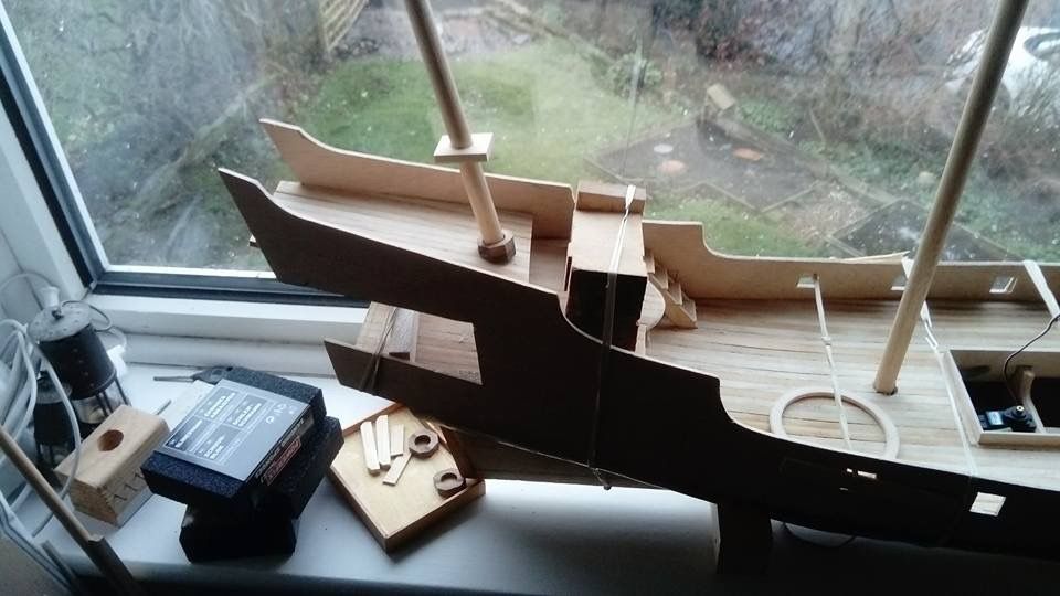

                                  @brianmuir84327

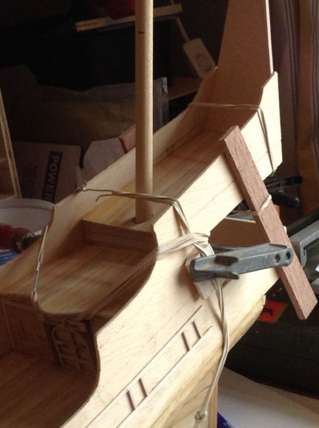

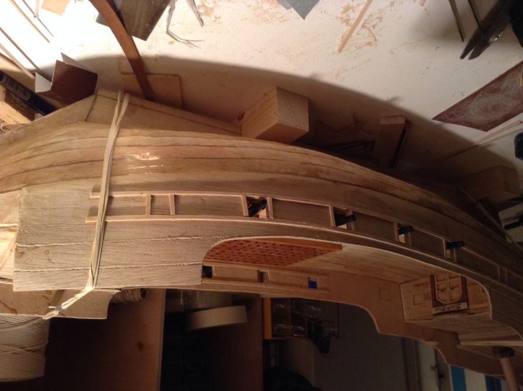

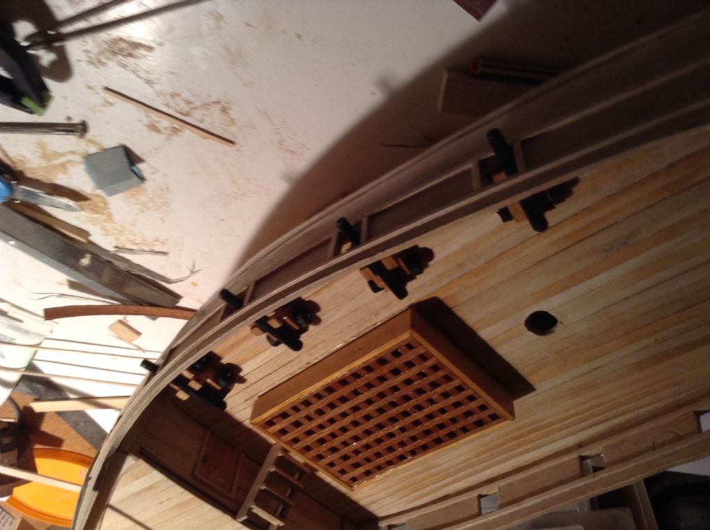

                                  image.jpegimage.jpegimage.jpegFixing the bulwarks, using an odd clamping arrangement around the bow, still a very tricky job for me!

                                        Trims around the gun ports in place
