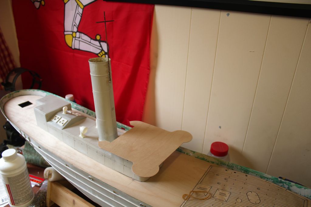

      Hello all,
      My first post on here!
      Just worried I might just give this the kiss of death with a build log going from past experience but here goes for Nothing!
      This will be my 3rd boat build ever. I was lucky enough to get this for the big 50 last month and have done a few small bits here and there, mostly outside as this yoke is quite large and unwieldly to move about in the Cabin I normally work inside!
      Lot of study was done on some forums of other peoples builds so I am not a pioneer and lucky enough to piggy back on some other fine build logs of this kit and will unashamedly use some of their ideas in my build.
      Some picture are below as are of the progress as of yesterday .So Far I have managed to attached the Skeg and rudder, some of the inside supports for the deck, the motor, Shaft and battery tray.
      For the paint Scheme I have yet to decide if it will be overall grey or a disruptive blue and grey colour scheme to add that bit more visual interest.

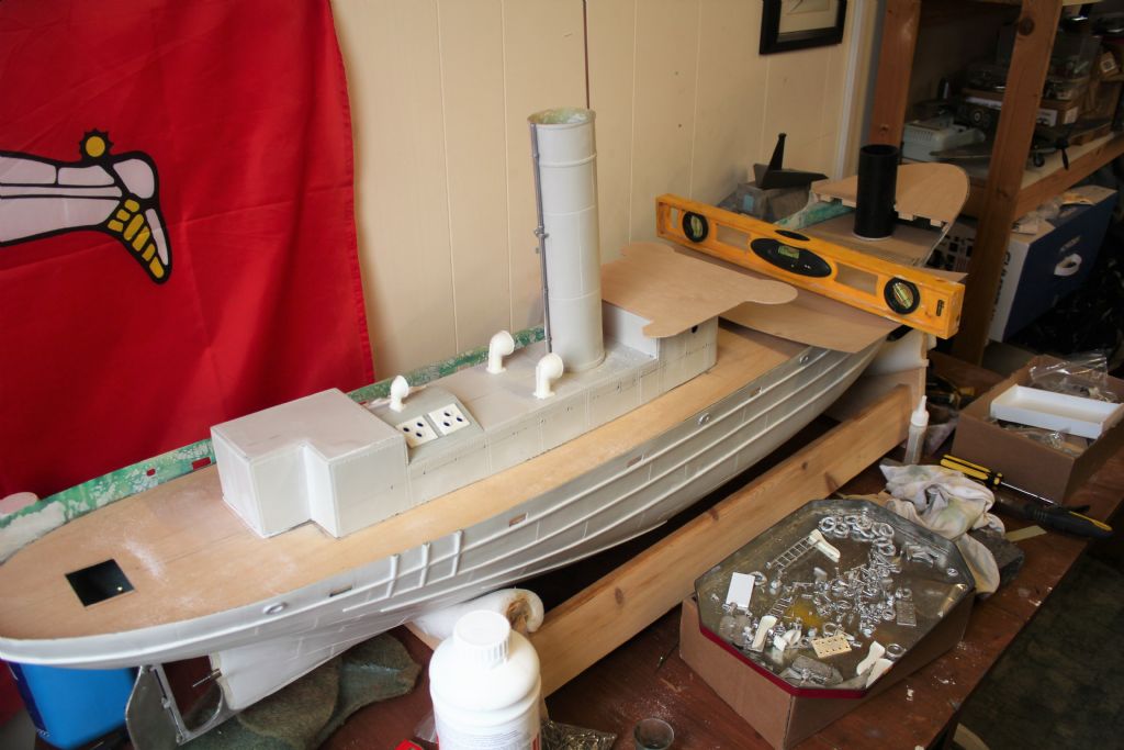

                      Any how bit more progress on this, I manage to pare down the deck to fit and then I work on the foredeck. I noticed that the Boat sides are not symmetrical, there is about a 5mm shortness on one side, you can see the ruler here placed by the strengthening supports and you can clearly see the difference. I cant do much with that so I just adjusted the side of the Bulwark rise to take make it nice and square. I am happy with that now. Just need to cut an opening now on the mail deck and for the Servo hatch. I hope to get some electronics next and a speaker from Action Leccy along with some Plasticard for some battery trays.

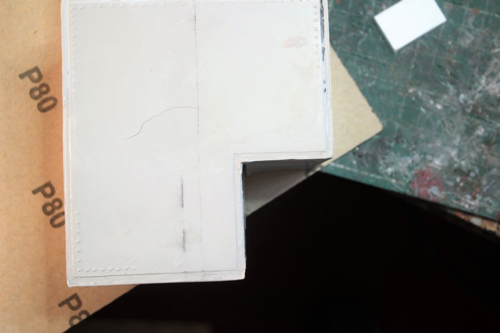

                        After having solved that earlier problem solved I popped out to the shed thinking to cut the deck access hatch out, A simple procedure but looking at the superstructure the lower part on one side has splayed out, might of been taken out of the mold too early. I am not sure how to fix this, It might have to be surgery with a saw, cut and reset the side or a brace internally but given the hatch combing a brace won't be low enough to pull the sides in.

                          Try warming it with a hair dryer and push it back to shape when hot and allow to cool. That sometimes works I have found.. GRP mouldings can be quite malleable if warmed up.

                              I have used this technique several times to sort out hulls which have distorted a bit after coming out of he mould. It's not an unusual occurrence. Hold the item in place while it cools and it usually sets in that position.
                              #91595

                                a Very quick fix, 30 seconds and its straight (almost) as a die!

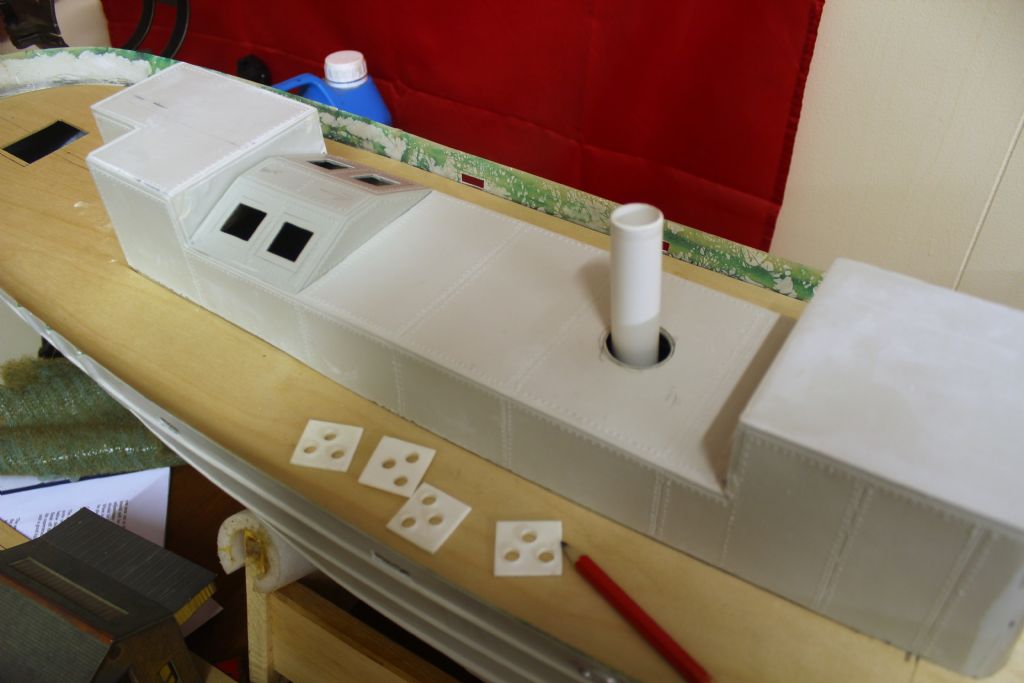

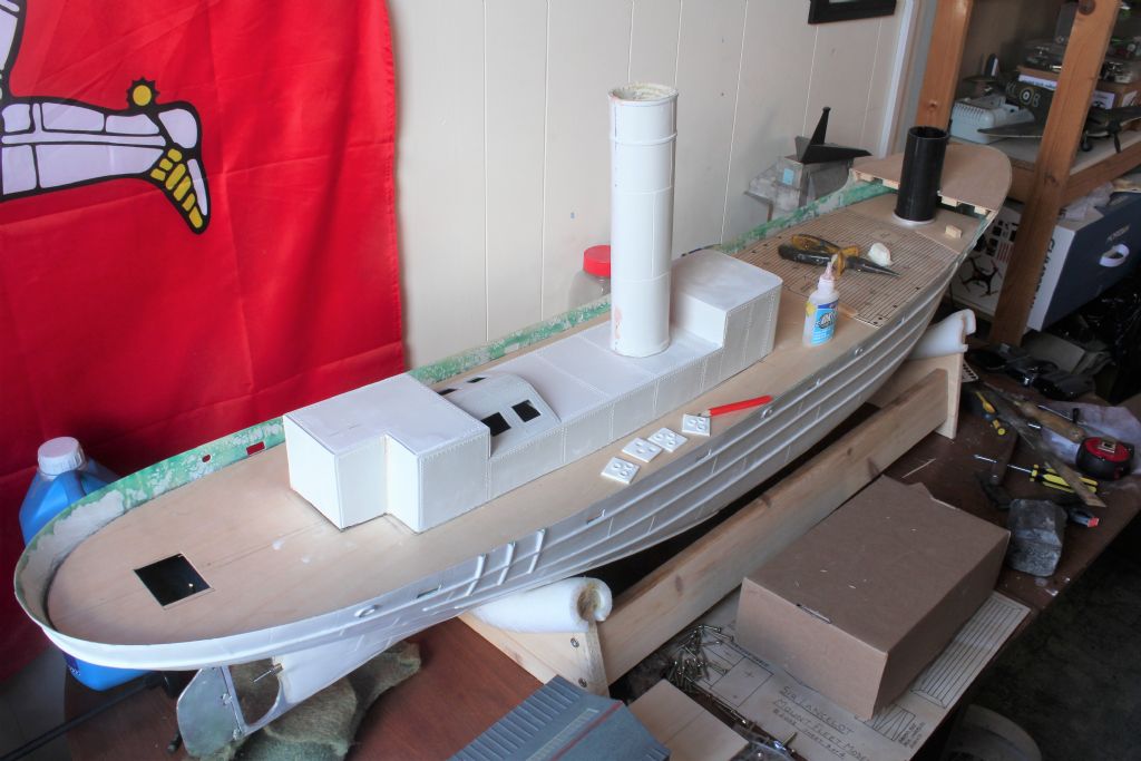

                                    Hello All,
                                    Been Motoring slowly on this one, Just waiting on some bits n bobs to arrive before I get the Deck Firmly in place. these will be a speaker and 'Noisey Thing' from Action Electronics, These are being made up so it will be a while yet.
                                    Anyhow here a few shots of progress, I need to Fathom out now how to curve the 0.08mm ply around the base of the wheel house. Should be fun!

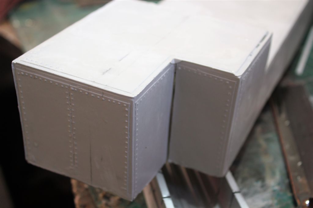

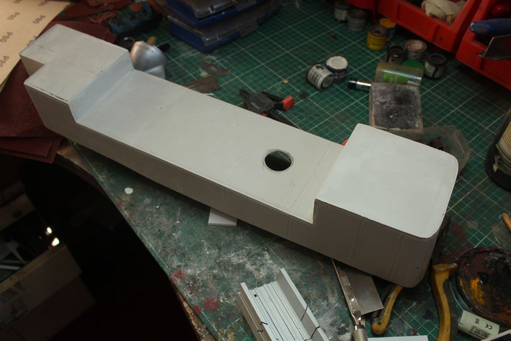

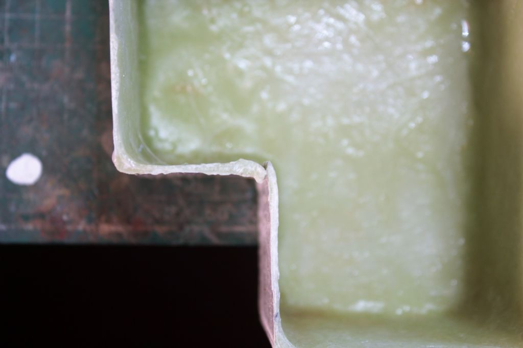

                                    The Superstructure unit was pretty warped in many places. A right pain in the you know what, It still bows back after manytreatments of the hair dryer.
                                    I had cut into the rear part as the part was not square and bugged me and the gap filled with P38, You can see in the first photo the parts re positioned and how nice a square it is now
                                    Shortly after that Victory I decided to move along and concentrate on Superstructure and started off with the Handrails and drilling the holes. I went to stick in the hand Rail Stanchions but these are pretty poor and mis-molded or short molded so and order went out for some brass ones. No point in putting Crap ones on it after spending out so much on the model itself so I will have wait for those to arrive also.
                                    Marks Model Bits Posted me over a Foggy unit, Could make one myself as I had a few spare Misters in the shed but time does not allow that so a tray was made for that and a hole sanded out. In the end I decided to Recess the Funnel into the superstructure for Strength and the whole shaped so the base of the funnel sat inside as no doubt if that gets a knock it will be a problem if it just sat there!
                                    I managed to straighten as best I can the Superstructure and have stuck the Engine room skylight parts also on. The Rear of the superstructure was about 3mm too high over the deck so a piece of plastic sheet was glued to the rear part and Sanded down so the unit sits nice a flush on the deck.
                                    You can see the rear of the Superstructure sitting a few mm over the deck.

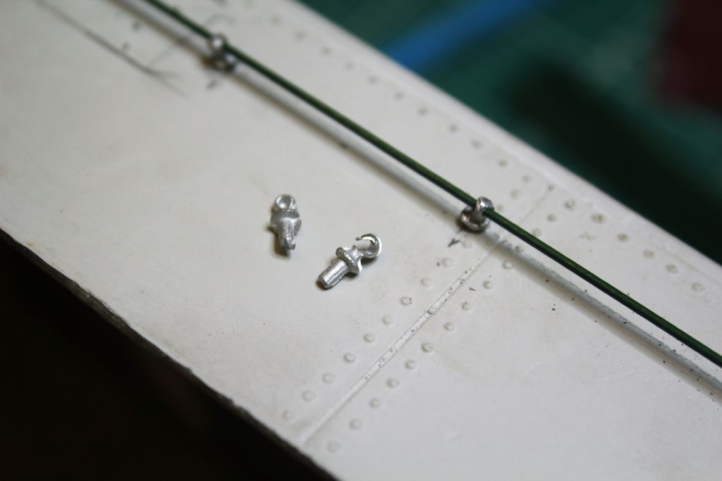

                                    I also stuck the Steam pipe onto the rear of the Funnel and managed to drill the 4 holes Waaaaaaay off Centre for the Mast so had to re fill those holes. Too much Rushing Rushing Rushing!!!
                                    To finish the hull I need a sheet of 14" 2mm plastic sheet to make the bilge keels, Of course I can't get this in Ireland right now either so another order to the UK for this will have to be made adding to the cost :/ . I don't fancy having the wood soaked each time it gets a dip so plastic is better for me here.
                                    The Vents are just placed BTW before you start to Panic! I will use brass / Alloy tubing for the Vent Shafts even though dowls are included, The Vent cowls are not the best TBH so I will think about replacing those if I can make them a lot better after some grinding with the dremel.
                                    Next the 0.08mm Bending Miracle around the base of the wheel house floor section!

                                      It sometimes helps with uneven GRP superstructure sides to glue and clamp a length of square or rectangular section rigid wood along the inside where it won't get in the way of anything else.
                                      #91961
                                      George Norman
                                        @georgenorman68347
                                        Tks Colin,
                                        I have the combing just inside the lower part where the section would have to be and thats where the warping us, I have tried clamped Steel rulers heating up and cold water but over time it just comes back out! Arrgh, We will keep at it!

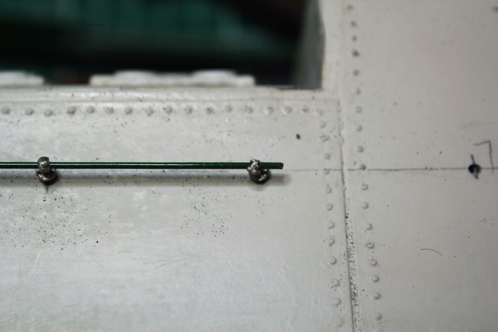

                                              Another small step forward in this Build, Managed to tackle the handrails, Was dreading this is the stanchions are white metal and easily damaged so careful bending of the wire to take any loading off them was needed along with a lot of patience.
                                              The hand Stanchions are soldered to the hand rail capping. Of course when I had the holes drilled I then noticed one handrail side was longer that the other so the incorrect holes are filled now and need to be sanded smooth.
                                              The handrails are not glued in place just yet as I have to do some more work on these and paint the deck again and the 'straight part' of the handrails capping is slightly thicker than the front piece.
                                              Also you can see I made up the Flag Locker on the front and was cut from the guides line printed on the ply but as you can see this is a lot smaller than it should be so a new wider one will have to be made. I have learned now to double check on the plans twice!
