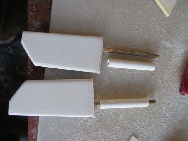

                  Part two of the rudder construction…
                  drill and cut out the slot in the centre slice of the rudder and make sure the two sides are not forced out by the brass rod.
                  glue on to the centre section one of the outer slices.
                  using 30 minute 2 part epoxy glue into the slot, the brass rod.
                  once set, remove any residue sticking up from the slot and rod with a knife and abrasive paper.
                  finally for this part of the build, glue on the other outside slice, giving two rough but complete rudders that wont ever work loose on the stock, and waggle in the wind.

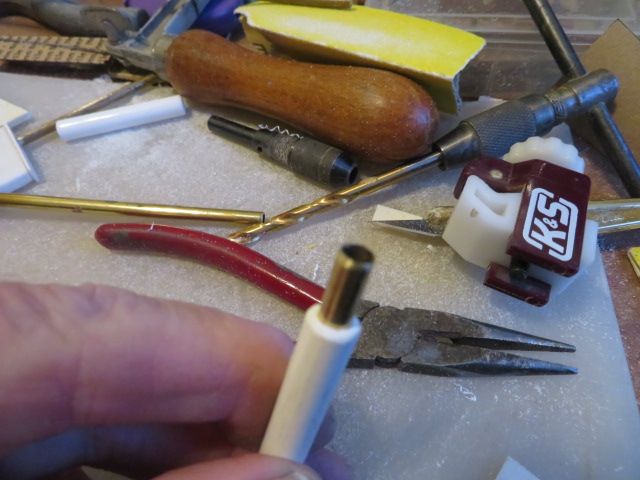

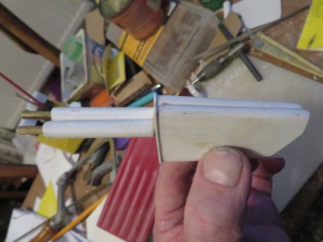

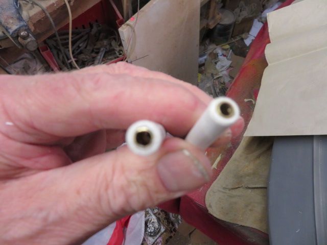

                      which brings me to Rudders, part 3 lol.
                      Part 3 of my rudder construction for the Tyne.
                      I like to make my models as maintenance free as possible.
                      and so, after sanding and trimming the rudders to shape and cleaning them up. I thought I would use my normal method and take some thick walled plastic tubing from plastikard, Matlock for the rudder tubes.
                      tough, strong and perfect for threading some brass rod through………no reaction between plastic and brass, self lubricating and normally the brass would just fit, with very fine tolerances………..
                      ahh, there came the problem. I had run out of my old internal diameter plastic tube for the brass rod of the rudder shaft………….and the plastic tube I had was of a bigger diameter.
                      not to worry, I found some brass tube with internal diameter perfect for rudder shaft to fit in, but just too large outside diameter for the brass to fit into the plastic tube.
                      found a drill bit the same dia. as he brass tube outside, found my larger mandrel and reamed out about 10mm of the plastic tube to take some small lengths of the brass tube to act as bearings.
                      took the bits and pieces to the workshop, and using my small engineers vice as a bearing press, inserted the "bearings" into the plastic tubes…voila' Two bearing tubes to take the rudder shafts!……..scratch building brings out all sorts of creative thoughts.
                      Edited By neil howard-pritchard on 26/05/2020 22:57:45
