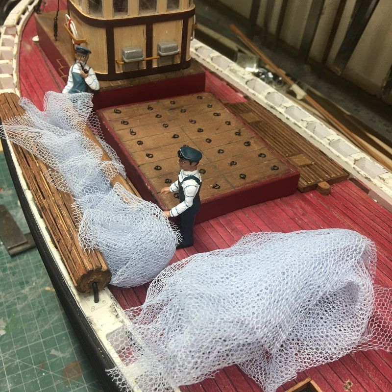

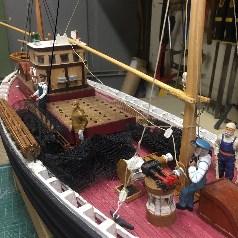

      It's always good to have the opinion of otherssmiley
      The actual nets were 1 1/2 miles long, I don'tthink I could fit that amount of net, at 1-32 scale, on the boat.
      BTW I couldn't get black net, they had sold out.
      Regards.
      Eddie.
      #87869
        Hi Eddie – yes, they do look better now. At least you can always replace them in the future once you are able to look around freely.
        #87870
          When I was looking for muslin material for the London, I was amazed at what was out there.
          There are loads of net/mesh materials at a haberdashery, and if they won’t dye, I am sure a wash with acrylic paint would do. Hair nets and stuff is quite good?
          As Chris says, once you can get out then you have a chance!
          #87871
            Have just looked in the shed and I have an unkempt square of fine nylon/plastic mesh that’s green, roughly 11 by 13 inches.
            Pm me and I will post it to you if you want (it will go in a letter). I think it might do.

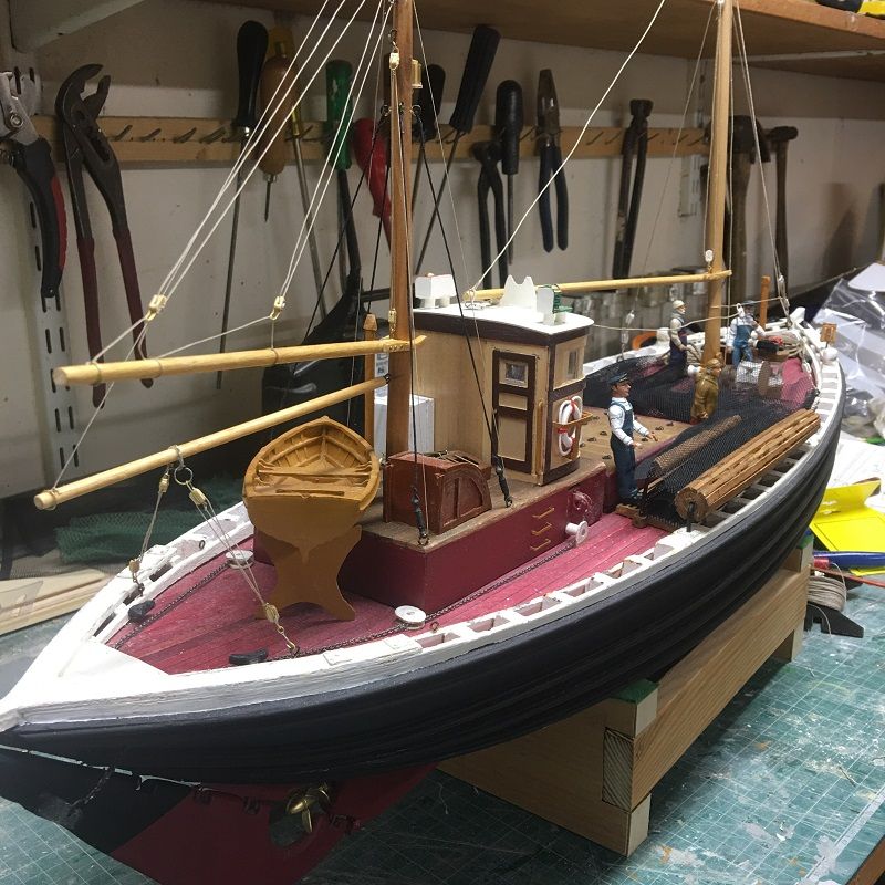

              Have been working on Zulu today, waiting for the materials to arrive for the Huntsman, I have rigged the missen mast, using .75mm. rigging thread and 4mm. blocks, quite a fiddle for my fingers,I don't know how Bob manages to rig his tiny ships.
              Back to the Fairey's tommorow, putting the glass fibre on, then back to Zulu while the resin cures.
              Regards.
              Eddie.

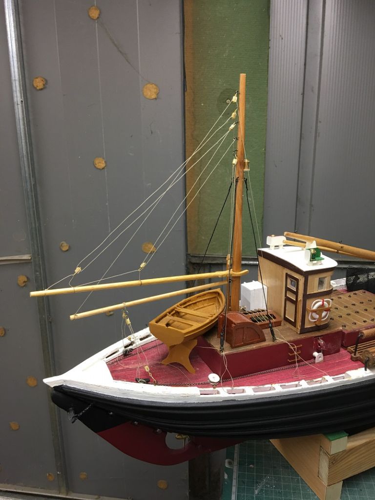

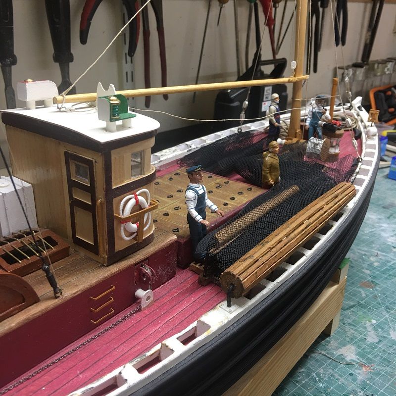

                Zulu is now finished, most of the crew are on board getting ready for their first fishing trip,as soon as we are allowed out.
                The fishing nets are much better now thanks to the generosity of Ashley, thanks Ashley.
                Regards.
                Eddie.

                  Nice job Eddie, will look good on the water. Do you remember that! smiley

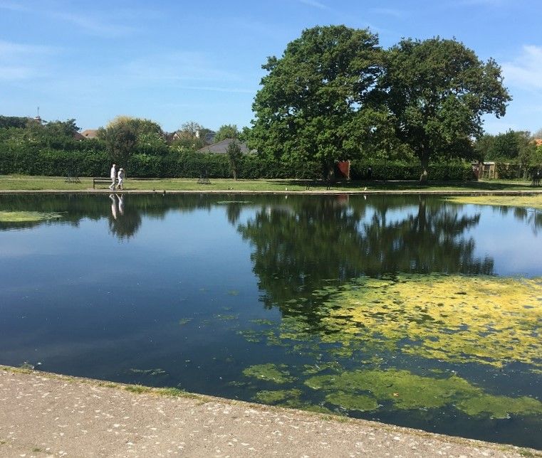

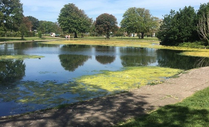

                            We took a drive out to Herne Bay this morning,this is how we found it, 3/4 covered with blanket weed blooms, with a small area that looks clear enough to sail a small boat.img_0578.jpg
                            Not many people about.
                            Eddie

                              Disaster! Not worth sailing in a small area `coz you know what will happen, and you will be wading ¬!!!

                                Yep, you don’t know what’s lurking at propeller depth angry. I will have to wait till I get home, our water there is crystal clear, or should that be gin clearwink?

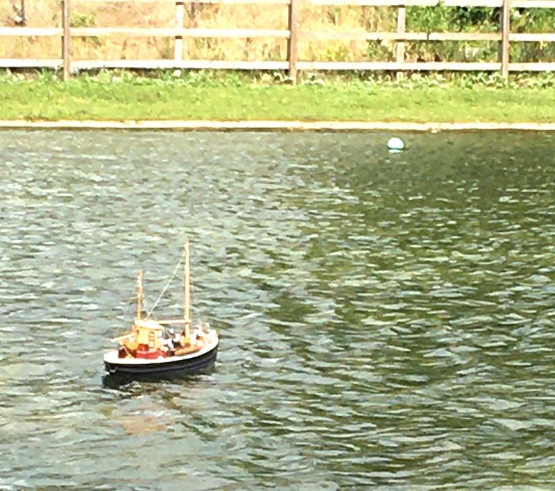

                                  I have at last had a mornings sailing, I took Zulu to Wicksteed Park boating lake yesterday,the wind was blowing a hooley. I was not sure how well she was going to steer as the rudder is steeply inclined and the prop runs in a cut out in the rudder so reducing the prop wash over it,but I had increased the width by nearly a third from the drawing and despite the strong wind she handled very well when under way.
                                  Because of the strong wind I was only able to take my hands off the controls to take one photo,
                                  Now that I am back home I am finishing the keel for the IOM and hope to get that on the water next Sunday.
