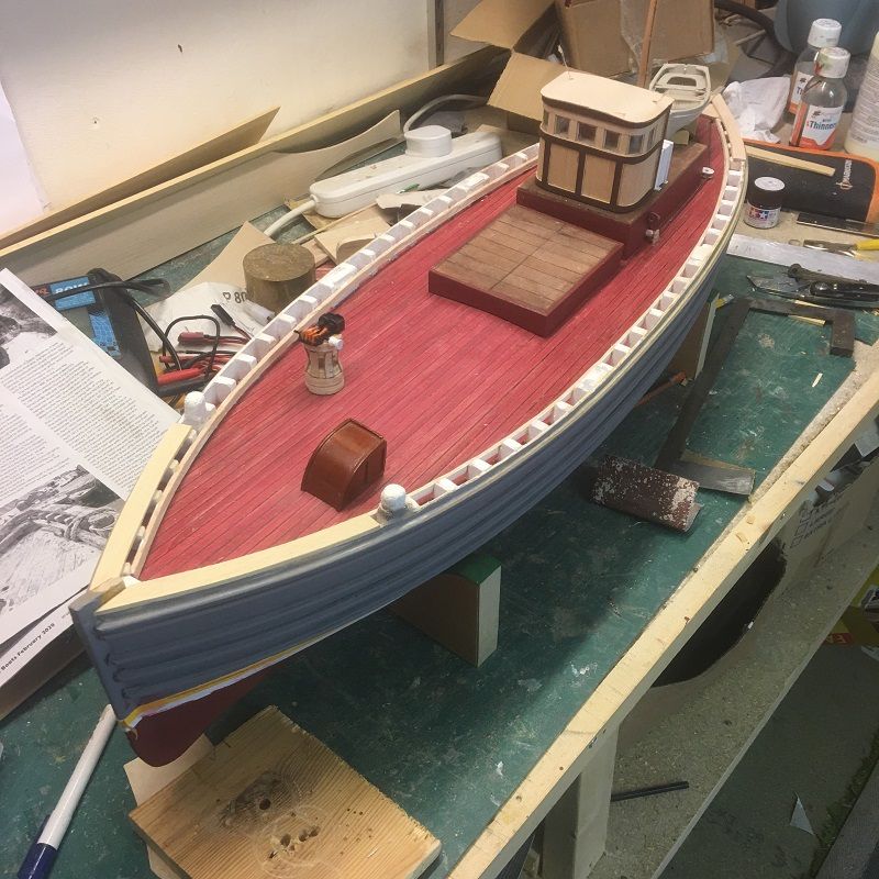

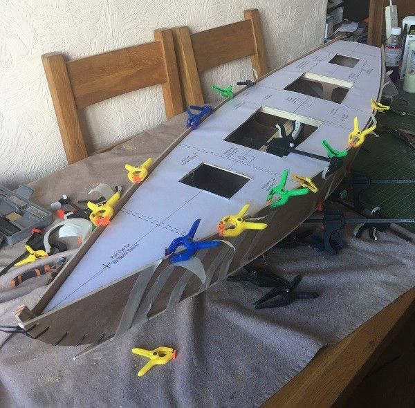

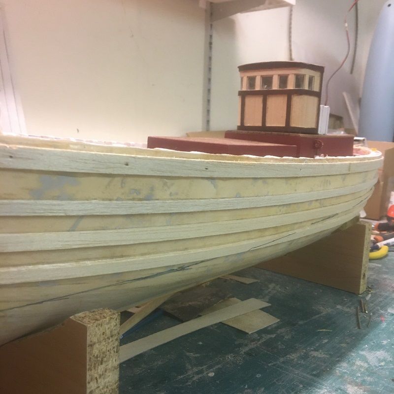

      Hi. all, I have been working on my Carona boat over the past few weeks.
      It is Jim Pottinger's Zulu, a free plan in the Feb.issue of MB.
      It started as a boat to be built down here at Broadstairs when I was visiting after barge racing at Bluewater but it became a full time build after I was caught down here in the lockdown in mid March.
      I didn't take any photo's of the early part of the build but have taken some with my iphone, to get around the problem of the phone rotating some of the pictures I have set it to take them in square format, we will see if that works.
      The first pictureis of the hull qnd rubbing strakes, I am waiting for a delivery of half round beading to finish the strakes ready to paint the hull.
      The deck laid with 5×1 mm.lime with black card caulking, the paint was rubbed into the wood using kitchen towel and sanded back to reveal the cauking and grain, I want to finish this boat to look like a working boat so I will be trying my hand at weathering, another first for me.
      The stearing is by chain as per full size.
      Hope you are all keeping safe.
      Regards.
      Eddie.

            #87095
              Eddie. That looks….busy… a lot of strip-work and blobby bits on deck….AND you have planked it!  Well done!
              Ray, great photo….where's the beer???? Ashley
              Edited By ashley needham on 22/04/2020 17:20:48

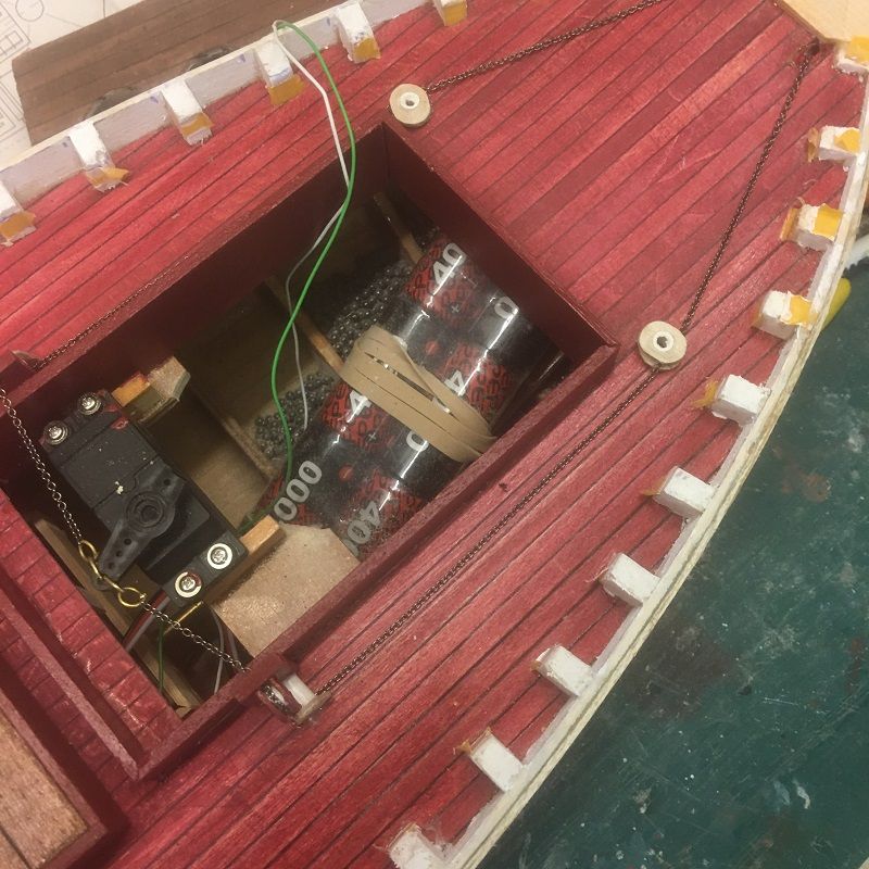

                        Hi.Ray and Dave, the lead is in stock, not from the church roof this time, I thought I had better leave it for a while.
                        Dave the laser cut ply sheet is in my kit, and thanks for the tip about the driver, I will keep that in mind when I / we get to do the test run.

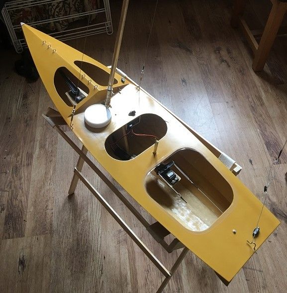

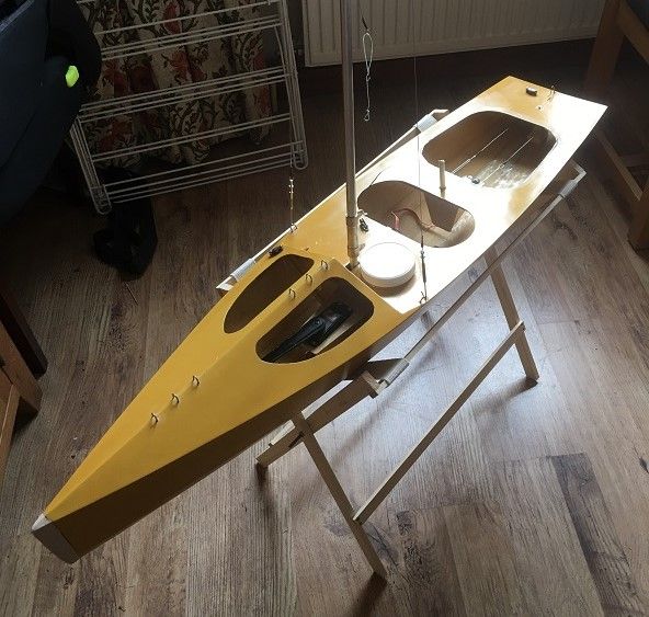

                              Another boat waiting for me at home, IOM Boxkite, just needs the keel finishing and then it's off to the pond, when we are allowed.
                              Eddie.
                              #87125
                                Eddie – you're certainly keeping busy with your various builds. Did you take your tools with you!
                                Looking forward to yours and the other Huntsman builds. Never had so many at one time!
                                I'm going down the laser etched deck route as well, just got to get up to speed with TurboCAD so that I can produce the drawing/file.
                                #87129
                                  @timrowe83142
                                  Very nice Boxkite Eddie,
                                  As you know I am a big IOM fan. Mine has stalled a bit because my winch failed when testing, just as I was putting everything back together. I can't make up my mind what to replace it with because I can't find the Graupner Regatta anywhere in stock. It would be nice to do a direct replacement as everything inside is already lined up.
                                  What winch are you using?
                                  Looking forward to seeing the reveal of the keel and seeing you zooming around on the water.

                                      Hi.all, Tim R. I have fitted a hitec 765 sail arm servo, I replaced a winch in my TSB because it was always giving problems, since fitting the sail arm I sailed it all last year with no hiccups,if I need more power for the IOM I will fit the Hitec 805 with 20 kl.. pull.
                                      Chris I took my most used tools, a 4" square, home made 9" sanding block my favorite knife and plenty of glue, my friend also builds boats so I can use some of his general tools.

                                          #87148
                                            Hi Eddie,
                                            Sharing a workshop !! Takes me back to working in my dad's shed, he always blamed me for misplacing his tools, strange that he still couldn't find them after after I'd left home 😀 good old dad !
                                            The Boxkite looks great, but you'll have to sail it upright or the water will go in those holes 😃😃😃

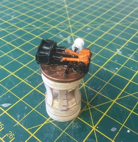

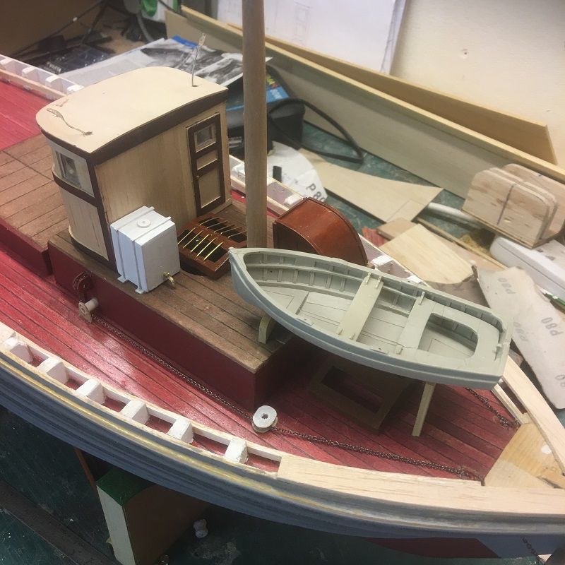

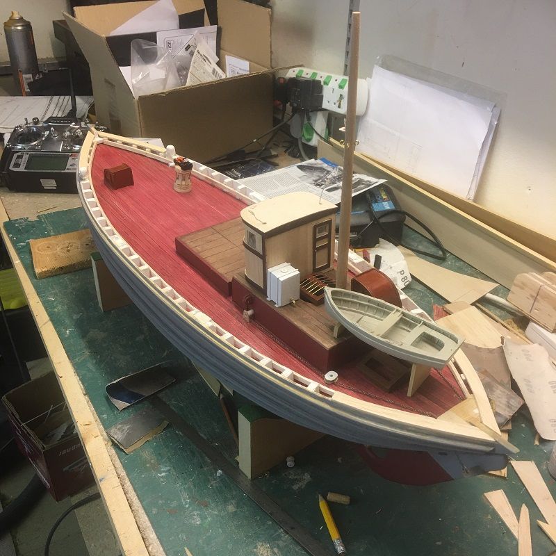

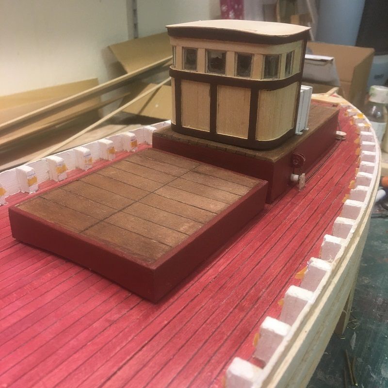

                                                  Hi. All, an update on my Zulu build, a few more bits and pieces have been added to the deck.
                                                  I am waiting for a delivery of paint and more fittings, the foremast and booms etc. will have to wait until I get home, I need access to my silver sodering equipment and brass sheet to make the tabernacle. but the boat is now ready to launch, the fish pond will have to do for now.
                                                  The rear deck and engine house is now in place along with the dinghy, although not painted yet, the fresh water tank is on, the companion way and the engine room roof light, there is a 2" speaker under this for a Componant shop engine sound unit.
                                                  The smallest non steam steam engine I have ever built, it sits on top of and drives the capstan and a warping drum, it is sitting on a 2 pence piece, not to be part of the capstan.
                                                  Regards to all.
                                                  Eddie.
                                                  #87261
                                                    Hi Eddie,
                                                    That's a great looking dinghy, and the tiny steam engine , but where would the boiler have been on the full-size vessel ?? Fishing boats are great because of all the sundry gear & bits & Bob's 😀
                                                    Edited By Ray Wood 2 on 28/04/2020 06:15:08
                                                    #87265
                                                      Eddie. WhatRay said.
                                                      The deck makes sense now the extra strips have been added!
