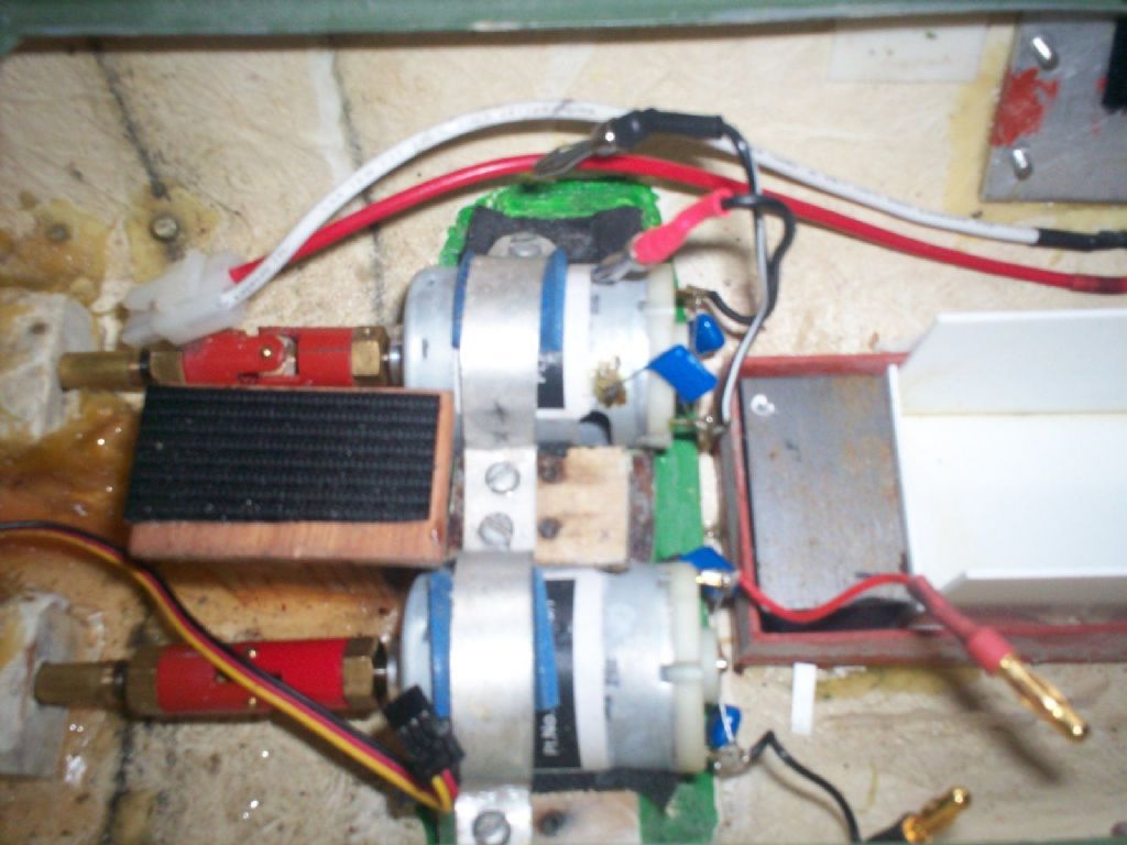

                      william omelasz
                        @williamomelasz10688
                        Hi Dave,
                        here,s a pic of the motors,..its not a great pic, but you might be able to recognize the motors…sentinel motors.jpg
                        #57278
                          William. They look like MFA 540, seeing the black label. They are rated to 15v, but are weedy motors.
                          This is a weight concious model. Brushless would be good, something to give, say 12,000 rpm, at 9.6v for good performance. However will need two speed controllers, so a bit fiddly.
                          OR…possibly a pair of J.Perkins speed 480 motors and new 30mm or 35mm props. these are rated at 9.6v and a feisty little motors. I would also get some new flexible couplings from Model Boat Bits to suit.
                          #57279
                            Got 'em. These are the ones **LINK**
                            They are rated up to 15v although I wouldn't run them at that sort of voltage. On 9.6v they will still be revving at 12600 no-load speed, which is too fast for the model and much too fast for the props. I would recommend changing to 35mm dia props at the very most, and probably reducing the voltage to 7.2v to obtain a more realistic speed.
                            BTW the wire leads look too thin for the currents involved. I'd recommend replacing all the power leads with 16AWG silicon-covered cable **LINK**
                            Have you any idea what the object between the two couplings is?

                            #57281
                              The Perkins 480 motors on 9.6v will be turning at 22000RPM no load. As J P McEnroe once said, you cannot be serious! With luck you'd just boil the lake away while the model sits in a froth of cavitation – until the bearings burned out. If you're unlucky the wiring would catch fire and destroy the model as well.
                              Sentinel is NOT a "performance" boat. The full-size spent most of her time in trolling gear or loitering on the waterjet at less than walking pace, tailing suspect yachts which were just over the horizon with her clever-clever electronics. Maximum speed was used only during short-dash intercepts within territorial waters; in transit from one mission to another, or back to Gosport if Chris Pratt, the captain, had promised to buy the drinks……. Top speed is still classified but I can reveal it wasn't much over 30 knots, and the hull is described only as "semi-planing" – whatever that means. For information my original Sentinel had 6mm less freeboard than the kit version and used one pack of six D-sized 9AH NiMH cells for everything. It was rock-solid in turns without working stabilizers.
                              As the designer of both kits I've always found it puzzling that folk will grossly overpower Sentinel and yet load down Huntsman with SLA batteries until it sails like a narrow-boat. Can anyone enlighten me?
                              #57283

                                william omelasz
                                  Hi Ashley & Dave,
                                  now that i,m more wiser than i was at the beginning,.some modification is needed,if i go with..e.g. a pair of 30/35 mm props,..what configuration should i go for…3 blade, D-Type..perhaps… or some other configuration….i,m new to all of this and your expert knowledge is most appreciated.
